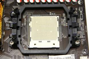

Asus M3A78-T CPU-Sockel

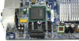

Intel GD45FC Southbridge
