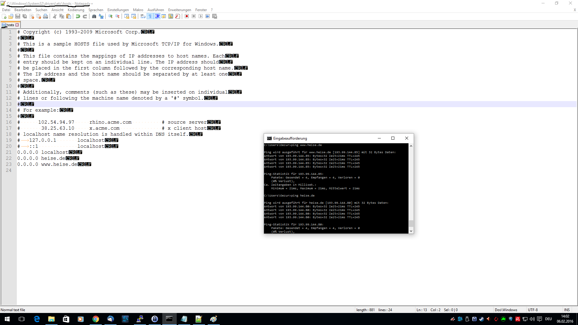

Gerne.
C:\Windows\System32\drivers\etc\hosts
# Copyright (c) 1993-2009 Microsoft Corp.
# This is a sample HOSTS file used by Microsoft TCP/IP for Windows.
# This file contains the mappings of IP addresses to host names. Each
# entry should be kept on an individual line. The IP address should
# be placed in the first column followed by the corresponding host name.
# The IP address and the host name should be separated by at least one
# space.
# Additionally, comments (such as these) may be inserted on individual
# lines or following the machine name denoted by a '#' symbol.
# For example:
# 102.54.94.97 rhino.acme.com # source server
# 38.25.63.10 x.acme.com # x client host
# localhost name resolution is handled within DNS itself.
# 127.0.0.1 localhost
# ::1 localhost
0.0.0.0 localhost
0.0.0.0 heise.de
0.0.0.0 www.heise.de
Hier noch gerne ein Bild

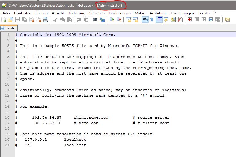

Notepad++ mit Admin-Rechten geöffnet? Bei mir sieht es dann so aus:
Stimmt in dem Moment war es nicht als Admin. Hab den Vorgang wiederholt und bei mir steht oben auch Administrator jedoch ohne Veränderung am Ergebnis.
