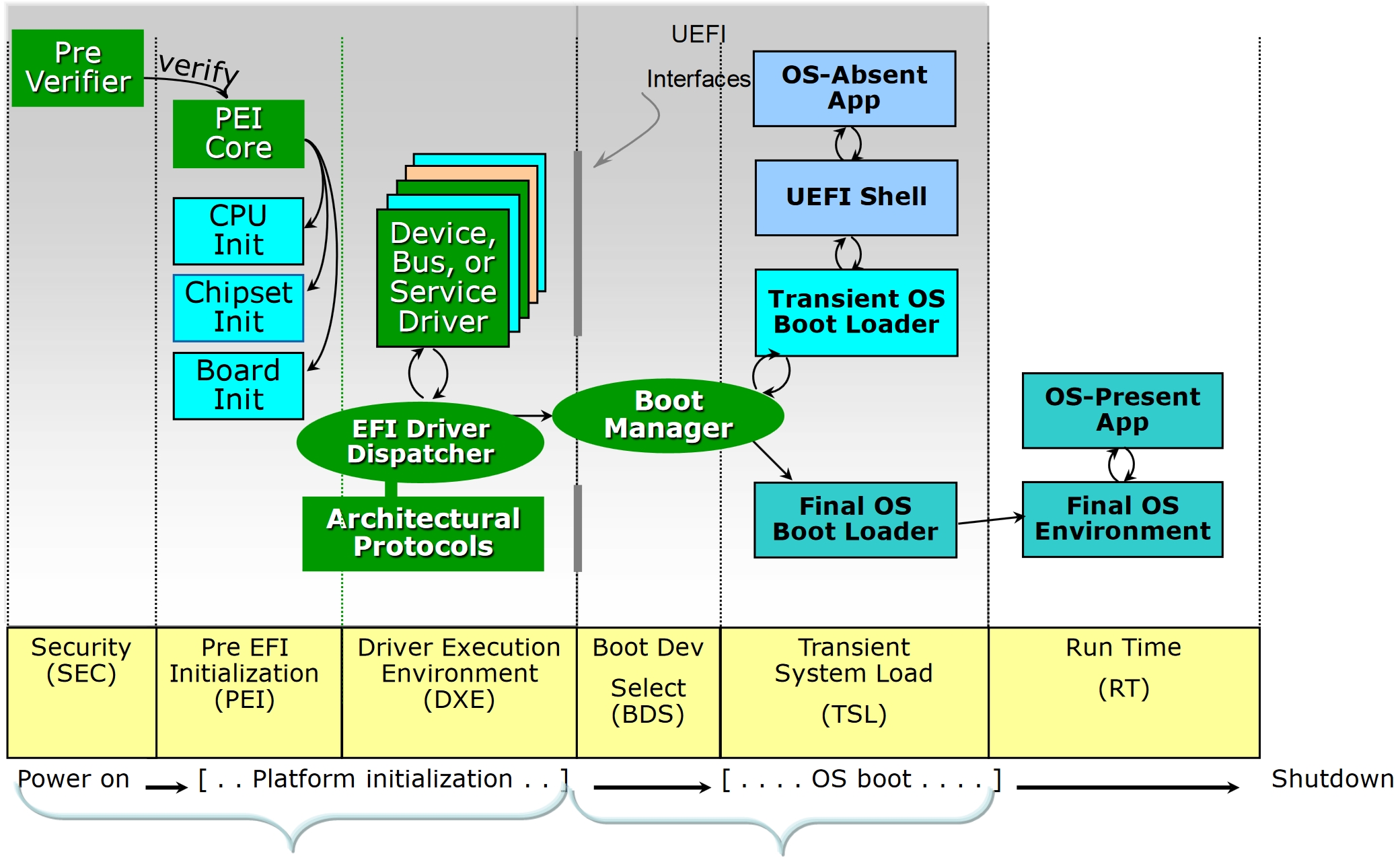

4 UEFI BIOS Initialization phases:
  • SEC (SECurity) phase: Pre-RAM code handles CPU initialization to create temporary stack in CPU cache.
  • PEI (Pre-EfI initialization) phase: finishes CPU initialization, discovers the DRAM, and determines boot mode (cold boot, S3, S4)
  • DXE (Driver eXecution Environment) phase. Loads drivers that initialize the rest of system hardware.
    The Driver Execution Environment (DXE) phase is where most of the system initialization is performed. Pre-EFI Initialization (PEI), the phase prior to DXE, is responsible for initializing permanent memory in the platform so that the DXE phase can be loaded and executed. The state of the system at the end of the PEI phase is passed to the DXE phase through a list of pos
    ition-independent data structures called Hand-Off Blocks (HOBs). HOBs are described in detail in the Intel® Platform Innovation Framework for EFI Hand-Off Block (HOB) Specification.
  • BDS (Boot Device Selection) phase. Finds boot devices, loads the OS, and passes control over to the OS.
