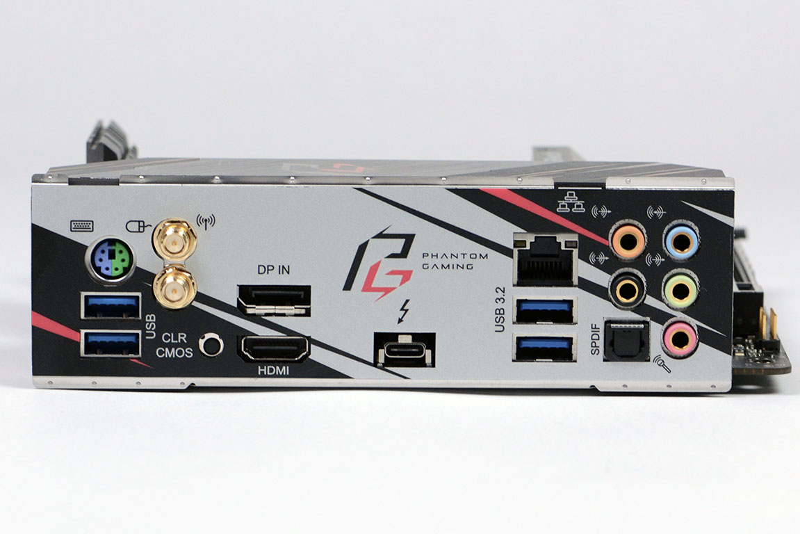

Das Mainboard X570 Phantom Gaming-ITX/TB3 hat
1 x USB 3.2 Gen2 Thunderbolt™ 3 Type-C Port (40Gb/s for Thunderbolt™ protocol; 10 Gb/s for USB3.2 protocol) (Supports ESD Protection)
ASRock X570 Phantom Gaming ITX/TB3 | TechPowerUp
The ASRock X570 Phantom Gaming ITX has a controversial rear I/O offering. At first glance, the back panel seems very sparse, especially when it comes to USB. ASRock did not have a lot of space to work with, and instead of compromising board performance to cram more USB into the design, ASRock integrated a Thunderbolt 3 controller into the USB Type-C port. While some may begrudge the need for a dongle to add USB ports, it is a sensible compromise that offers the end user more flexibility.
