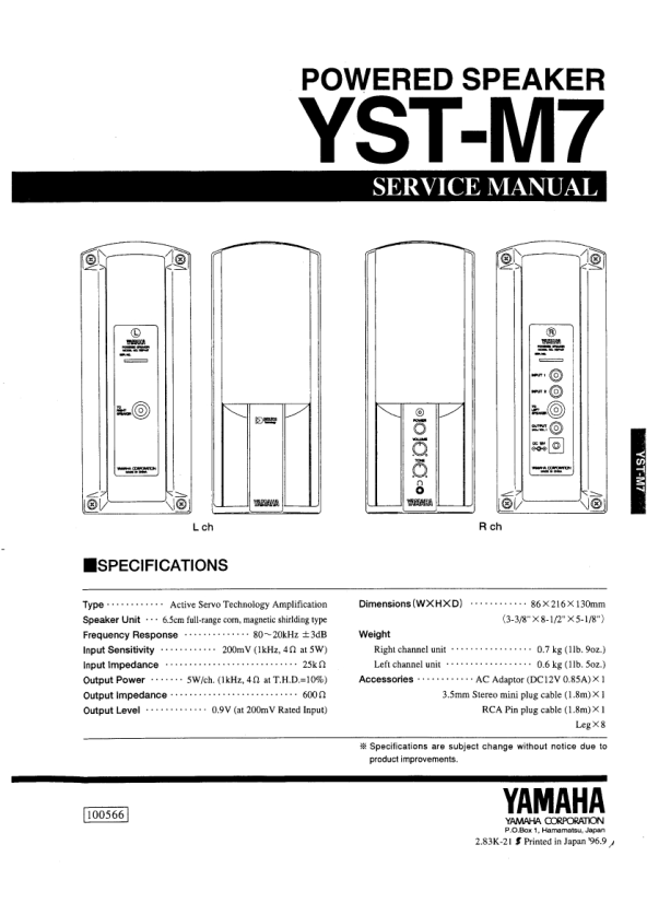

Yamaha YST-M7 lt. Google
Z4 lt. Google
Satellite RMS Power /ea8.5 watts RMS x 2 (into 4 ohms, @ 1khz, @ 10% THD)
