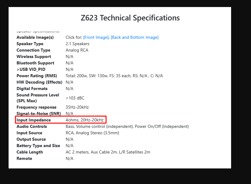

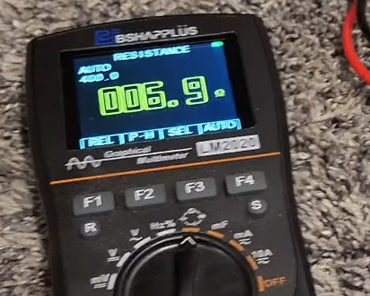

My old subwoofer speaker crashed and I need to find out how many ohms it had, then my multimeter doesn't show.just_f schrieb:I'm guessing you are trying to find a spare part? - then you should be able to obtain the imformation on the chassis which is already in place. Or i'm completely on se holzweg...
I was told in support that the impedance of the subwoofer and satellites is as follows:- Subwoofer: 4 Ohms- Satellites: 8 Ohms ,but the information on the Internet is different.just_f schrieb:@mafoe it's not - and most speakers are either 4 or 8 ohms.

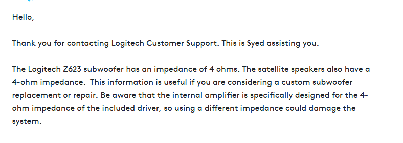

The support responded like this,but sambuffer is not listed there.
