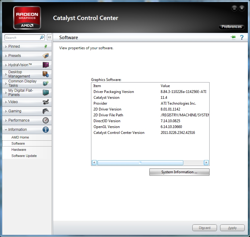

AW: [Sammelthread] ATI/AMD-Treiber -> Catalyst für WinXP/Vista/7
Zusammengefasst für den ATI Catalyst 11.4 [Early Review - Mjölnir I]
=> Download [Vista & 7]: *klick*
=> Mobile Driver [MOD]: *klick*
=> Build info:
8.84.3-110226a-114256E
DriverVer=02/26/2011
Changelog:
AMD Catalyst™ Driver 11.4 early Preview Features:
· Delivers performance enhancements for the AMD Radeon™ HD 6000 Series & Windows 7.
· Includes enhancements to the AMD Catalyst Control Center™
o New task based Display Management controls
§ Simplifies the configuration of displays and display settings
o New Eyefinity setup group
§ Setting up an Eyefinity group has never been easier
o New branding (based on system configuration)
§ AMD based platform – AMD VISION Engine Control Center
§ Discrete AMD GPU with Intel CPU – AMD Catalyst Control Center™
o AMD Catalyst update notification (found within the Information Center)
§ Please note this functionality is not yet enabled, but will be in a future AMD Catalyst release
§ This feature will be used to notify users that new AMD Catalyst software packages are available
· Fixed cases where Dragon Age 2 would hang in DirectX11 on ATI Radeon™ HD 5800 Series products.
Users should see a boost, particularly with anti-aliasing and large resolutions in numerous titles:
* Up to 70% performance improvement in Civilization V
* Up to 49% performance improvement in Call of Duty: Black Ops
* Up to 23% performance improvement in F1 2010
* Up to 21% performance improvement in Wolfenstein MP
* Up to 15% performance improvement in Tom Clancy’s H.A.W.X
* Up to 17% performance improvement in S.T.A.L.K.E.R.: Call of Pripyat
* Up to 28% performance improvement in Metro2033
* Up to 33% performance improvement in Left 4 Dead 2
* Up to 26% performance improvement in FarCry 2
* Up to 15% performance improvement in Crysis Warhead
* Up to 50% performance improvement in Unigine Heaven
* Up to 22% performance improvement in Batman: Arkham Asylum
* Up to 19% performance improvement in Aliens vs. Predator

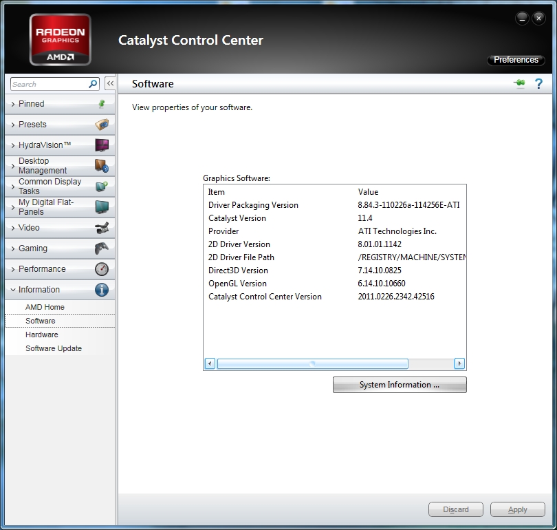

GaBBa-Gandalf schrieb:
Zusammengefasst für den ATI Catalyst 11.4 [Early Review]
Dieser Treiber ist nur für Windows 7 - 32 Bit und 64 Bit vom Hersteller ausgeschrieben:
amd-catalyst-11-4-early-preview-png.224455
