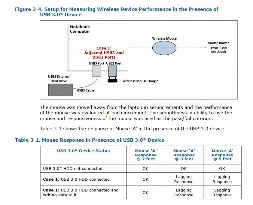

Ist ein bekanntes Problem von USB 3.0 Ports. Lesen:
https://www.usb.org/sites/default/files/327216.pdf
"As shown in Table 3-1, there is degradation in the performance of the wireless mouse
when a USB 3.0 device is connected to the notebook computer. At a distance of 3 feet
and greater away from the notebook computer, a significant lag was experienced in
the response of the mouse. The impact to mouse performance was found to be the
same whether the USB 3.0 peripheral device had data being actively written to it or if
it was merely connected to the notebook computer and the link to it established.
A similar impact to wireless mouse performance was noted if a USB 3.0 device, such
as a flash drive, was used. Since the noise from the USB 3.0 is broadband, it could
potentially impact any radio whose antenna is close by. Although the test results are
not shown in this paper, similar impact was seen to Bluetooth radio performance."
Mitigation Methods
There are several areas where improvements can be made to minimize the impact of
USB 3.0 noise on wireless device performance. Three areas where improvements can
be made are:
• Shielding on the USB 3.0 peripheral device
• Shielding improvements on the USB 3.0 receptacle connector on the notebook
• Wireless antenna placement, wireless receiver performance
Each of these areas are studied in further detail in the following sections.
Kurzfassung: Die meisten USB 3.0 Ports "funken" auf der selben 2.4GHz Frequenz wie die meisten Funkmaus dongles und stören diese, sowohl BT als auch Wifi. Der USB 3.0 Port am PC fungiert wie eine Funkantenne und kann auch andere Sachen stören wie Wifi und BT. Ist in dem PDF oben alles erklärt. Wissen die wenigsten. Einige Geräte senden diese Störsignale mehr aus als andere, kommt vom USB 3.0 bus.
Lösung: Die Lösung ist recht einfach. Kurzes gut geschiermtes USB 3.0 Verlängerungskabel nutzen, max 1m vom PC zum Schreibtisch oben, und dort die kritischen Sachen wie Funkmausdongle anschließen. Für Maus Dongle reicht auch ein USB 2.0 Kabel.
