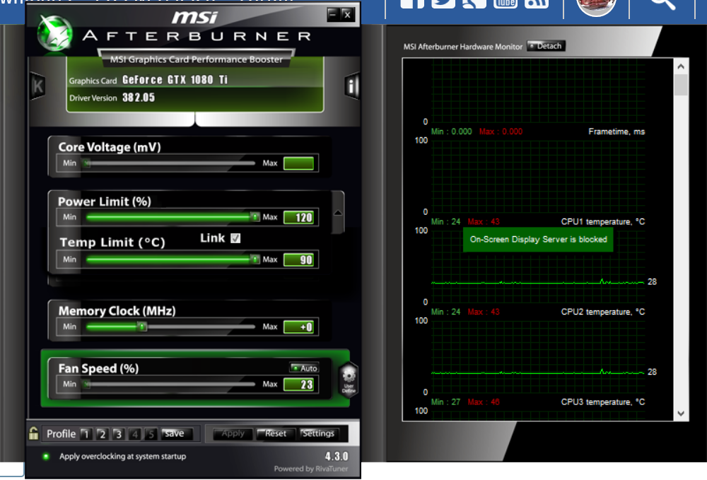

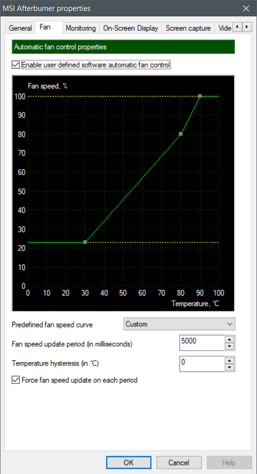

Hi
you should use Msi Afterburner and set it up like this:
Your card will be louder and run cooler. You could certainly tweak the fan curve to your liking, for even more noise, or less.
Using these settings, my card runs at ~1860 Mhz @ max. 76°C, over 70% fan speed. But still, my AC unit is a lot louder ;)
