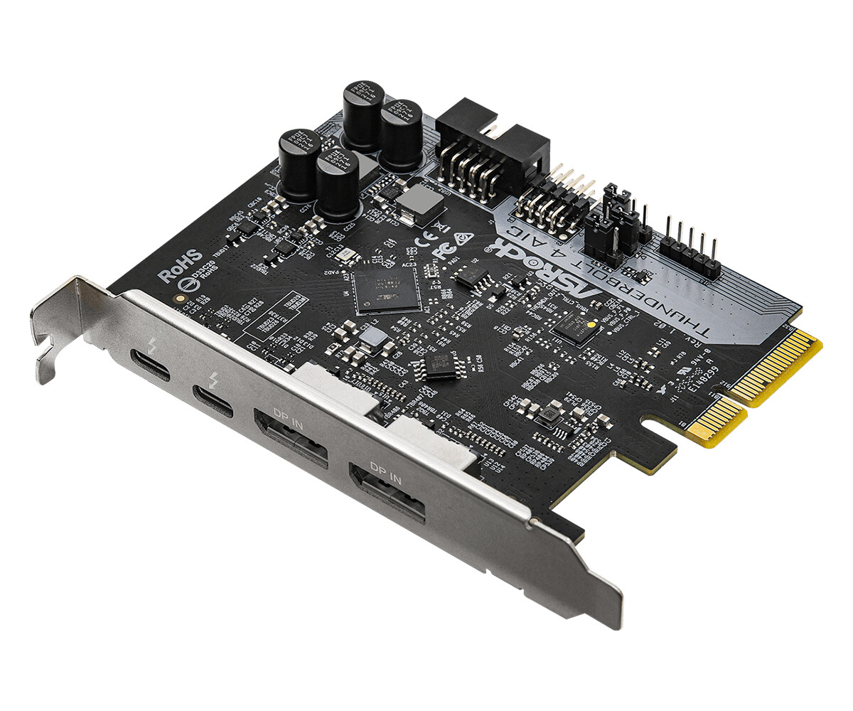

ASRock Unveils Thunderbolt 4 Add-on Card​
https://www.techpowerup.com/281480/asrock-unveils-thunderbolt-4-add-on-card
