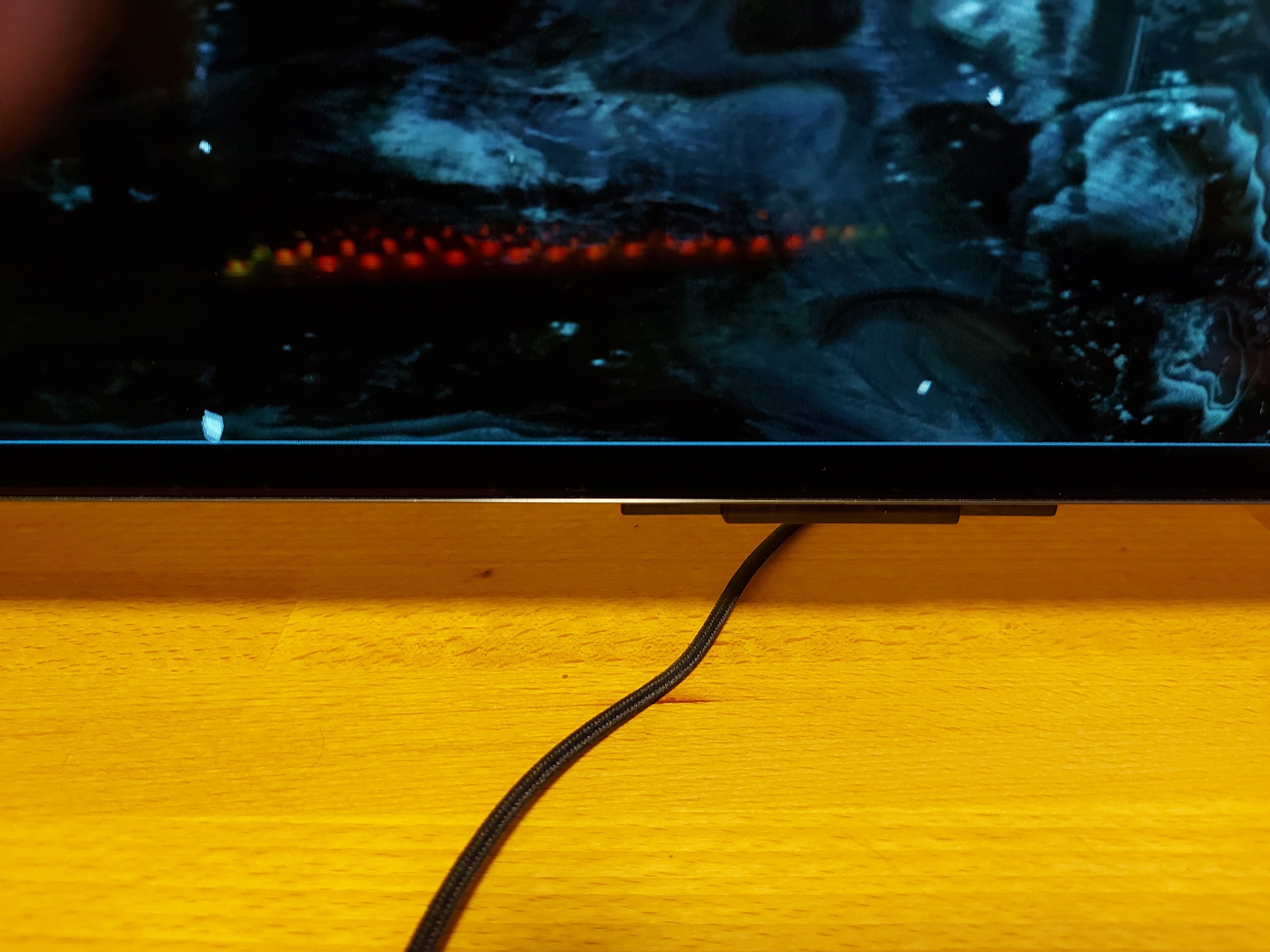

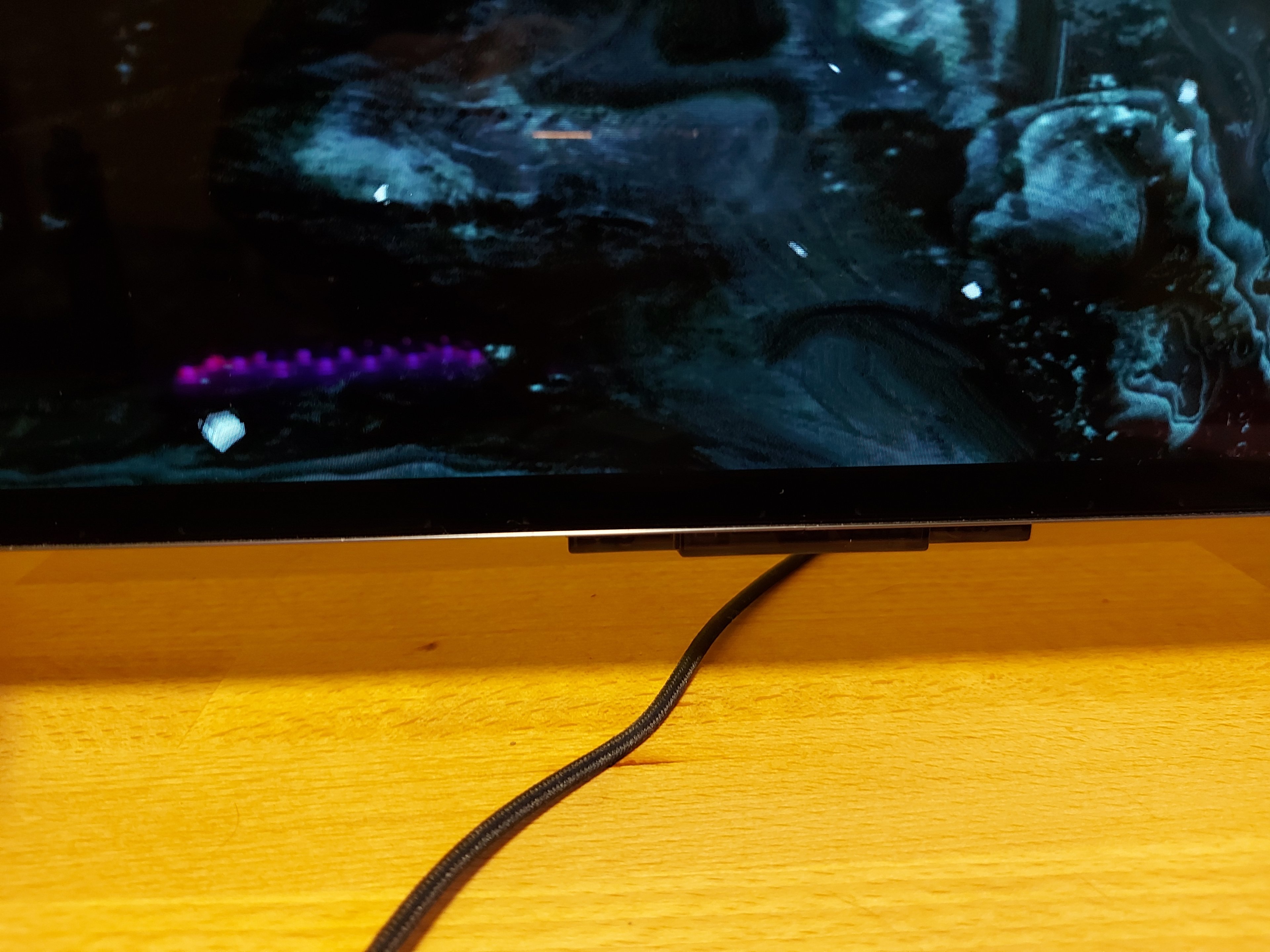

Bild 1 ist das nicht,Bild 2 aber schon....

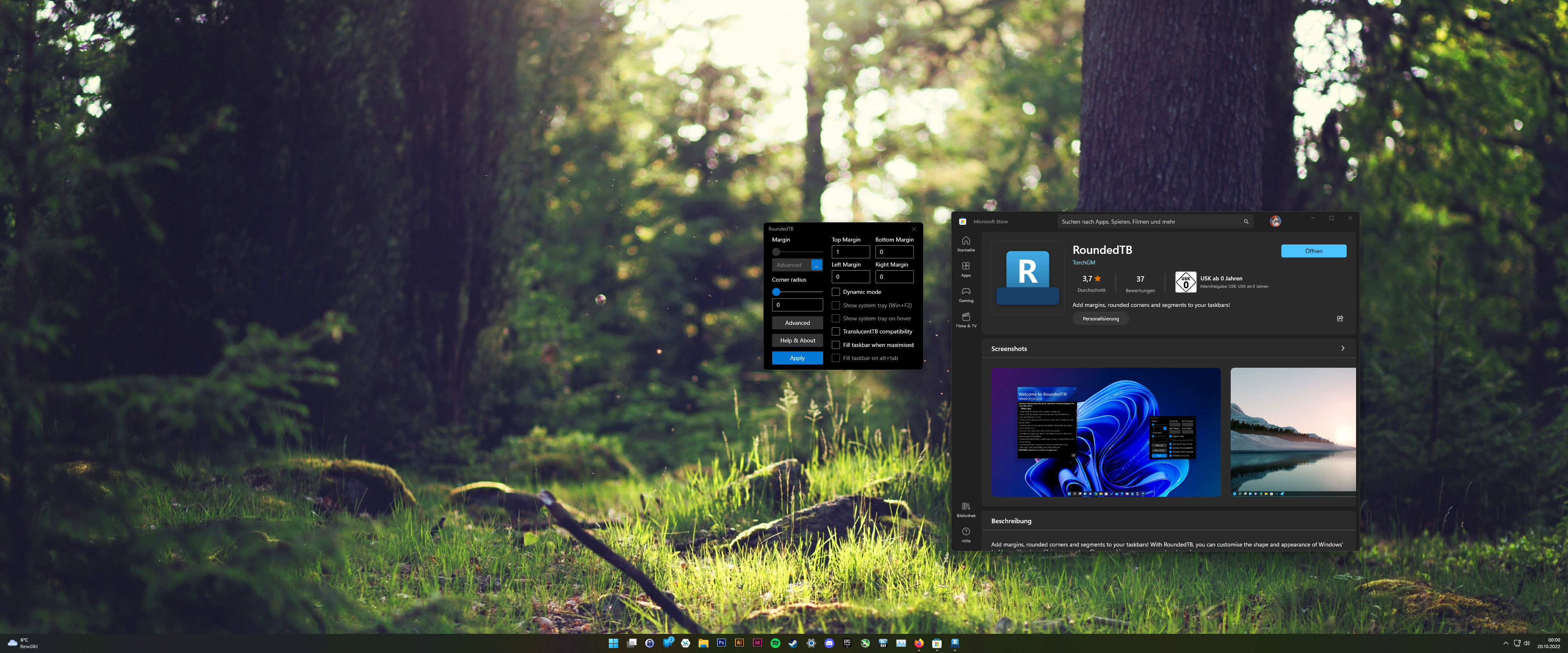

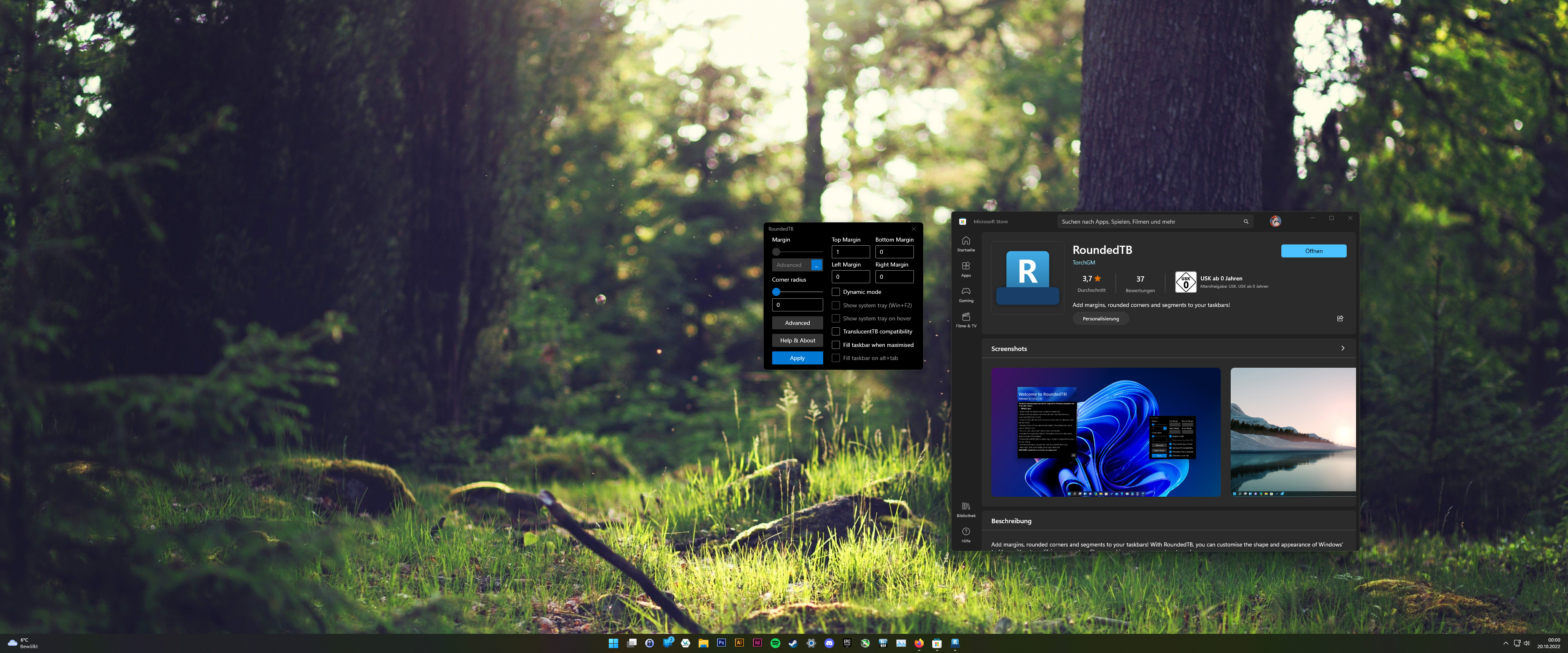

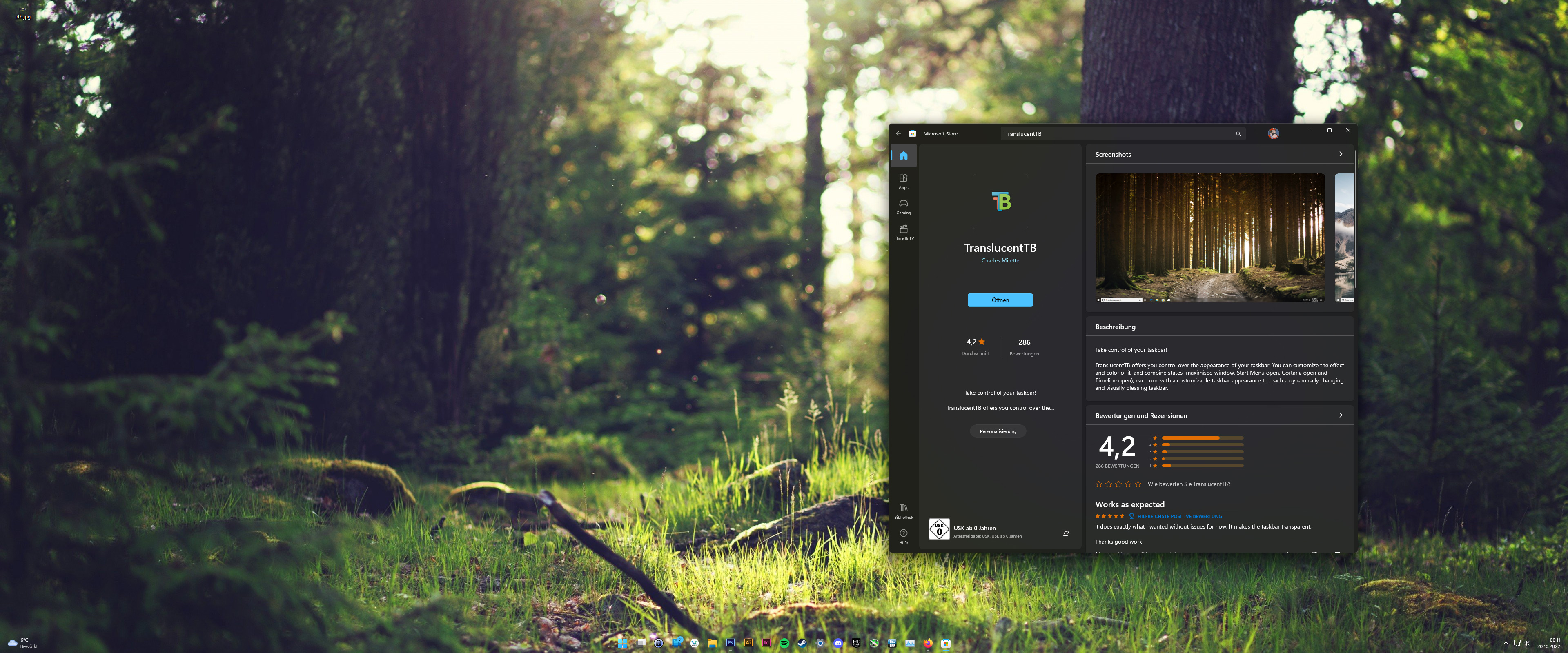

RoundedTB
Top Margin 1, sonst 0, Corner radius 0
This is the way. Many thanks for figuring this one out! I suggest using the Advanced settings and use either 1 or 2 for the Top Margin (depending on if you are using two screens - I had to use 2 to make this work on both my screens), 0 Bottom Margin, 1 for the Left Margin and 0 for the Right Margin. Corner radius to 0 as you suggested! This allows you to use the show desktop button, and making it still be on the very bottom right of the screen, if you have that already set up.
Using the none Advanced setting and setting to Margins 1 or 2 made my show desktop button shift away from the far right making me miss it when I scroll my mouse to the very bottom right corner.
Thanks again for pointing out RoundedTB
edit:

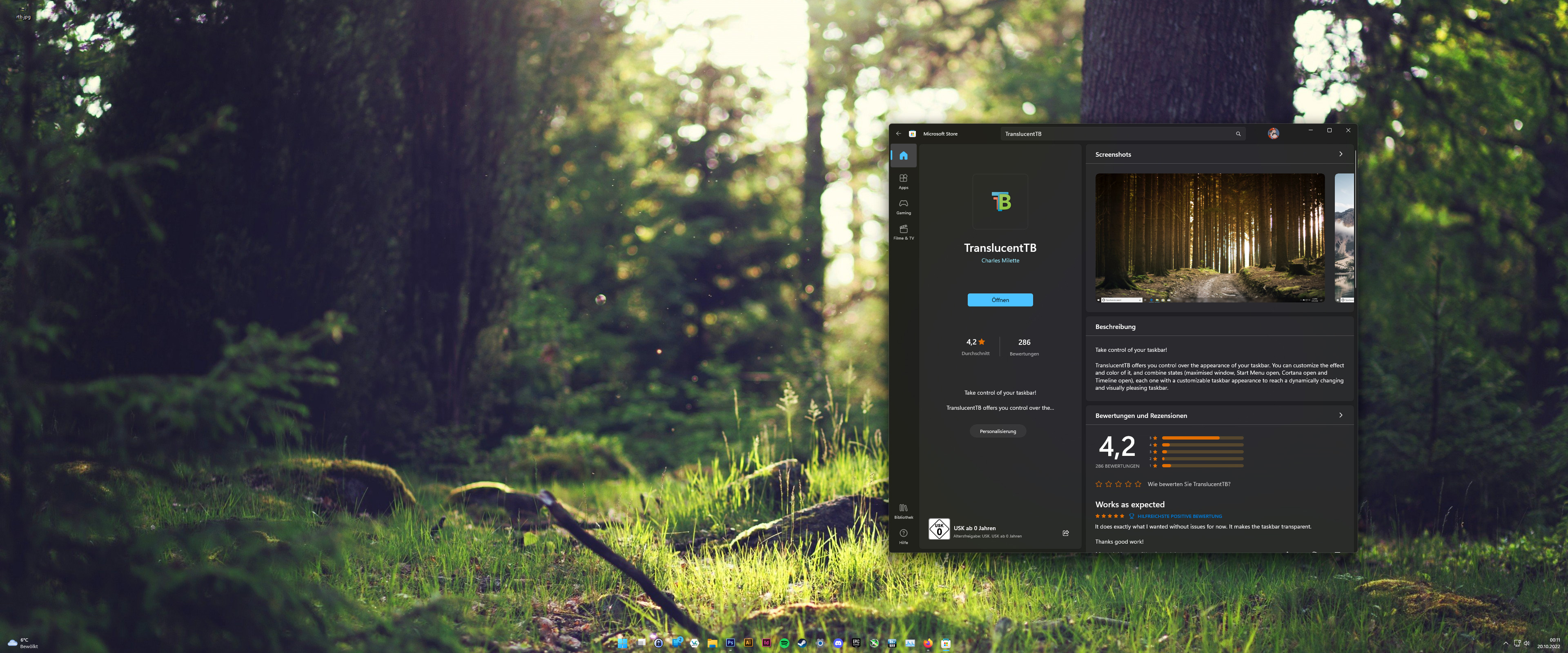

zusammen mit TranslucentTB sieht es dann so aus xD
