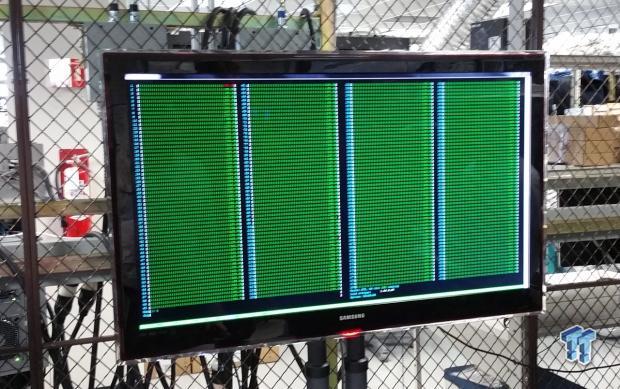

When you do the math, that’s 60 cores per chip (Intel is promising more than this), with four-way hyperthreading. Although the appearance of the sled server’s heat sink can fool you, that’s just one big chip under there — the largest die that Intel has ever produced for a CPU.
As Knights Landing chief architect Avinash Sodani confirmed, all threads were being run on a single image of a single physical (non-virtual) operating system. Had this image been Windows, said Sodani, the operating system would already have been able to manage all 240 threads just as evenly, without extensions to the operating system.
This means, with Knights Landing, there won’t be a “main core” backed up by 60 or more subsidiaries which the operating system activates when it gets around to it. “It’ll look like everyone is at the same level,” he said. “There’s no master/slave kind of relationship.”
