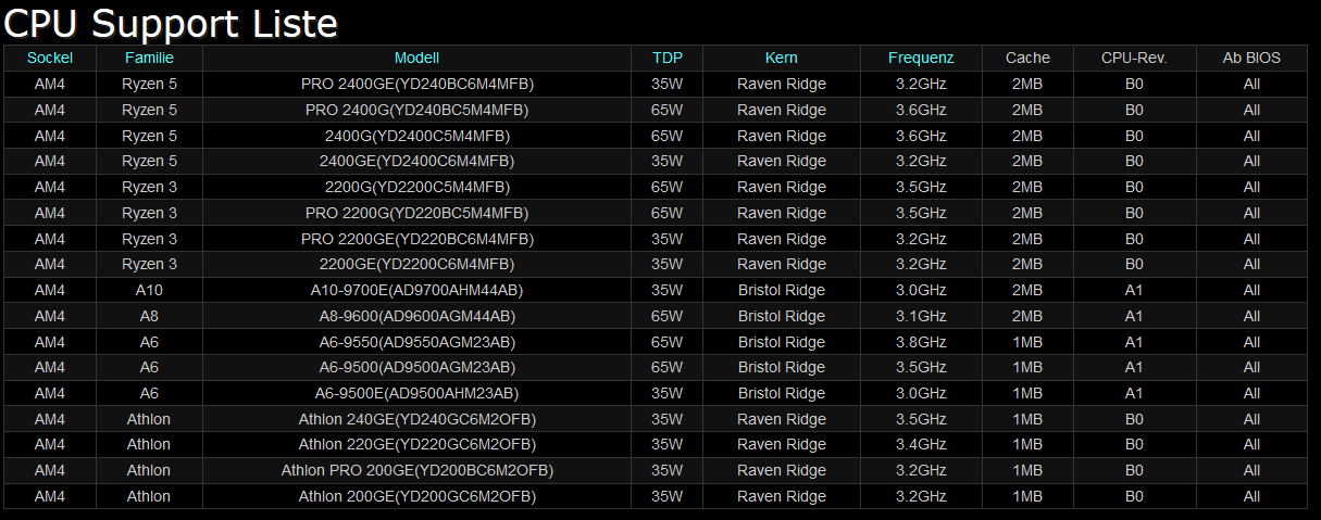

Laut ASRock wird der 9700E seit Release unterstützt.
Angeschlossen ist der Rechner via HDMI.

Support hat schon letzte Woche geantwortet. Antwort im Wortlaut:
"Hello,
are you able to test the 970ß0E on another mainboard?
Maybe the CPU itself is faulty?
This CPU is supported since first BIOS version.
https://asrock.com/nettop/AMD/DeskMini A300 Series/index.asp#CPU
Another CPU is working well in our Deskmini. It seems like more a problem with the 89700E CPU...
Best regards,
ASRock Support"
