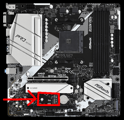

Please can somebody help me: I built a pc and bought a wifi adapter ax210 but it did not get recognized by my pc only Bluetooth works but not internet (lan works). I thought maby the chip is broken so I bought the ax200 and the same problem accrued. I tried installing drivers from intels website and from the drivers disk for the motherboard. I updated the bios (uefi) to the best version and nothing worked. Please help
Yea I installed the hardware into my motherboard and it only shows Bluetooth. I tried installing the drivers but it still didn’t work
They are installed properly (the foto is from 1 hour ago ) the antennas are both with the little connectors connected with the card
