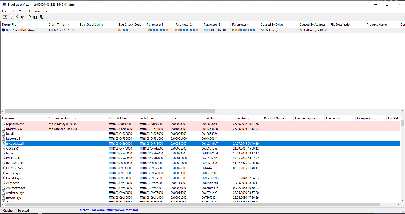

BlueScreenView von NirSoft > https://www.nirsoft.net/utils/blue_screen_view.html

CLOCK_WATCHDOG_TIMEOUT (101)
An expected clock interrupt was not received on a secondary processor in an
MP system within the allocated interval. This indicates that the specified
processor is hung and not processing interrupts.
SYMBOL_NAME: nt!KeAccumulateTicks+211a7a
MODULE_NAME: nt
IMAGE_NAME: ntkrnlmp.exe
IMAGE_VERSION: 10.0.22621.1778
STACK_COMMAND: .cxr; .ecxr ; kb
BUCKET_ID_FUNC_OFFSET: 211a7a
FAILURE_BUCKET_ID: CLOCK_WATCHDOG_TIMEOUT_INVALID_CONTEXT_nt!KeAccumulateTicks
OSPLATFORM_TYPE: x64
OSNAME: Windows 10
Es gibt eine Ansamlung von Tiks. Der Prozessor bleibt hängen.

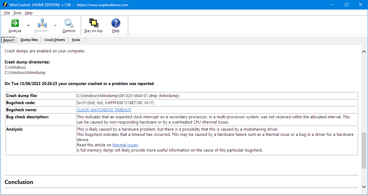

Analyse:
Überhitzung!
