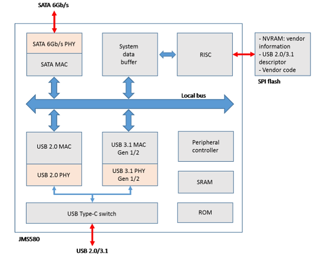

USB - SATA-USB Bridge Controller-Products | JMicron
JMS580
  • USB 3.2 Gen 2 to SATA 6Gb/s
  • Support external USB Type-C PD controller
  • Support TRIM command for SSD and comply with BOT/UASP specification
JMS580 Block Diagram
Alternate 2
