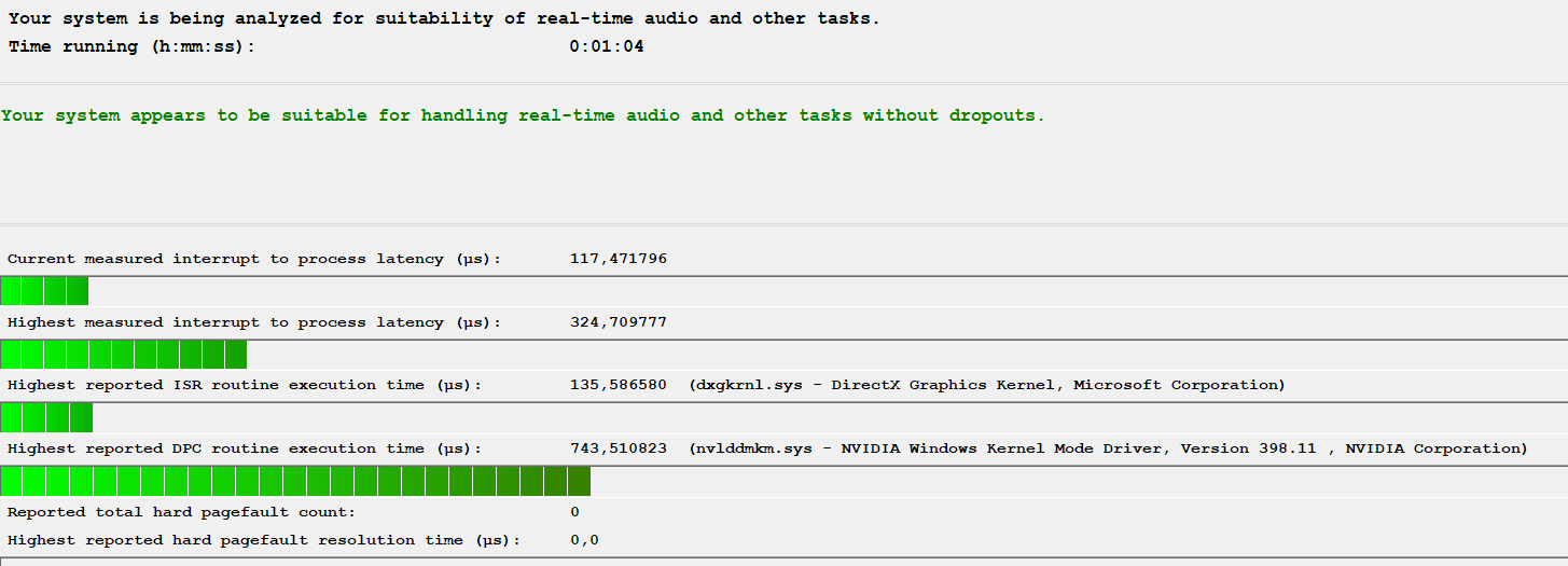

Teste mal auf Probleme mit der DPC Latency mit LatencyMon
http://www.resplendence.com/latencymon
Klingt nach einem Problem mit irgendeinem Treiber, muss nicht der Soundtreiber sein, kann auch der Lan- oder Grafiktreiber usw. sein.

Hier noch der Bericht:
_________________________________________________________________________________________________________
CONCLUSION
Your system appears to be suitable for handling real-time audio and other tasks without dropouts.
LatencyMon has been analyzing your system for 0:02:00 (h:mm:ss) on all processors.

MEASURED INTERRUPT TO USER PROCESS LATENCIES
The interrupt to process latency reflects the measured interval that a usermode process needed to respond to a hardware request from the moment the interrupt service routine started execution. This includes the scheduling and execution of a DPC routine, the signaling of an event and the waking up of a usermode thread from an idle wait state in response to that event.
Highest measured interrupt to process latency (µs): 324,709777
Average measured interrupt to process latency (µs): 9,598771
Highest measured interrupt to DPC latency (µs): 314,735756
Average measured interrupt to DPC latency (µs): 5,367715

REPORTED ISRs
Interrupt service routines are routines installed by the OS and device drivers that execute in response to a hardware interrupt signal.
Highest ISR routine execution time (µs): 135,586580
Driver with highest ISR routine execution time: dxgkrnl.sys - DirectX Graphics Kernel, Microsoft Corporation
Highest reported total ISR routine time (%): 0,103662
Driver with highest ISR total time: dxgkrnl.sys - DirectX Graphics Kernel, Microsoft Corporation
Total time spent in ISRs (%) 0,117456

REPORTED DPCs
DPC routines are part of the interrupt servicing dispatch mechanism and disable the possibility for a process to utilize the CPU while it is interrupted until the DPC has finished execution.
Highest DPC routine execution time (µs): 743,510823
Driver with highest DPC routine execution time: nvlddmkm.sys - NVIDIA Windows Kernel Mode Driver, Version 398.11 , NVIDIA Corporation
Highest reported total DPC routine time (%): 0,066397
Driver with highest DPC total execution time: nvlddmkm.sys - NVIDIA Windows Kernel Mode Driver, Version 398.11 , NVIDIA Corporation
Total time spent in DPCs (%) 0,146802

CPU 9 ISR count: 30065
CPU 9 DPC highest execution time (µs): 83,311147
CPU 9 DPC total execution time (s): 0,010901
CPU 9 DPC count: 2335
CPU 10 Interrupt cycle time (s): 0,793708
CPU 10 ISR highest execution time (µs): 3,787879
CPU 10 ISR total execution time (s): 0,000075
CPU 10 ISR count: 65
CPU 10 DPC highest execution time (µs): 64,874459
CPU 10 DPC total execution time (s): 0,027038
CPU 10 DPC count: 5468
CPU 11 Interrupt cycle time (s): 0,753478
CPU 11 ISR highest execution time (µs): 10,088203
CPU 11 ISR total execution time (s): 0,001845
CPU 11 ISR count: 2053
CPU 11 DPC highest execution time (µs): 54,924784
CPU 11 DPC total execution time (s): 0,013452
CPU 11 DPC count: 2626
Computer\HKEY_LOCAL_MACHINE\SYSTEM\ControlSet001\Control\Session Manager\Memory Management

Hat nichts gebracht..
Mal eine andere Soundkarte Probieren. An der DPC Latency oder Treiberproblemen liegt es nicht.
Ich habe ja aber schon das Mainboard gewechselt... und das habe ich vergessen, ich hatte die SoundblasterX AE-5 mal am alten Mainboard verbaut, ja das knacken war weg, aber dafür die Mikrofon Qualität so grausam schlecht, keiner hat mich verstanden in Discord, hab alle settings probiert... Deshalb ist das nicht die Lösung meines Problems. Beispill mein Bruder, gleicher PC gleiches Headset, kein knacken...
Das ist normale das bei internen Sokas die mic QUalität oft scheiße mist. Nimm eine USB Soka dafür:
https://www.amazon.de/UGREEN-Soundk...qid=1528747835&sr=8-5&keywords=usb+soundkarte
Denke mal deine Onboard Soundlösung ist einfach teildefekt (Kondensator hinüber oder so).
Also gleich an 2 neuen Mainboards verschiedener Varianten ist die onboard Karte defekt?.. Naja.
Dieses USB Teil worüber bezieht es denn die Einstellungen vom Sound? Wenn es Plug&Play sein soll? Weiterhin HD Audio oder?
Wäre halt gut wenn das Problem richtig gelöst werden könnte ohne auf andere Zusatzhardware zu springen.
Achso sry, da hab ich dich falsch verstanden, würde es trotzdem mit anderer Hardware probieren. USB Soka für 9 € bestellen und testen. Evtl. hast du auch einfach Probleme mit Interferenzen. Die lassen sich mit einer USB Lösung meist lösen.
Ja aber USB ist ja dann nicht mehr die Onboard Soundkarte? Somit also wieder andere Qualität? Bin ja extra von USB Headsets weg... So könnte ich gleich wieder das G933 auspacken.
Wenn davon noch einen USB Dongle hast probier den. Geht der weißt bescheid. USB Soundkarten allgemein sind übrigens nicht schlecht, musst ja kein USB Headset nutzen.
Nicht selten sind USB Lösungen eher noch besser als Interne weil weniger Anfällig für elektrische Störungen.
Kannst du mir dann noch sagen über welche Software/Treiber diese USB Karte von Amazon betrieben wird?
Danke
