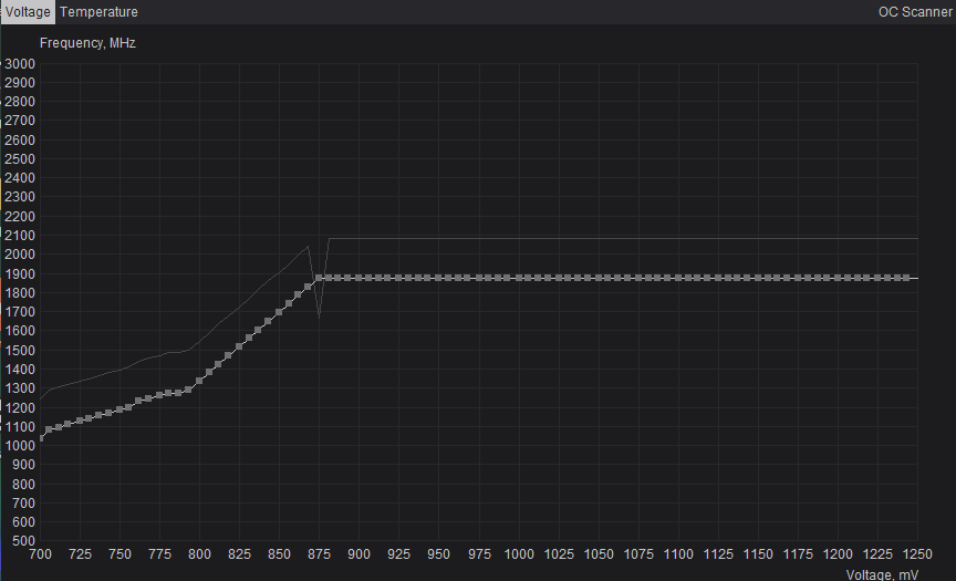

I was undervolting my GPU the card was running stable at my tested benchmarks and games. But all time when i play Battlefield 2042 are my clock speeds like 15-30 mhz lower or higher this settings will applied in Afterburner after a system restart. I think its a NVDIA AI they are changing my settings but why only in Battlefield and when its changed are clock speeds on the curve still changing. My undervolt profile was 875 mV voltage at a clock from 1875 MHz my card is an rtx 2060. If anyone knows how i can fix that or something pls send me an reply. Thank`s for reading i hope there exists any fix for that cause my GPU isnt run stable when the clock gets changed. Another weird thing is when the clock getting lower is it also unstable but when i set manually a lower clock is it stable.
My gpu clock on my voltage curve in Afterburner getting changed pls Help

Can't answer as to why but some slight clock deviations are normal. Though it doesn't impact stability so I would just assume your settings need some tweaking.
Im not sure that its unstable cause when i play some games is all working good and when i let unigine heaven running for hours is it stable. But when i test the superposition benchmark is it sometimes crashing and sometimes working good. But it was before without any setting also crashing so i think its a software problem.

What about gaming? No single software can guarantee absolute stability.

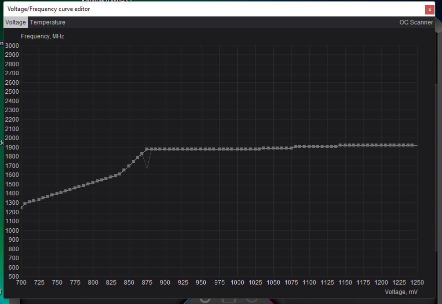

Looking at your curve again it might not be setup entirely correctly depending on what you want to achieve.
Mine is flat starting from my clock/voltage target. There's a certain voltage cutoff where it stops mattering but yours is going up slightly before that I believe.

No! Just play games and if you start crashing increase voltage/lower clocks.
