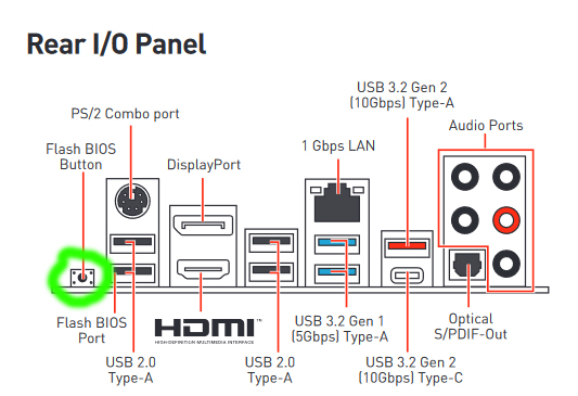

Ich weiß nicht ob mein Board so einen Knopf für das flashback hat oder geht das auch ohne ?
Ja, direkt auf dem Board
Das Board hat so einen Knopf, am I/O-Panel hinten.
Reaktionen: Klebonator
Updating BIOS with Flash BIOS Button
1. Please download the latest BIOS file that matches your motherboard model from the MSI® website.
2. Rename the BIOS file to MSI.ROM, and save it to the root of your USB flash drive.
3. Connect the power supply to CPU_PWR1 and ATX_PWR1. (No need to install CPU and memory.)
4. Plug the USB flash drive that contains the MSI.ROM file into the Flash BIOS Port on the rear I/O panel.
5. Press the Flash BIOS Button to flash BIOS, and the LED starts flashing.
6. The LED will be turned off when the process is completed.
