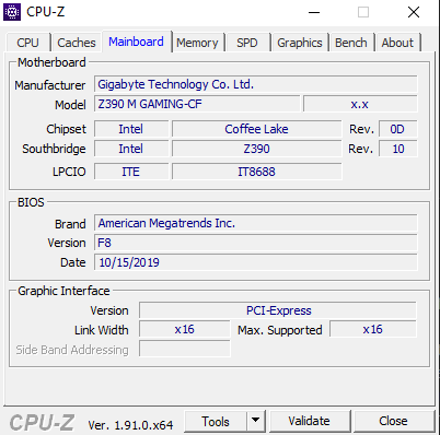

Mein Setup:
MB: Z390 M Gaming
CPU: Intel i7 9700KF
GK: MSI GeForce RTX 2070 Super
SSD: Corsair Force MP510 960GB M.2
RAM: Corsair Vengeance LPX 2x 8GB
Netzteil: beQuiet StraightPower 11 750Watt
Case: beQuiet Pure Base 500
