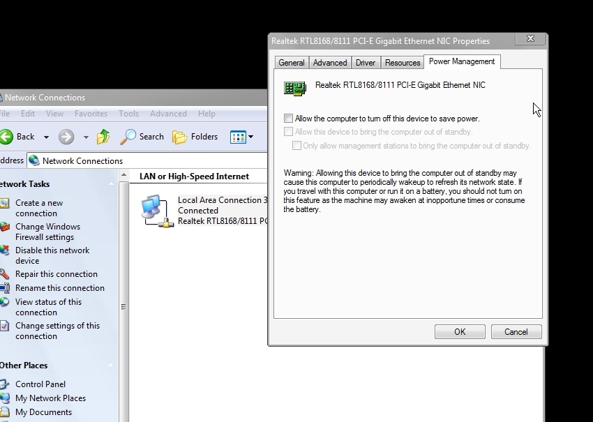

da hatte ich das hier doch vorhin gefunden:
And just for "out of left field" answers make sure the Windows Power Scheme is set to never power down the Network Controller device.
Quote:
1. Open Network Connections by clicking the Start button, and then clicking Control Panel. In the search box, type adapter, and then, under Network and Sharing Center, click View network connections.
2. Right-click the connection, and then click Properties. If you're prompted for an administrator password or confirmation, type the password or provide confirmation.
3. Click the Networking tab, and then click Configure.
4. Click the Power Management tab, clear the Allow the computer to turn off this device to save power check box, and then click OK.
sprich mal gucken obs auch in win aus ist.
