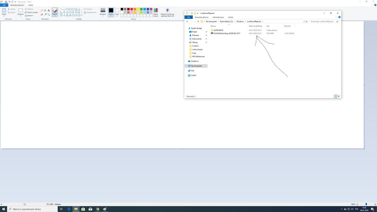

I found this in windows/livekernelreports/ pow32kwatchdog.dmp
File appeared 5 minutes before reboot. And my question is. It was that file related to that reboot or bsod ?
But like i said that reboot was so quick that i even dont saw blue screen on a display. Just simply reboot.

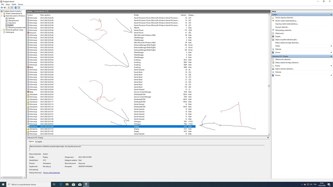

I get BLACK SCREEN and no monitor signal for 1 minute, and crash to desktop with TDR driver crash in event log. After that i log off from system and log back in again and system rebooted unexpected.
Just after crash to desktop pc get rebooted after i log off from system ( and back in ) by CTRL ALT DELETE.
Maybe something messed up during logging off and back on again.
There was not bugcheck in event log. Only Kernel 41 power.
And file appeared C:/Windows/livekernelreports/pow32kwatchdog.dmp
1 arrow: 3 driver crashes from a game with black screen,CTD,turning circle instead of arrow
2 arrow:winlogon, i decide to ctrl alt delete , log out and log back again in
3 arrow: kernel 41 power and weird reboot
