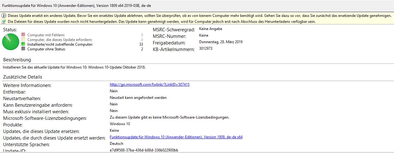

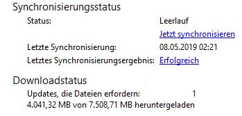

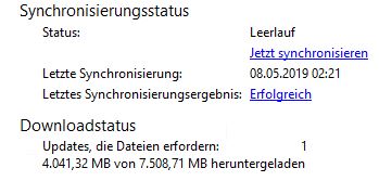

ich habe auf einem Windows Server 2012 R2 mit allen aktuellen Updates das Problem, dass mir der WSUS keine Feature Upgrades herunterladen kann.
Diese bleiben immer in seiner Downloadwarteschlange hängen und zwar fehlerhaft.

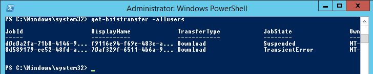

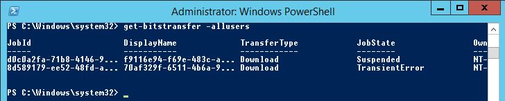

PS C:\Windows\system32> get-bitstransfer -allusers
JobId                   DisplayName             TransferType            JobState                OwnerAccount
d0c0a2fa-71b8-4146-9... f9116e94-f69e-483c-a... Download                Suspended               NT-AUTORITÄT\Netzwer...
311b01be-d279-4917-8... f3f159be-52de-48a4-b... Download                TransientError          NT-AUTORITÄT\Netzwer...
e384490f-5251-4051-9... fe0a9c07-5356-4a2c-a... Download                TransientError          NT-AUTORITÄT\Netzwer...
5a2413d6-f369-47a6-8... 70af329f-6511-4b6a-9... Download                TransientError          NT-AUTORITÄT\Netzwer...

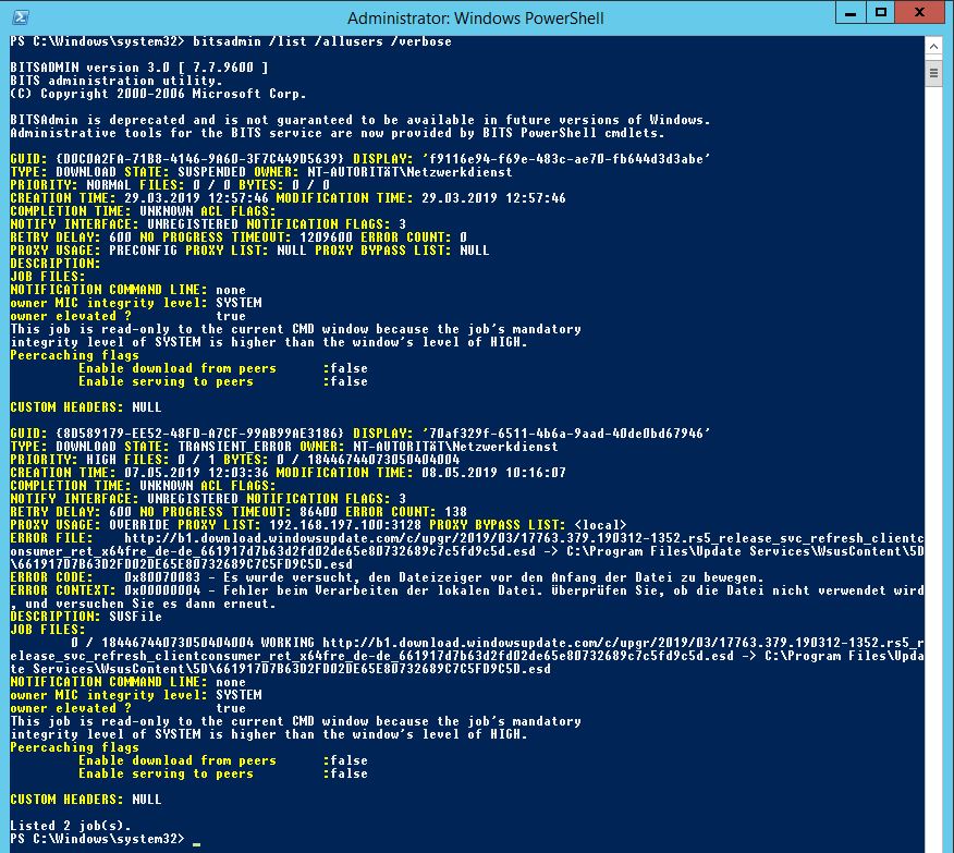

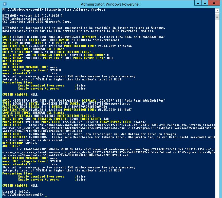

Code:
PS C:\Windows\system32> bitsadmin /list /allusers /verbose
BITSADMIN version 3.0 [ 7.7.9600 ]
BITS administration utility.
(C) Copyright 2000-2006 Microsoft Corp.
BITSAdmin is deprecated and is not guaranteed to be available in future versions of Windows.
Administrative tools for the BITS service are now provided by BITS PowerShell cmdlets.
GUID: {D0C0A2FA-71B8-4146-9A60-3F7C449D5639} DISPLAY: 'f9116e94-f69e-483c-ae70-fb644d3d3abe'
TYPE: DOWNLOAD STATE: SUSPENDED OWNER: NT-AUTORITÄT\Netzwerkdienst
PRIORITY: NORMAL FILES: 0 / 0 BYTES: 0 / 0
CREATION TIME: 29.03.2019 12:57:46 MODIFICATION TIME: 29.03.2019 12:57:46
COMPLETION TIME: UNKNOWN ACL FLAGS:
NOTIFY INTERFACE: UNREGISTERED NOTIFICATION FLAGS: 3
RETRY DELAY: 600 NO PROGRESS TIMEOUT: 1209600 ERROR COUNT: 0
PROXY USAGE: PRECONFIG PROXY LIST: NULL PROXY BYPASS LIST: NULL
DESCRIPTION:
JOB FILES:
NOTIFICATION COMMAND LINE: none
owner MIC integrity level: SYSTEM
owner elevated ?           true
This job is read-only to the current CMD window because the job's mandatory
integrity level of SYSTEM is higher than the window's level of HIGH.
Peercaching flags
         Enable download from peers      :false
         Enable serving to peers         :false
CUSTOM HEADERS: NULL
GUID: {311B01BE-D279-4917-8D67-F11926C45AA8} DISPLAY: 'f3f159be-52de-48a4-b447-e31bff4eae5b'
TYPE: DOWNLOAD STATE: TRANSIENT_ERROR OWNER: NT-AUTORITÄT\Netzwerkdienst
PRIORITY: HIGH FILES: 0 / 1 BYTES: 0 / 18446744071860801480
CREATION TIME: 07.05.2019 02:35:04 MODIFICATION TIME: 07.05.2019 10:25:32
RETRY DELAY: 600 NO PROGRESS TIMEOUT: 86400 ERROR COUNT: 52
PROXY USAGE: OVERRIDE PROXY LIST: 192.168.197.100:3128 PROXY BYPASS LIST: <local>
ERROR FILE:    http://b1.download.windowsupdate.com/d/upgr/2019/03/17763.379.190312-1352.rs5_release_svc_refresh_clientb
usiness_vol_x86fre_fr-ca_a665f7b2cba7eeb5b83329b4793a8168f97fd143.esd -> C:\Program Files\Update Services\WsusContent\43
\A665F7B2CBA7EEB5B83329B4793A8168F97FD143.esd
ERROR CODE:    0x80070083 - Es wurde versucht, den Dateizeiger vor den Anfang der Datei zu bewegen.
ERROR CONTEXT: 0x00000004 - Fehler beim Verarbeiten der lokalen Datei. Überprüfen Sie, ob die Datei nicht verwendet wird
, und versuchen Sie es dann erneut.
DESCRIPTION: SUSFile
JOB FILES:
        0 / 18446744071860801480 WORKING http://b1.download.windowsupdate.com/d/upgr/2019/03/17763.379.190312-1352.rs5_r
elease_svc_refresh_clientbusiness_vol_x86fre_fr-ca_a665f7b2cba7eeb5b83329b4793a8168f97fd143.esd -> C:\Program Files\Upda
te Services\WsusContent\43\A665F7B2CBA7EEB5B83329B4793A8168F97FD143.esd
Peercaching flags
GUID: {E384490F-5251-4051-9256-07E2A9865021} DISPLAY: 'fe0a9c07-5356-4a2c-a55d-e5160790f381'
PRIORITY: HIGH FILES: 0 / 1 BYTES: 0 / 18446744073041282472
CREATION TIME: 07.05.2019 02:35:34 MODIFICATION TIME: 07.05.2019 10:25:36
ERROR FILE:    http://b1.download.windowsupdate.com/c/upgr/2019/03/17763.379.190312-1352.rs5_release_svc_refresh_clientc
onsumer_ret_x64fre_fr-fr_474e9a8daabf50f0398e93d3228072b184cb82ee.esd -> C:\Program Files\Update Services\WsusContent\EE
\474E9A8DAABF50F0398E93D3228072B184CB82EE.esd
JOB FILES:
        0 / 18446744073041282472 WORKING http://b1.download.windowsupdate.com/c/upgr/2019/03/17763.379.190312-1352.rs5_r
elease_svc_refresh_clientconsumer_ret_x64fre_fr-fr_474e9a8daabf50f0398e93d3228072b184cb82ee.esd -> C:\Program Files\Upda
te Services\WsusContent\EE\474E9A8DAABF50F0398E93D3228072B184CB82EE.esd
Peercaching flags
GUID: {5A2413D6-F369-47A6-8BD7-1A063AFC5745} DISPLAY: '70af329f-6511-4b6a-9aad-40de0bd67946'
PRIORITY: HIGH FILES: 0 / 1 BYTES: 0 / 18446744073050404004
CREATION TIME: 06.05.2019 15:03:57 MODIFICATION TIME: 07.05.2019 10:34:10
RETRY DELAY: 600 NO PROGRESS TIMEOUT: 86400 ERROR COUNT: 122
onsumer_ret_x64fre_de-de_661917d7b63d2fd02de65e80732689c7c5fd9c5d.esd -> C:\Program Files\Update Services\WsusContent\5D
\661917D7B63D2FD02DE65E80732689C7C5FD9C5D.esd
JOB FILES:
        0 / 18446744073050404004 WORKING http://b1.download.windowsupdate.com/c/upgr/2019/03/17763.379.190312-1352.rs5_r
elease_svc_refresh_clientconsumer_ret_x64fre_de-de_661917d7b63d2fd02de65e80732689c7c5fd9c5d.esd -> C:\Program Files\Upda
te Services\WsusContent\5D\661917D7B63D2FD02DE65E80732689C7C5FD9C5D.esd
Peercaching flags
Listed 4 job(s).

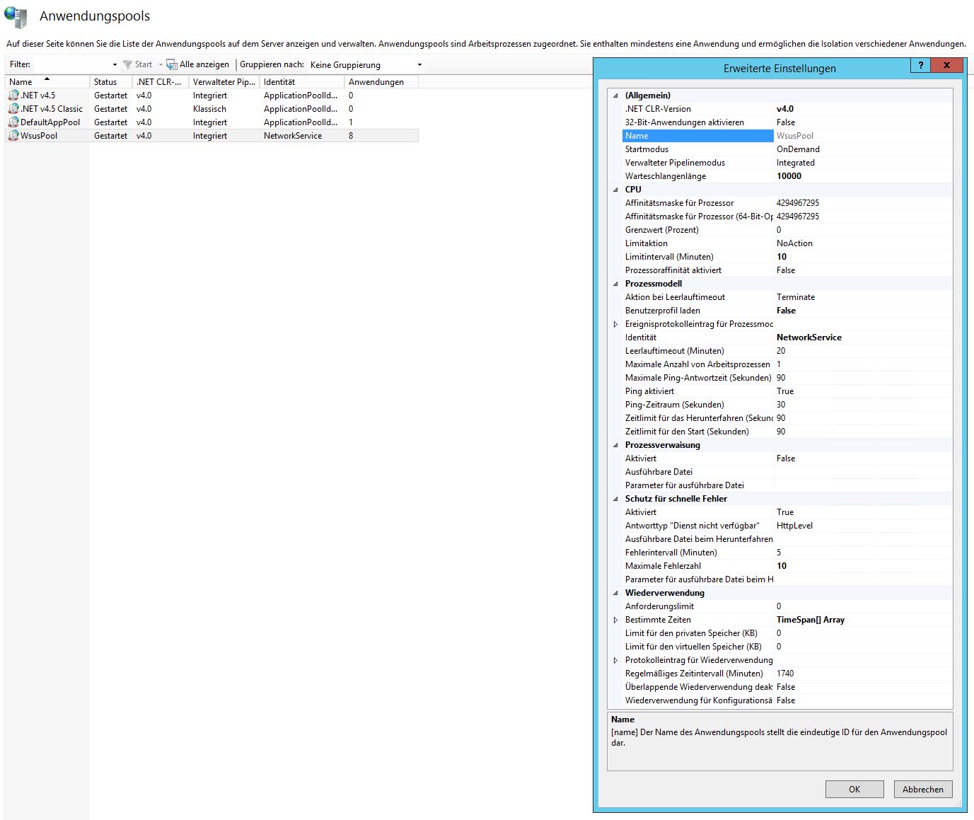

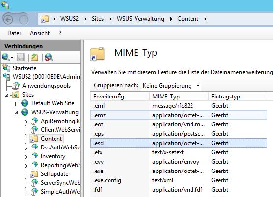

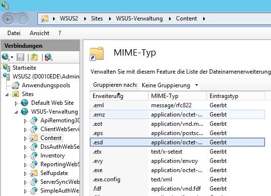

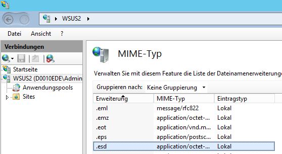

Den MIME-Typ habe ich auch bereits lange im IIS hinzugefügt (gleich dem ganzen IIS zur Verfügung gestellt, also oberste Ebene).

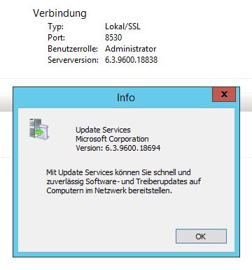

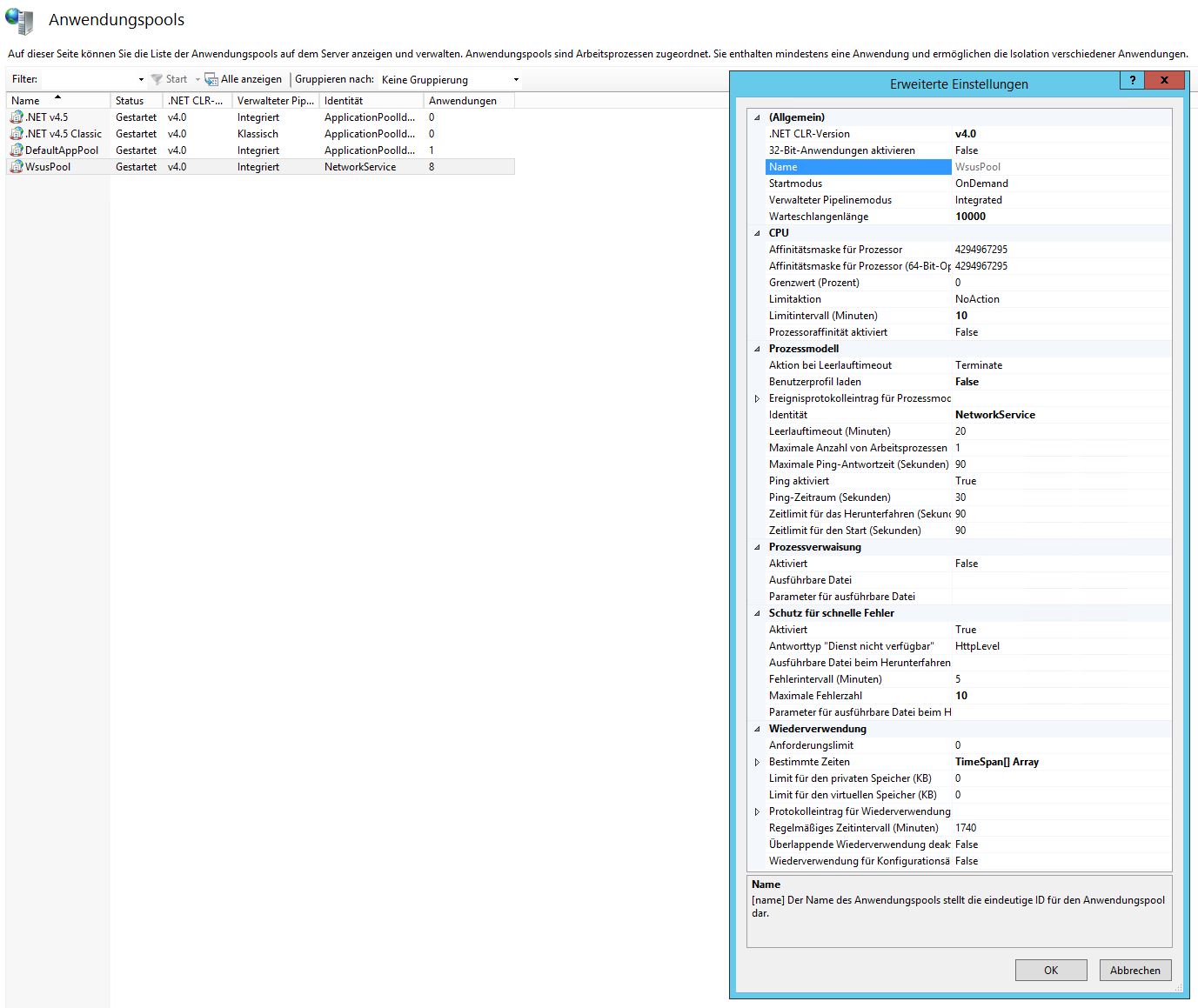

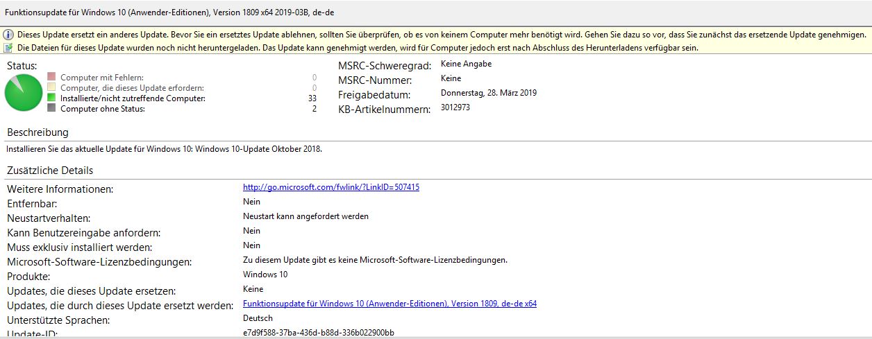

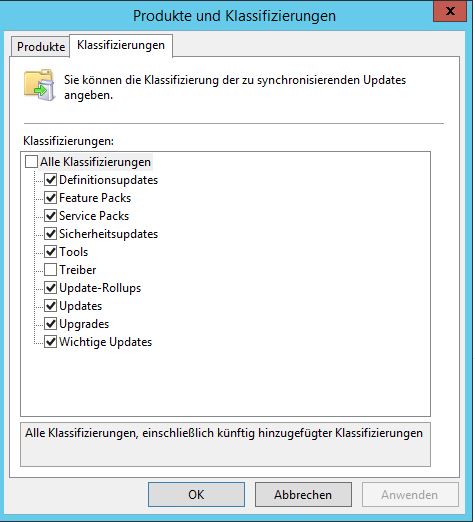

welcher Version zeigt denn Dein WSUS in der Konsole an
bei 2012R2 sollte es 6.3.9600.18838 sein
@XN04113
Ich habe vom WSUS schon die aktuellste Version s. Bild:
