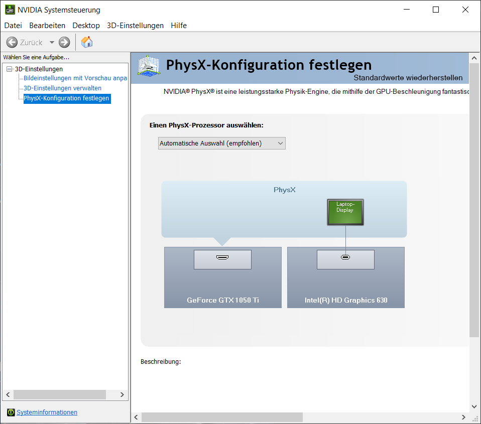

This might be interesting. Its the system settings of my NVIDEA graphics card. According to the images it looks to me, that the hdmi port is connected to the 1050 Ti.

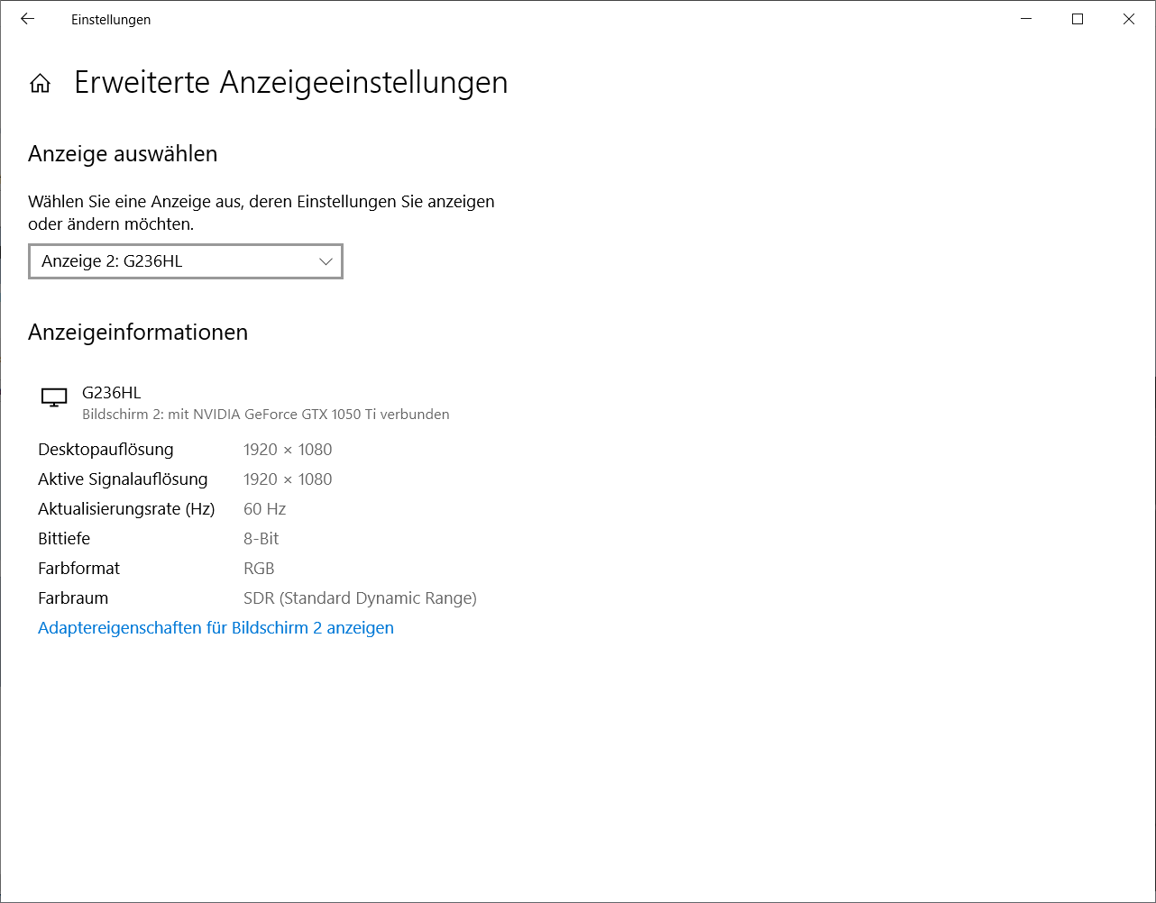

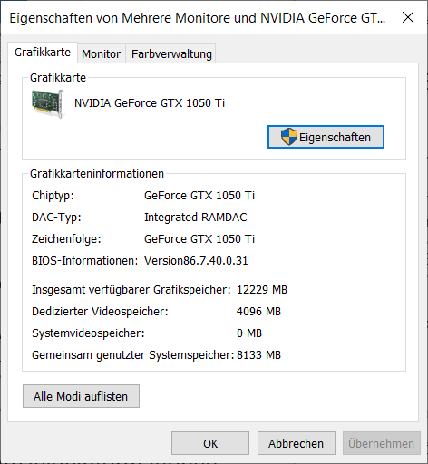

I just got the idea to connect an old full HD monitor and got the following information. So that would mean I can use any 4K monitor also with 4:4:4, correct?
Given the phsysical form of both outputs, yeah, sure looks like it.
Unfortunately not. The information displayed for this monitor doesn’t say anything about the chroma subsampling or refresh rate when used with 3840 × 2160.
Try setting the refresh rate of this monitor to 30 Hz just so you know what it feels and looks like. It’s considered to be awkward and disgusting for most computer work but if you’re okay with it, go for it and use it with 4:4:4.
As mentioned above, do yourself a favour and try with a 4K TV beforehand. Better to be safe than sorry.
But when plugging in the Full HD monitor I can see, that it is connected to my 1050 Ti. Wouldn't that mean, that I can supply the monitor with the max output that the 1050 Ti can support?
