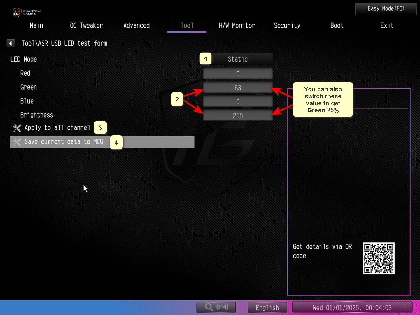

Moin zusammen,
Möchte euch die ANtwort vom ASRock Support nicht vorenthalten:
B850 Riptide WiFi
==> First Answer with example Test: "With this is was possible to configure RGB lighting directly in the BIOS setup. Please see the attached screenshots."
lowest Budget - ASRock A620AM Pro RS WiFi (2 video output ports, but not 2 DP. Front USB-C only has 5Gb/s.)
Mid - ASRock X870 Pro-A WiFi (has almost everything, Front USB-C only has 5Gb/s)
Top - ASRock Phantom Gaming X870 Riptide WiFi (has everything, but most cost)
==> Answer: "I used a tool to check the latest BIOS of those 3 models, and for each model it shows the same RGB options in BIOS 😊"
Bild 1:
