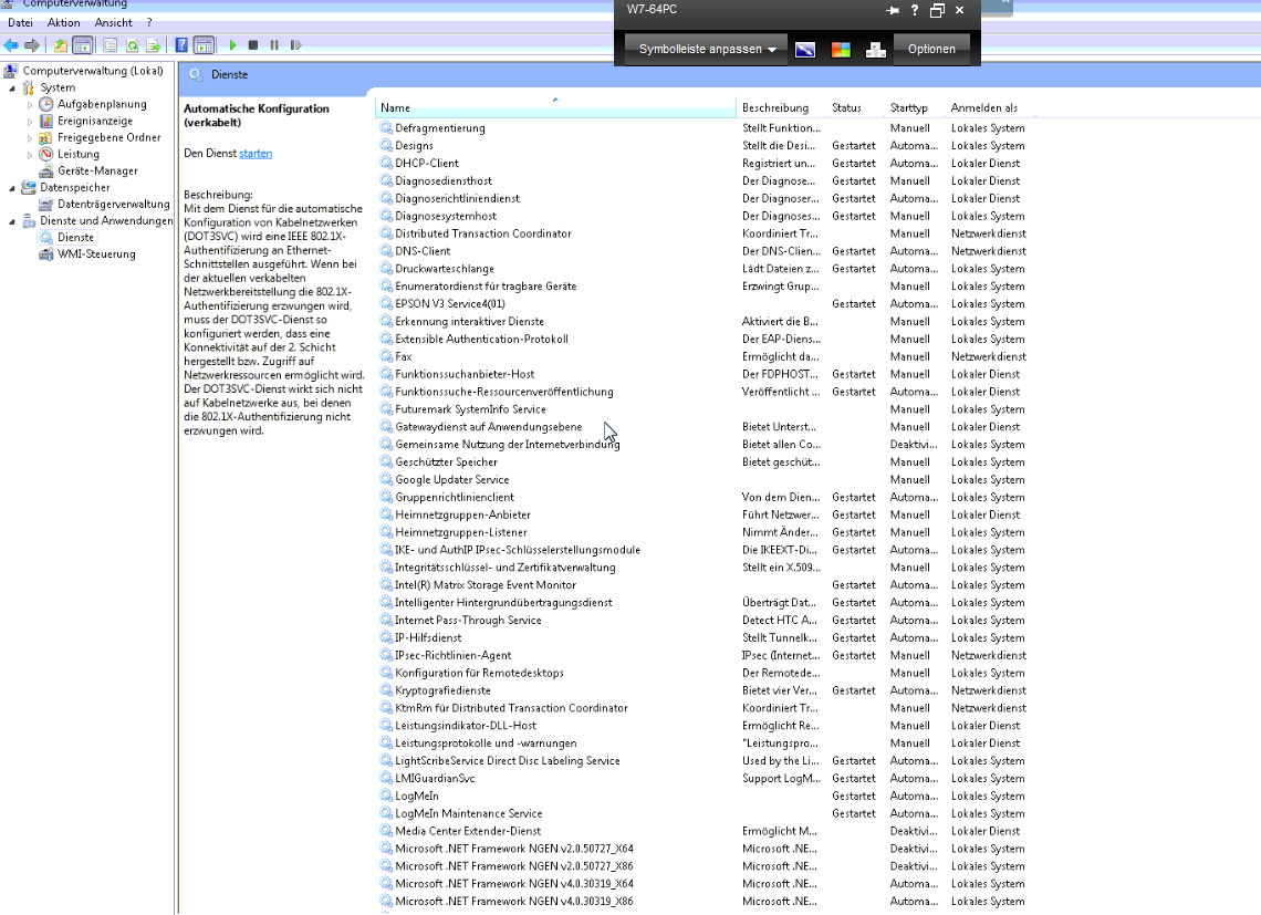

Habe mal das ganze an Steelseries geschickt und die haben mir das geantwortet:
1. Open start menu located on your taskbar.
2. Right-click "Computer" and open "Manage".
3. At the left, under "computer management", you find "Services and Applications". Open it and select "Services".
4. Search for a service named "HID (Human Interface Device)"
5. Once found, check the status. If the value is not "Started", start it.
6. To make sure it will be on also in the future, check the Startup Type value. If not "Automatic", right click it, and select properties.
7. Under the tab "General", change the Startup type to Automatic.
8. Apply and close.
So weit so gut. Nur unter Windows 7 gibt es diesen Punkt garnicht? :freak:

Ja alle Ports bereits durchprobiert. Tritt bei allen irgendwann beim starten auf.
