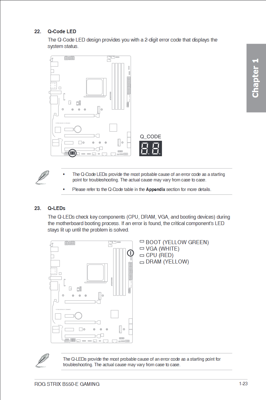

ROG STRIX B550-E GAMING User’s Manual (English Edition)
Seite 1-23
Q-LEDsT
he Q-LEDs check key components (CPU, DRAM, VGA, and booting devices) during the motherboard booting process. If an error is found, the critical component’s LED stays lit up until the problem is solved.
@Hauro
Von den Q-LED's leuchtet kein Lämpchen.
Der Q-Code FF (Reserved for future AMI error codes) besteht aber weiterhin.
