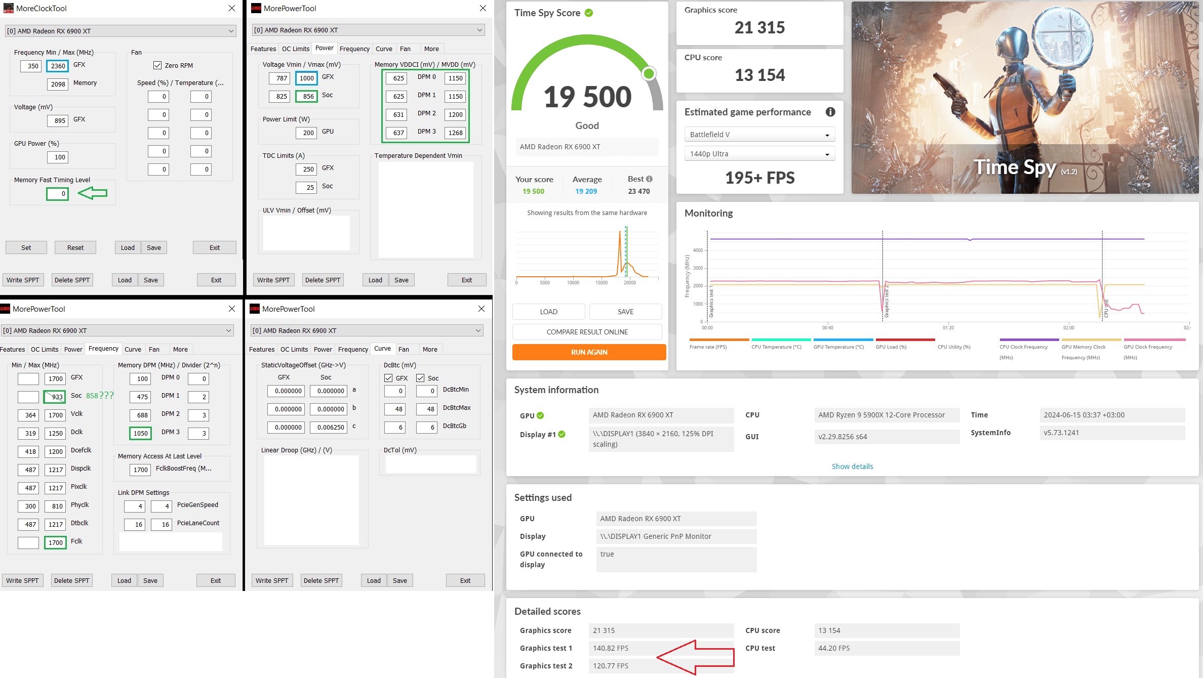

Just so happened to be my highest score; maybe because I ran the test as soon as I opened my computer so temps were cooler. I used to be able to pass with 2625MHz at 1075mv now it barely passes at 2600, so I did 2595 for this test.

may be FT2 is useful@6900 but not permanent required@little 6800nonXT
the 6900 needs 33% more bandwidth
FT2 needs a little bit more Volt+Watt and also to get the highscores a little bit more fclk+soc with also more Volt
but in real games with Fps-Limit+Upsampler+FG/AFMF, there´s 24/7 no need of the highest bandwith

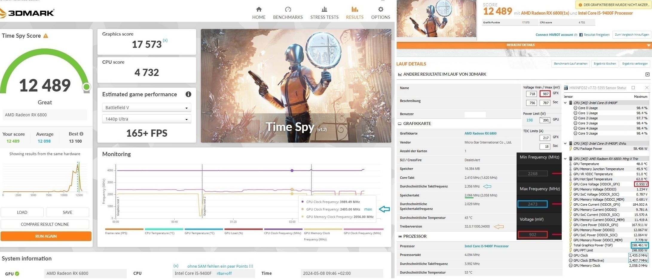

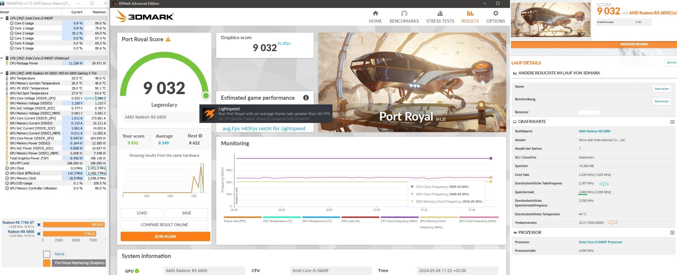

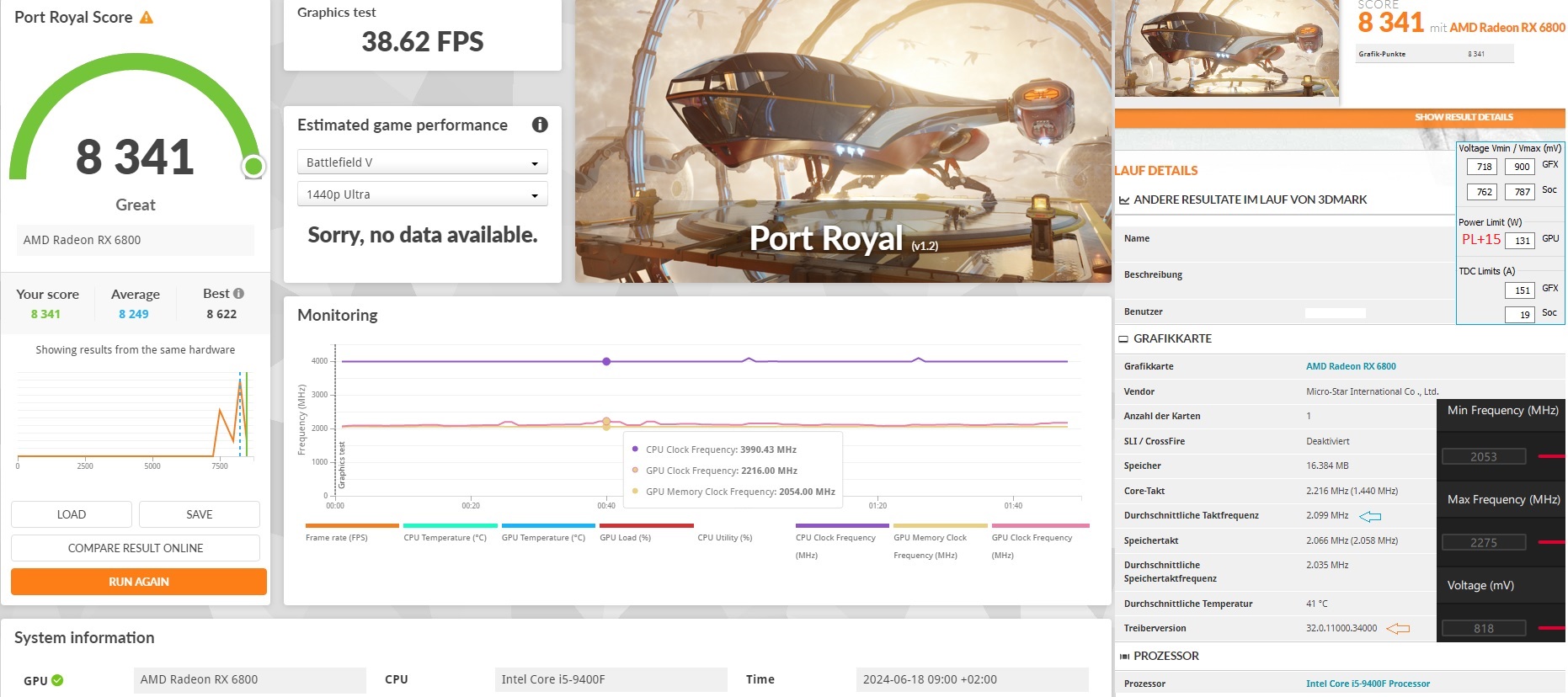

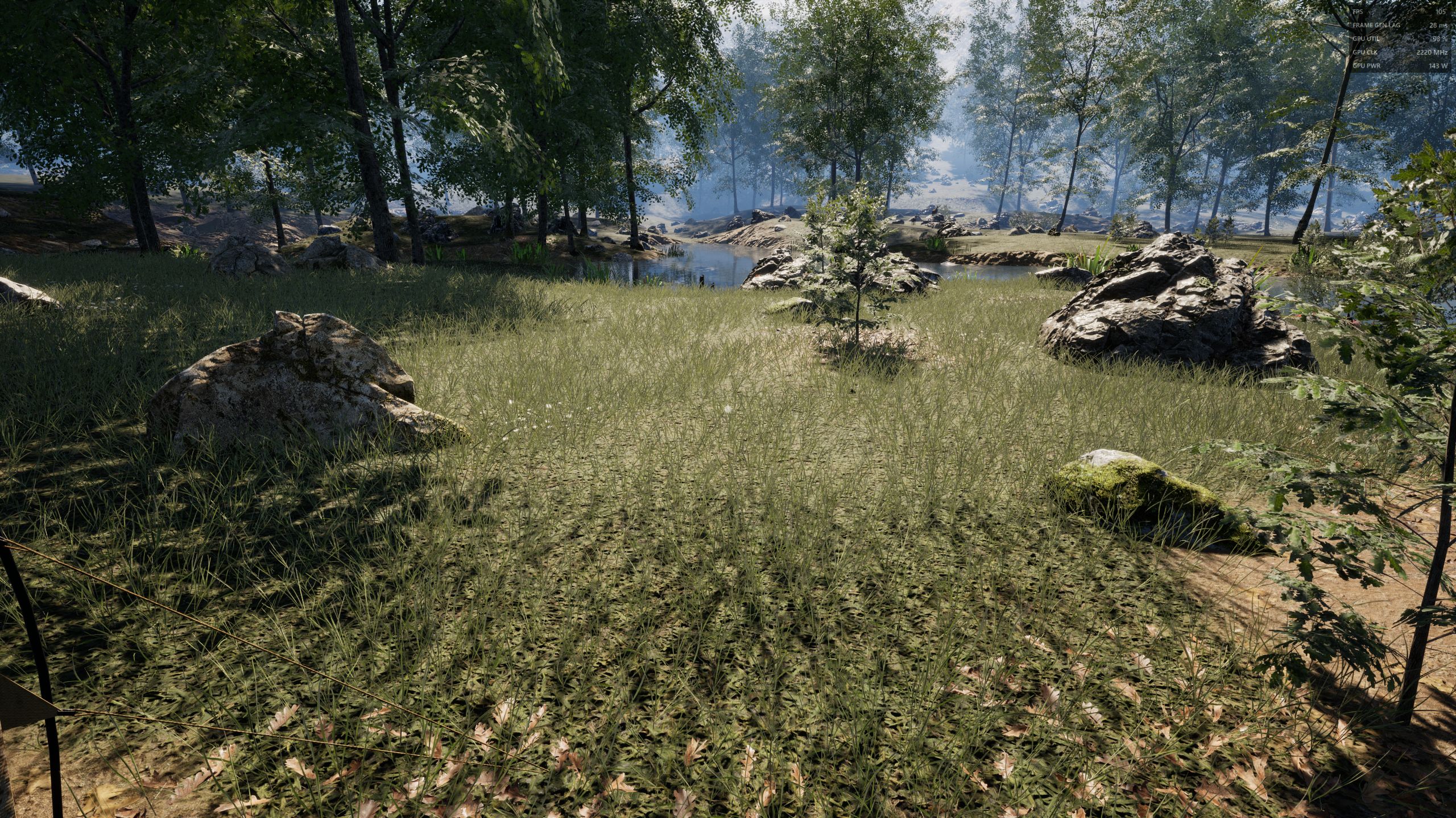

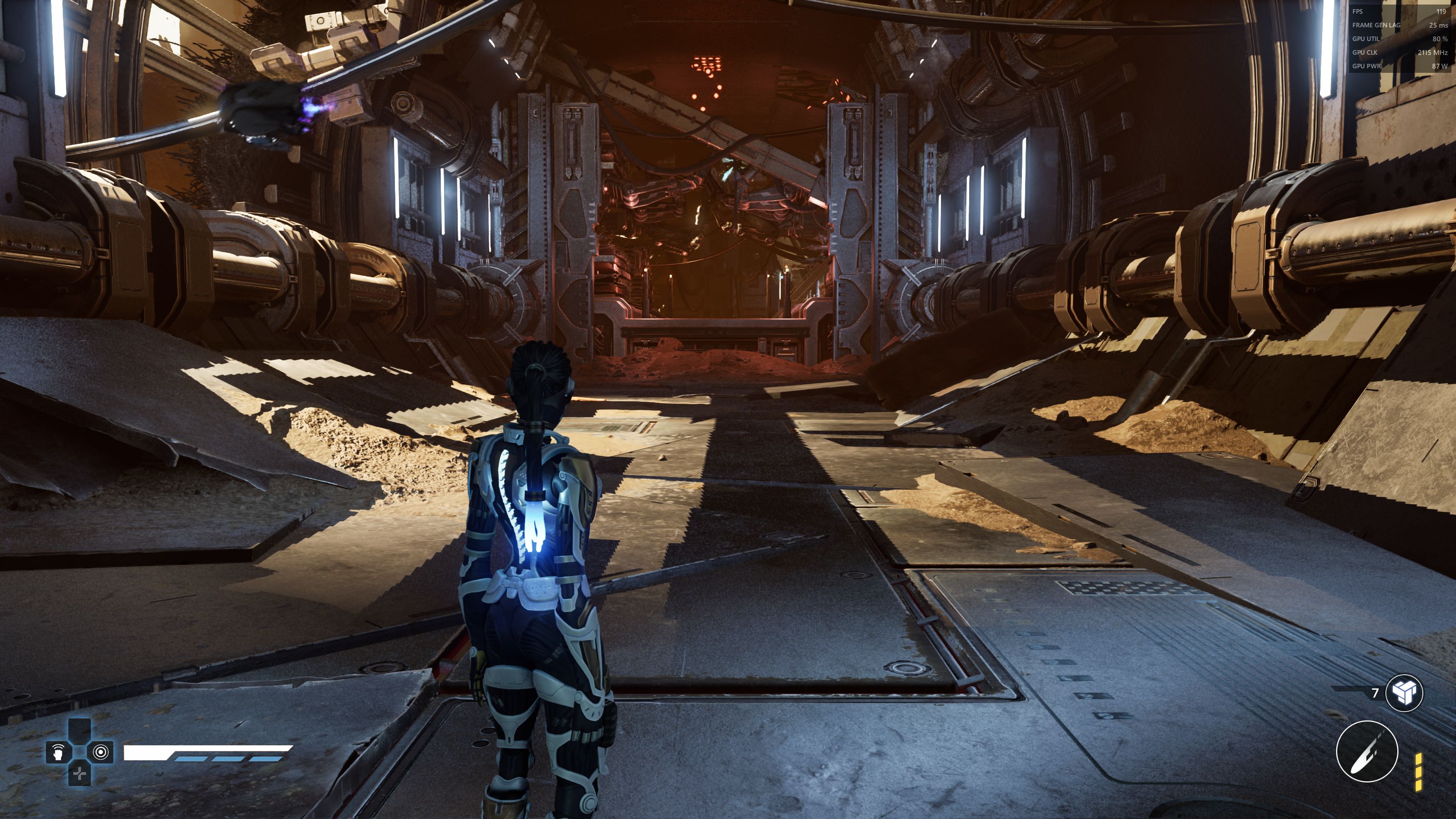

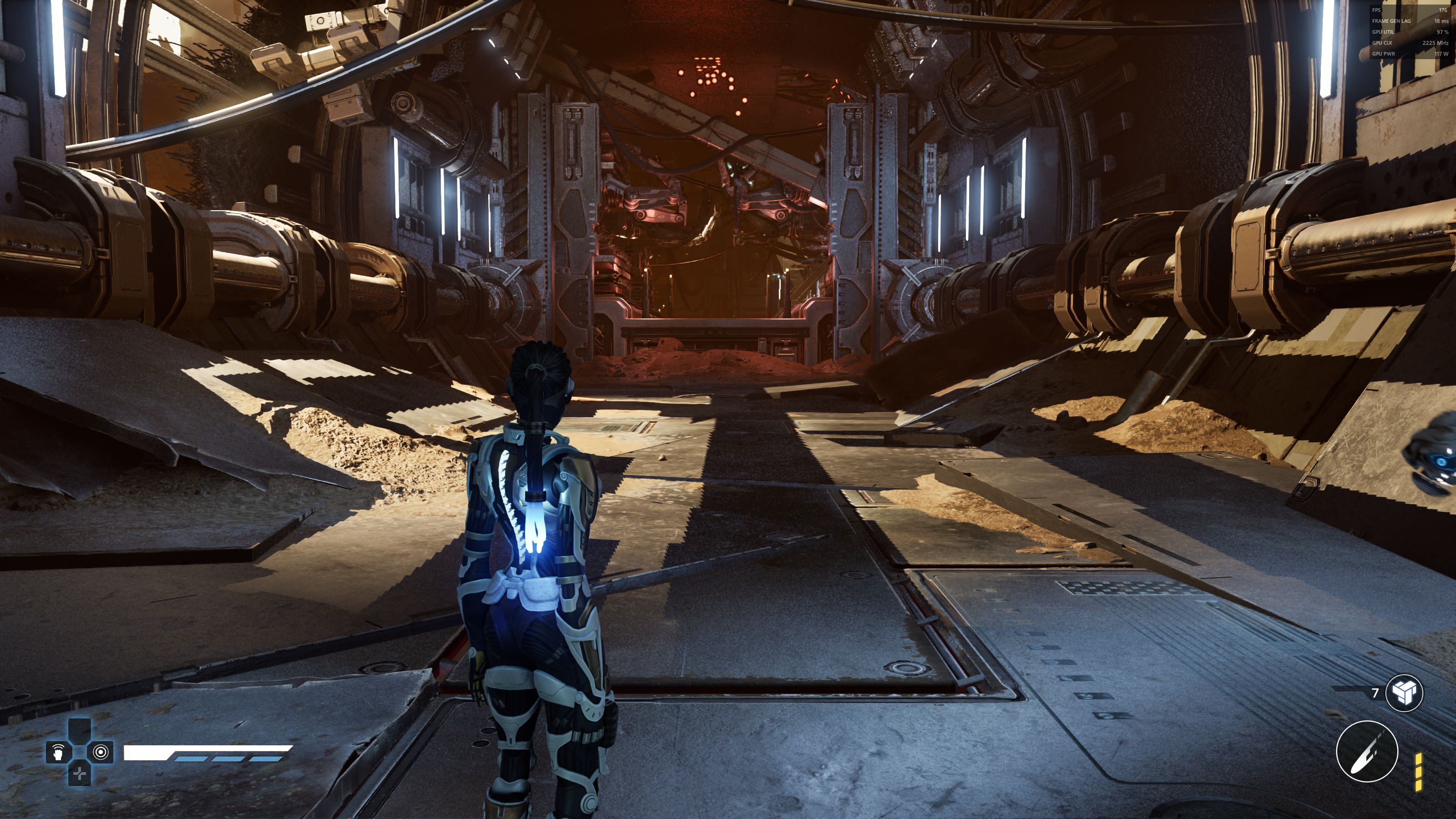

What to do with this Watts?

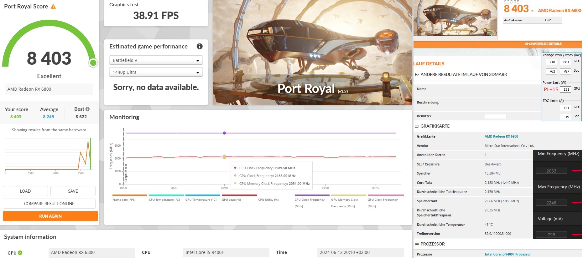

I decided, to use a "slower" setting with a little bit more GFX-Volt+Clock because FG/AFMF needs more Shaderclock-Boost. This actuell 2275MHz is my default maxClock, but with good UVing@GFX+SOC/fclk+Vram.
example 2+3 without fps-limit to show what´s possible@custom inGame-Settings with the 150W-MPT
example 4 with fps-limit = RTSS 59fps means AFMF 118fps, ... stay´s cool+quiet

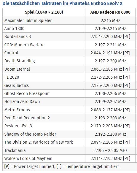

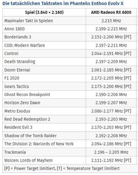

The real game clock depends mostly@PL+Temp: -->the max eff. clock@launchreview = eff.2215MHz
therefore maybe the UV@GFX and SOC+fclk+Vram helps enough
also the effect of Vram-OC+FT helps to reach the same Fps

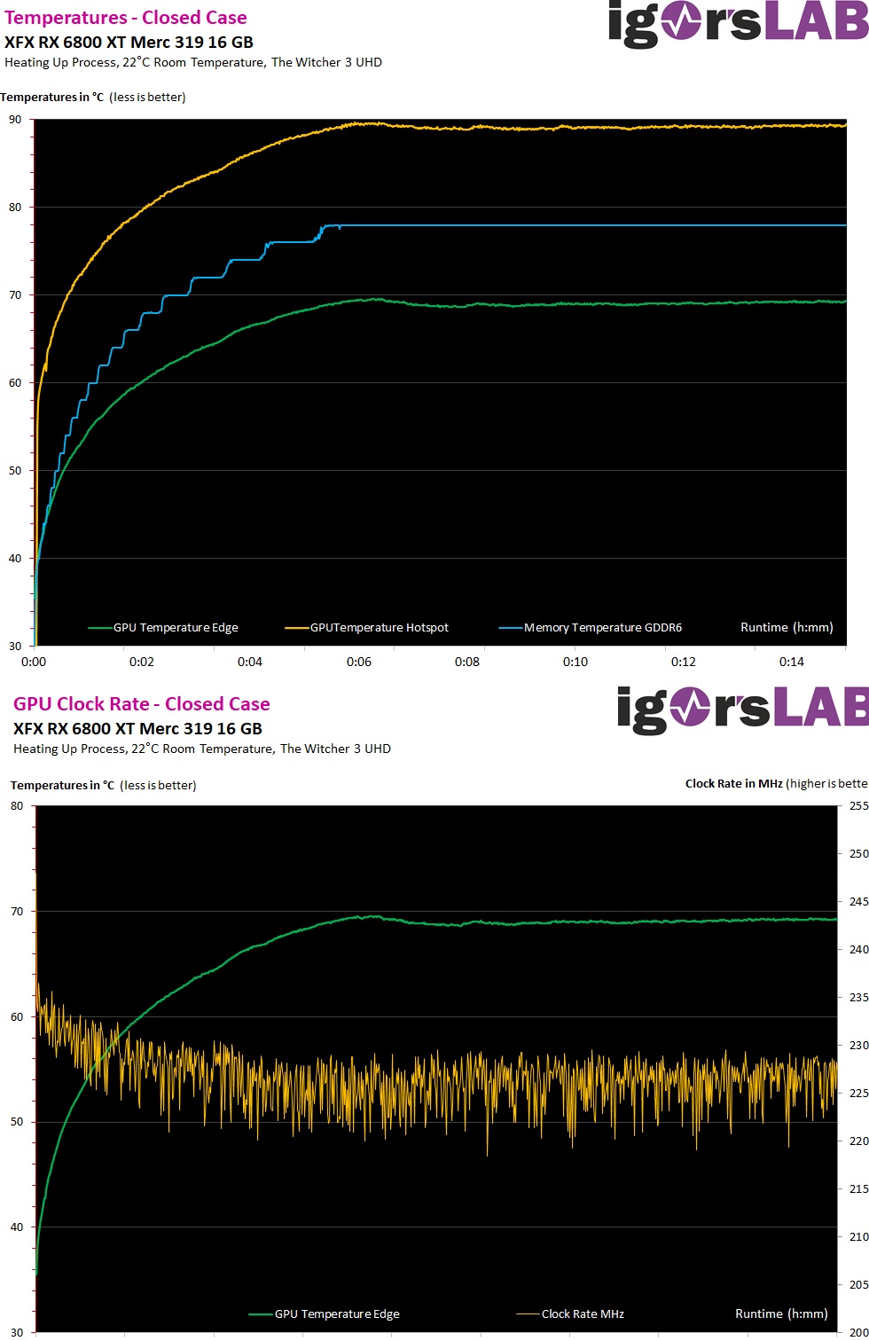

look @temp-throttle with a XFX in example 2
seems@default-Bios to be locked @90°C Hotspot as throttle target temp
the fan-control of the XFX use Hotspottemp !
you can try moore target temp with the Trio

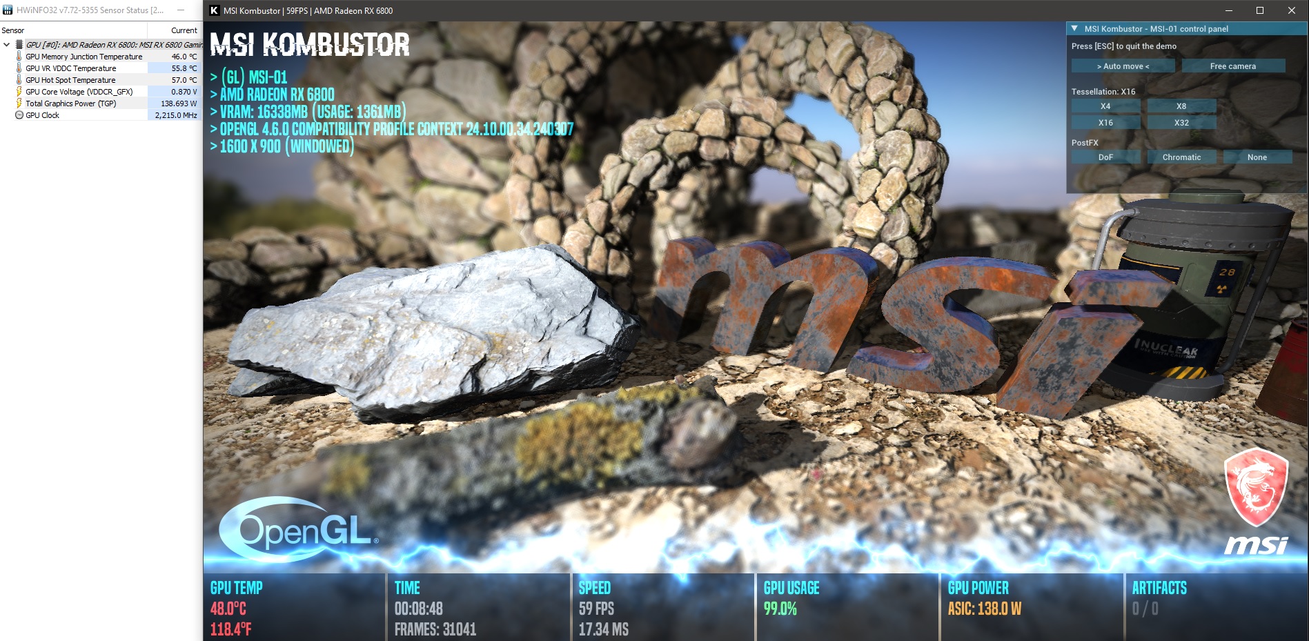

may be with 275W you can reach the same clock as with 281W in Kombustor
(run the light GL-Test some Minutes, it has a good boost clock like Gaming with Upsampler+FG/AFMF)
example 3
with my 24/7 fan curve @"closed" case it works <60°C Hotspot and <50° memory Junction (x)
(with distance sticks between glass to case, ... should work like a open case)
may be <50°C memory helps to have less failure correction

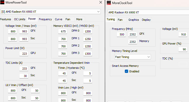

a quick view to other optimized Settings with this voltageEvgasüchtiger schrieb:Try a little less tension and tact. I would try with 1000mv GFX in the MPT and in the driver to set the max clock to 2480mhz mhz
Bread can run maxClock 2352MHz@993mV
Lyero use maxClock 2360MHz@1000mV (x)
edit: may be, your good 6950 can run maxClock 2475 with this voltage, because of per part curves!?
or my little 6800 (see example 3)
230W should be enough to reach 6900ref PerformanceEvgasüchtiger schrieb:and nail PL in the MPT to 250w
