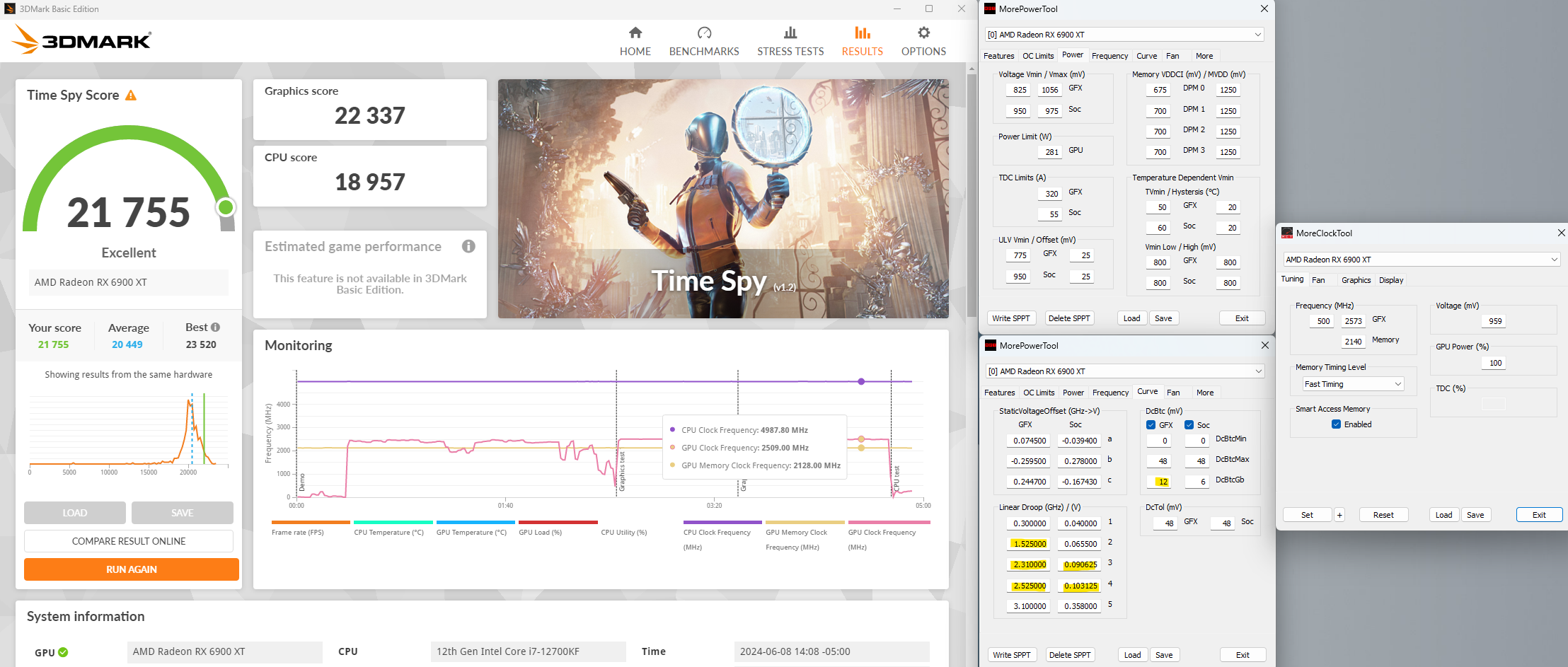

This 1050mV profile is slightly more stable than the previous 1056mv with the curve optimization, but it still crashes; this time in, like, 2-3 hours of gameplay rather than 1 hour. Don't know what could be causing that.
this not really a big problem, make a short break after 1-2 hours, and let cool down your 100°C- PC
may be, your RAM is also too hot
cra3khead schrieb:
Could this help stabilize my 1050mv profile? ... Probably not
wrong test =1062mV@2583MHz
and
with 2578MHz?
and
What is with 1056mV@2573 or 2568MHz?
It takes some more tests, to find a stable 24/7 combination.
You responded just as I had finished a run testing that :D
41 more points than the last 1056mv TimeSpy score. Although I think I am very slightly power-limited, the clock speed nearing the end of the test drops down to 2490. I will try to see if it's more stable in games later at night.

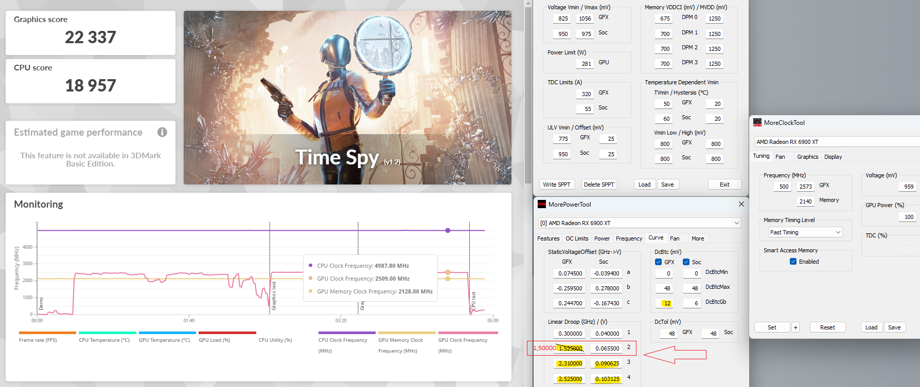

Never mind, it was just Forza 8 still being broken a year after release. Now I don't know which profile from all the different curve settings I should use. Do you think the last one is the best so far, or is the LD4 voltage a bit too high? Should it be somewhere between .980 and .103125, or is it better that way with the LD3 being pushed up 10 MHz?
the #6.685 with safe LD2 1,475000 GHz
1056mV should be a little bit safer then 1050mV

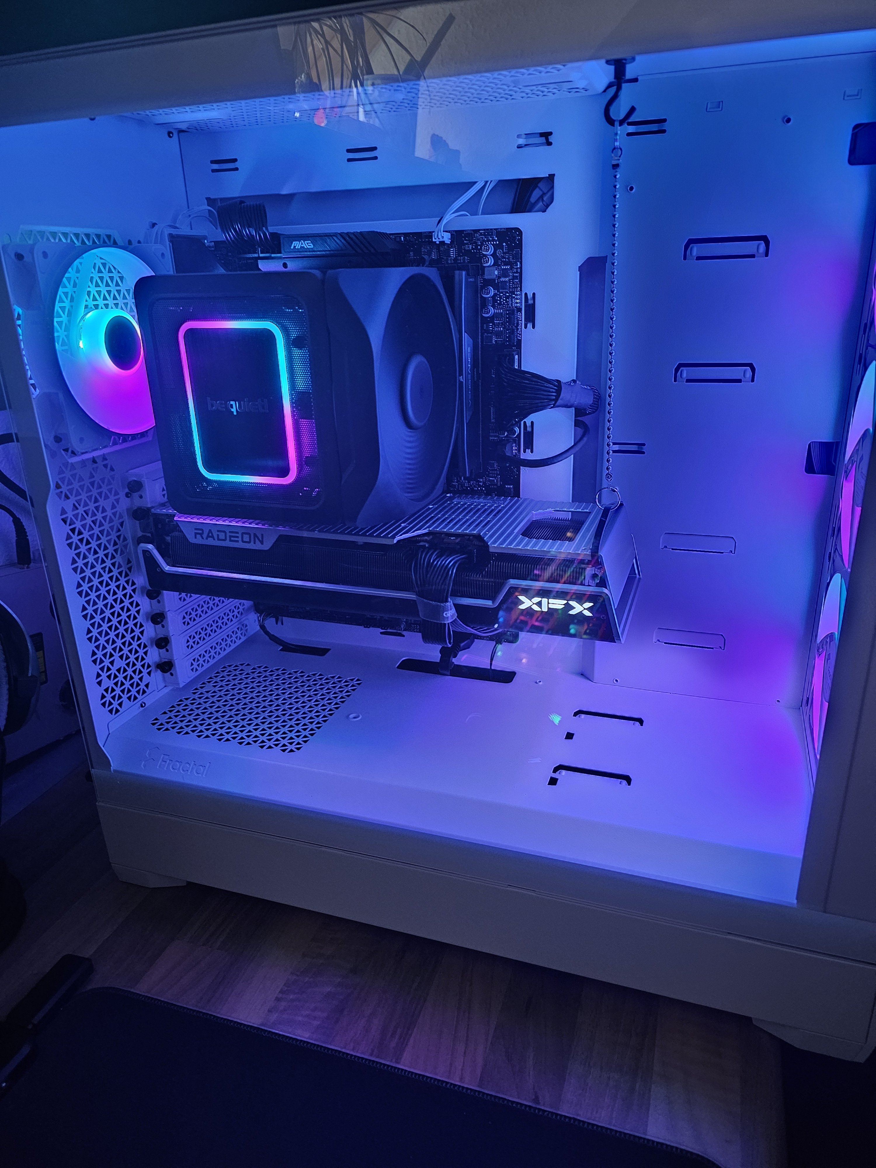

70% Videoschnitt/ 30% Zocken 😉
Ist für meinem Arbeitskollegen . Er schenkt diesen PC seiner Frau . Sie macht youtube Videos. Er möchte ab und an mal Zocken. Zum nur spielen hätte dann natürlich den 7800x3d genommen. Ich habe ihn den 7950x3d ans Herz gelegt, nur der war ihm zu teuer 😁 570€ zu 385€... Kann man verstehen 😉
Reaktionen: Verak Drezzt

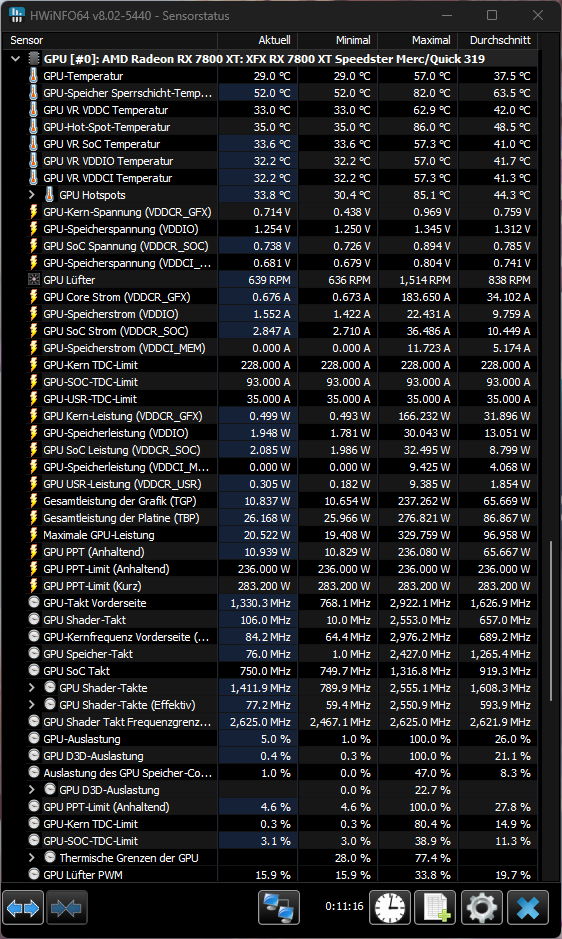

@Evgasüchtiger schon etwas hoch die Differenz, aber solang sie unter 90°C bleibt, alles im grünen Bereich, kannst ja mal schauen wie weit du im undervolting und der Powerlimitreduzierung bei Standardtakt runter kommst

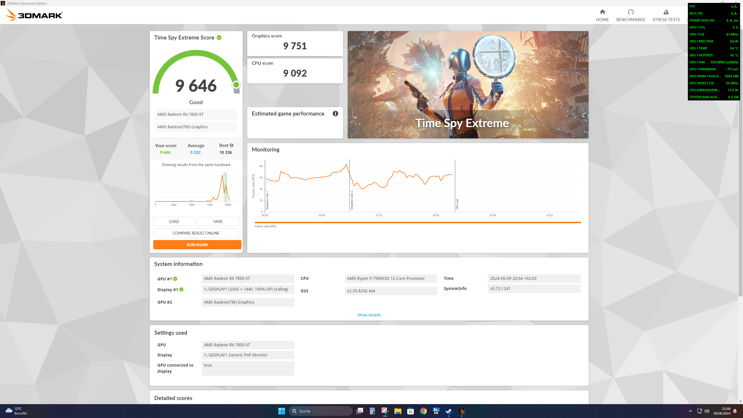

Hier mal ein RUN TSE

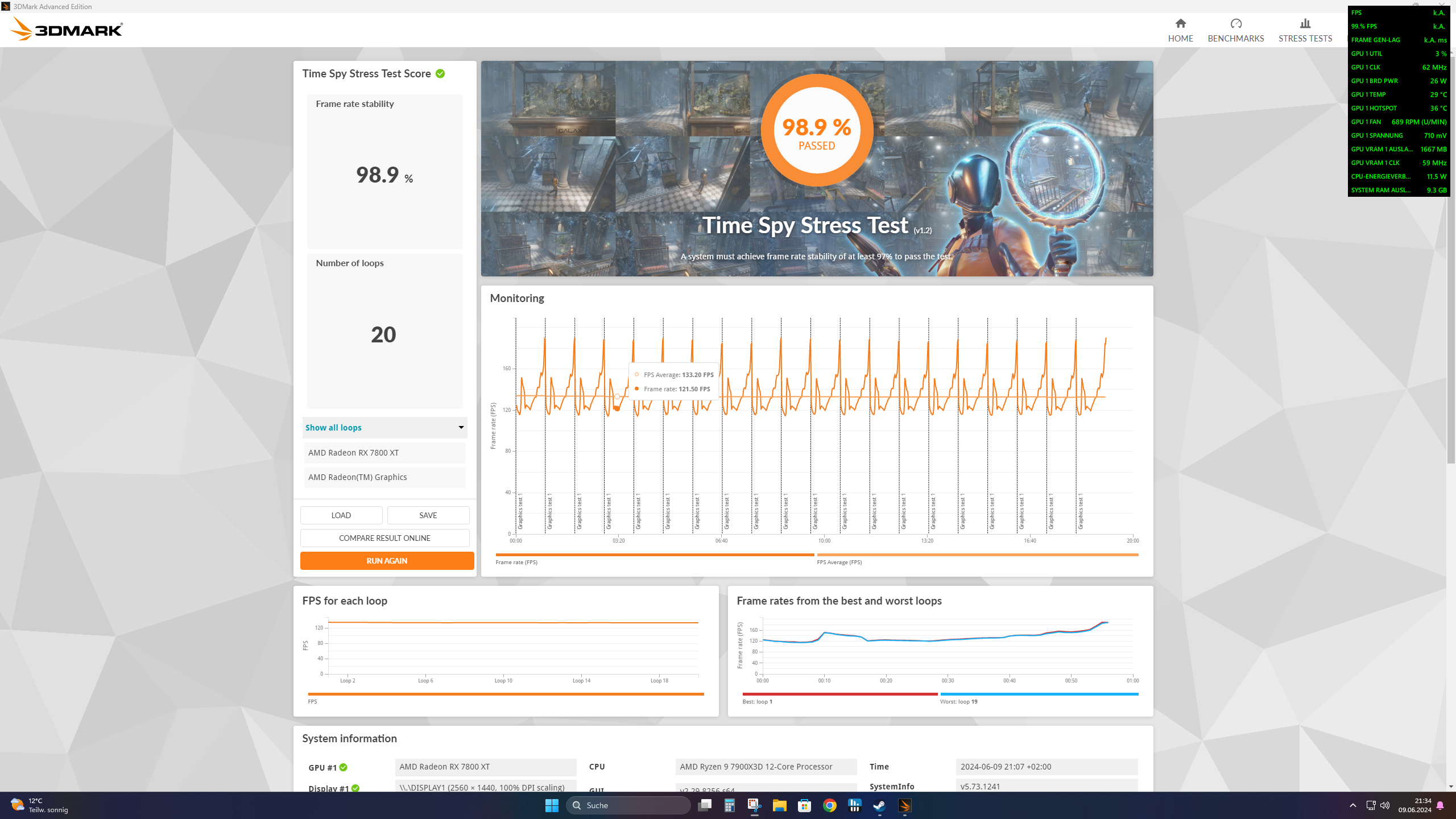

hier der Streßtest vom TS

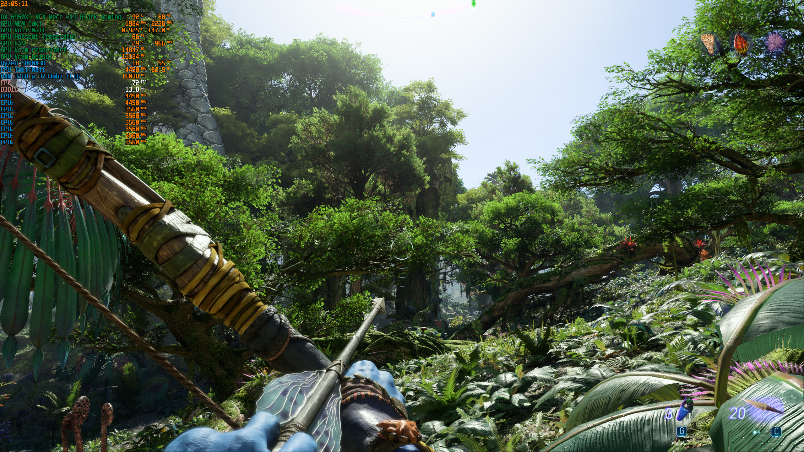

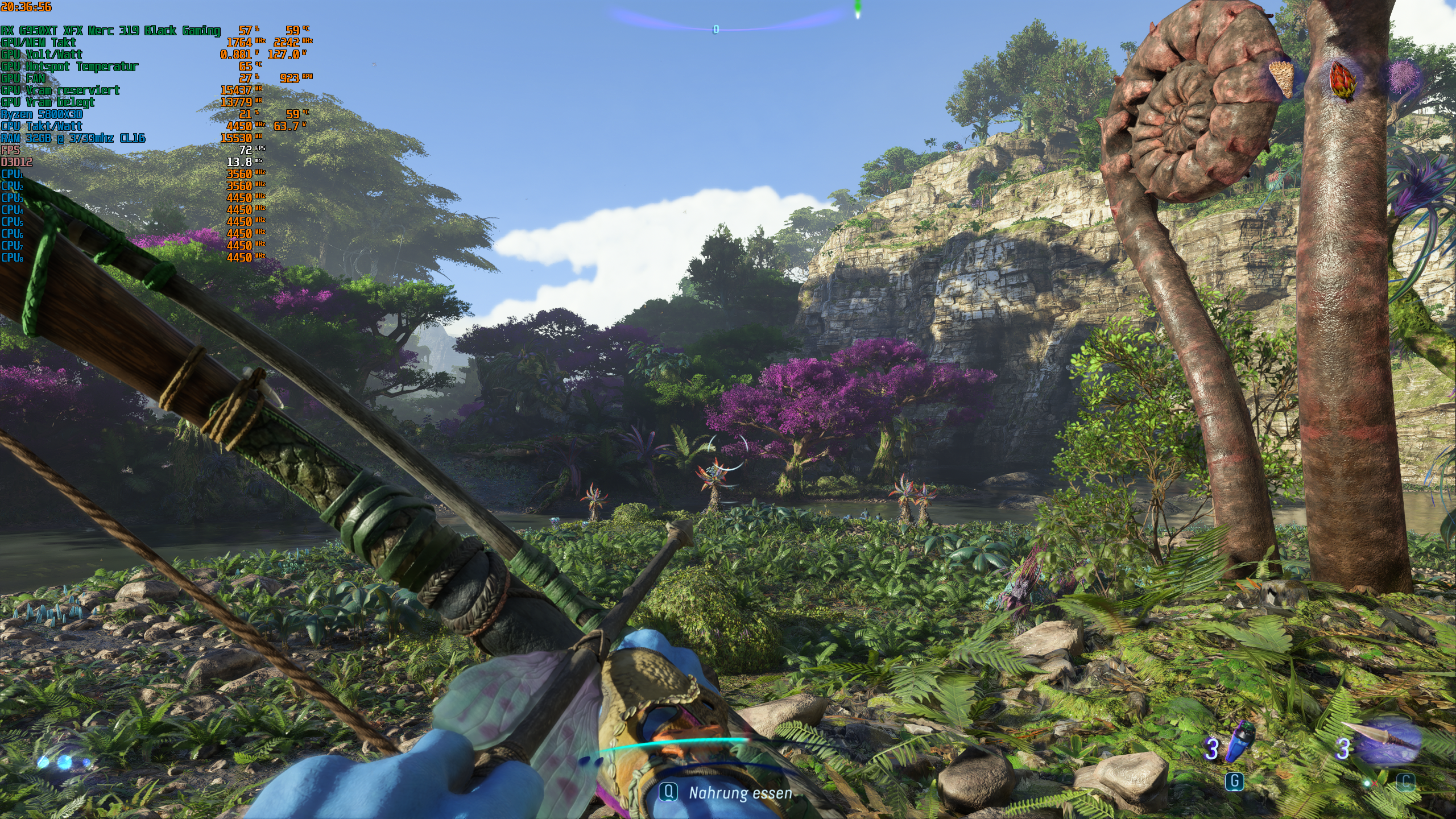

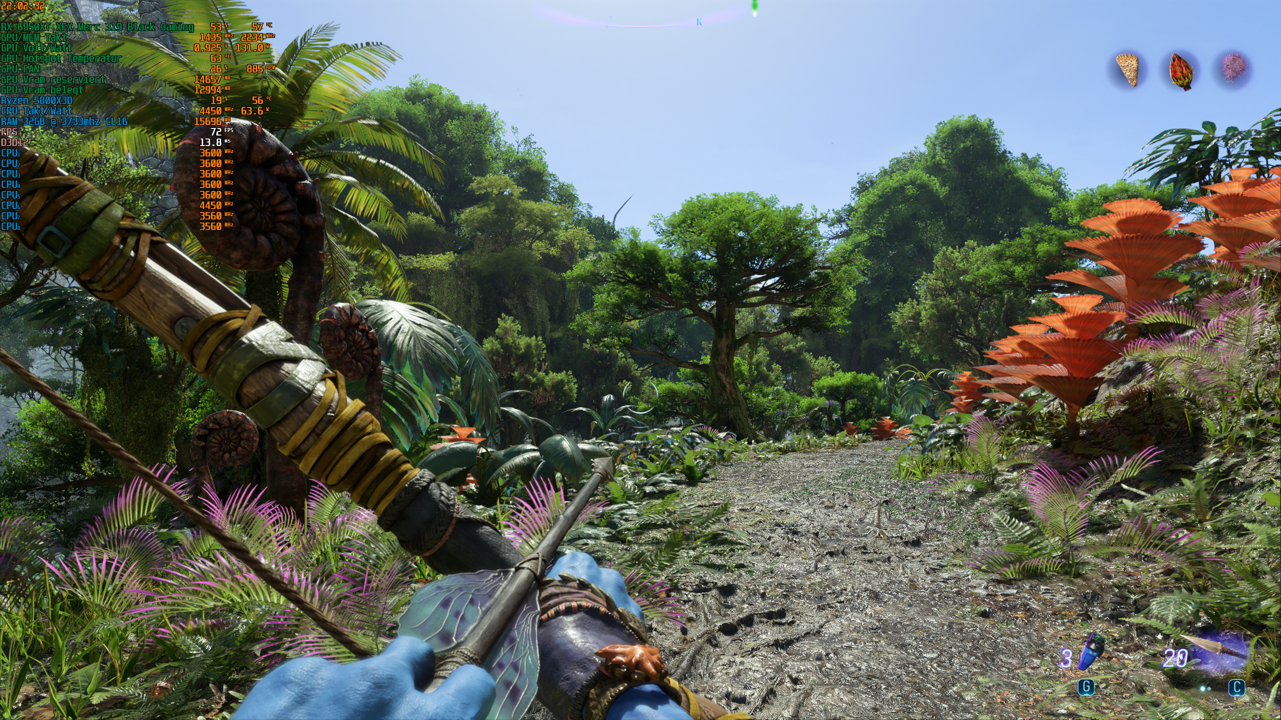

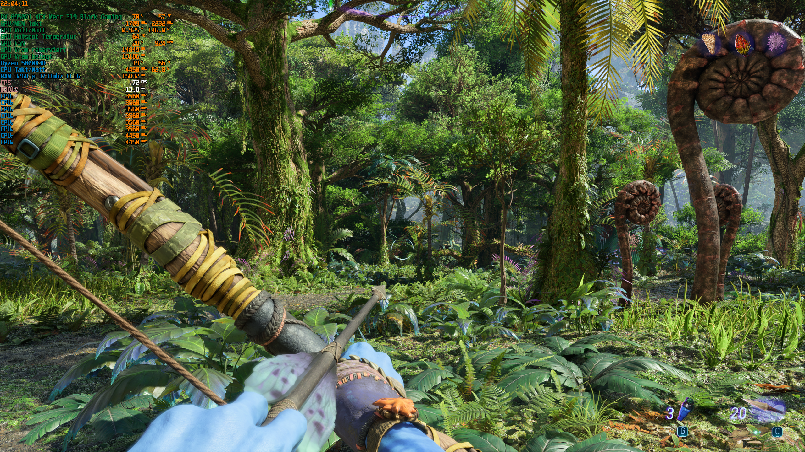

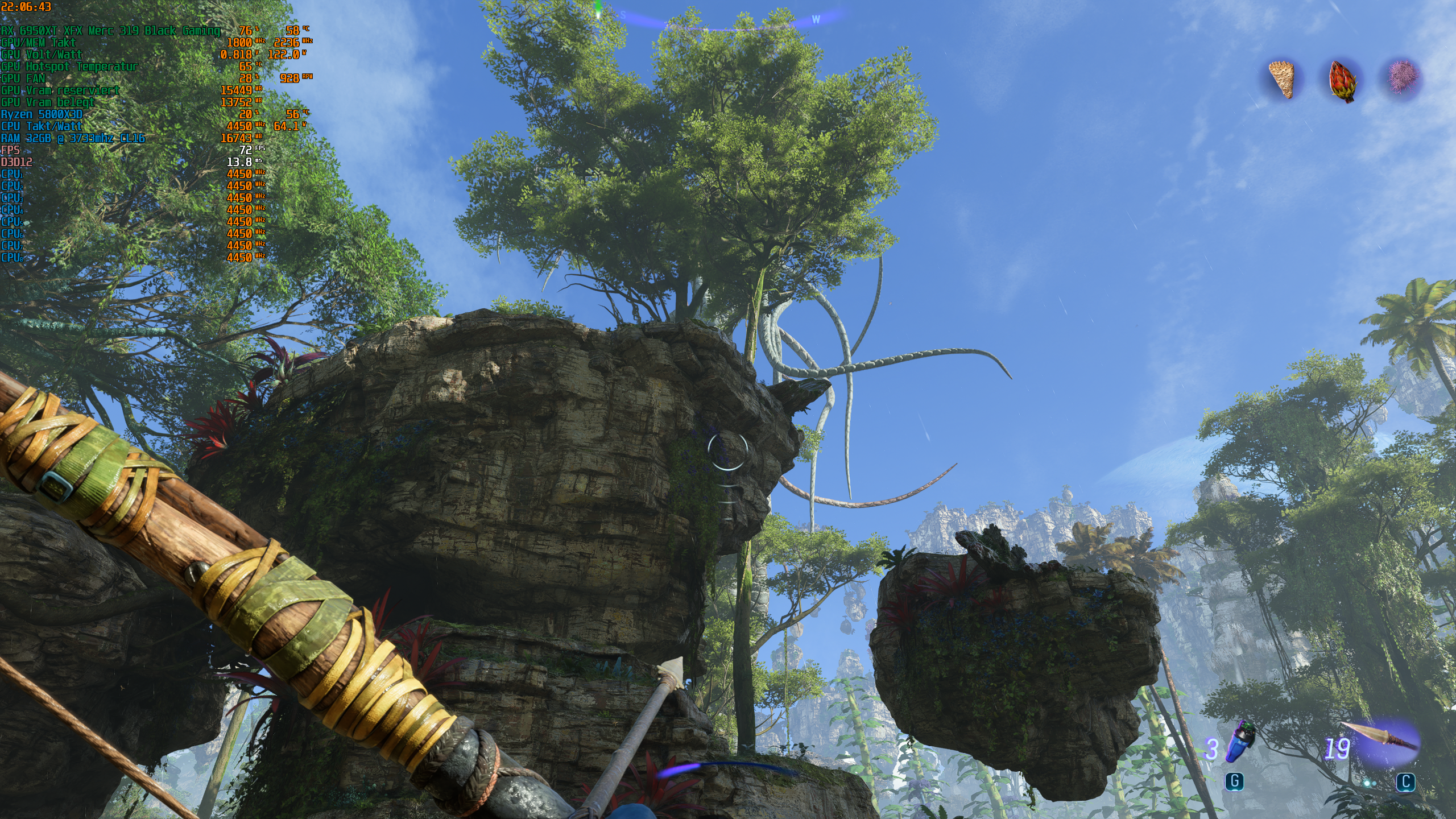

Heute mal Avatar wieder angeschmissen. Paar Stündchen gezockt mit FPS Limit auf 72 Fps. Hier mal ein Paar Pics zum Ende der Session....
