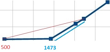

may be minClock=1473 is little bit more stable then default 500
I dont know how Chill interpolated the Volt in Games with Fps-Limit.

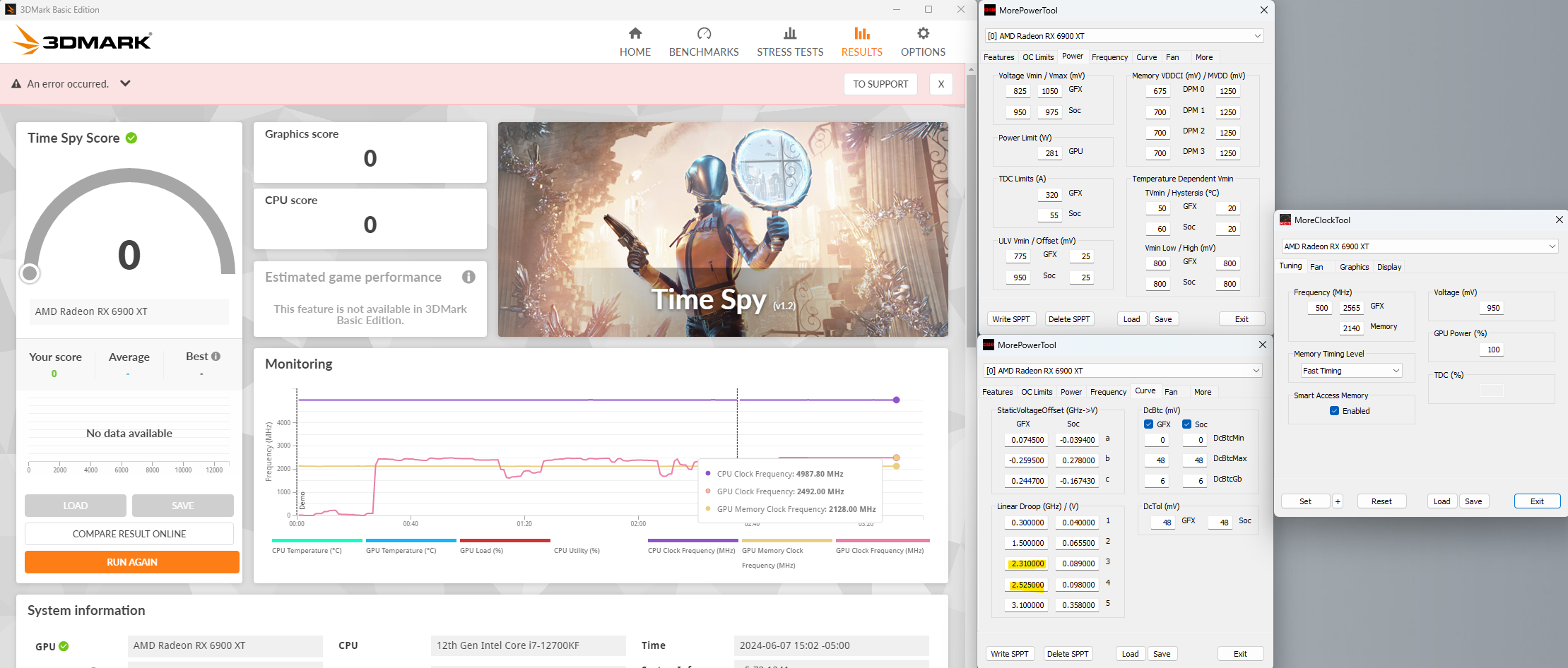

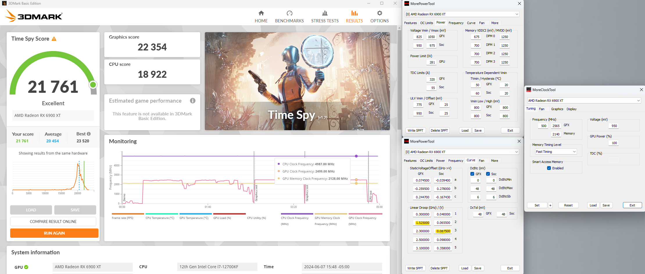

@GerryB Why such a big jump in voltage for 10MHz?
Edit:

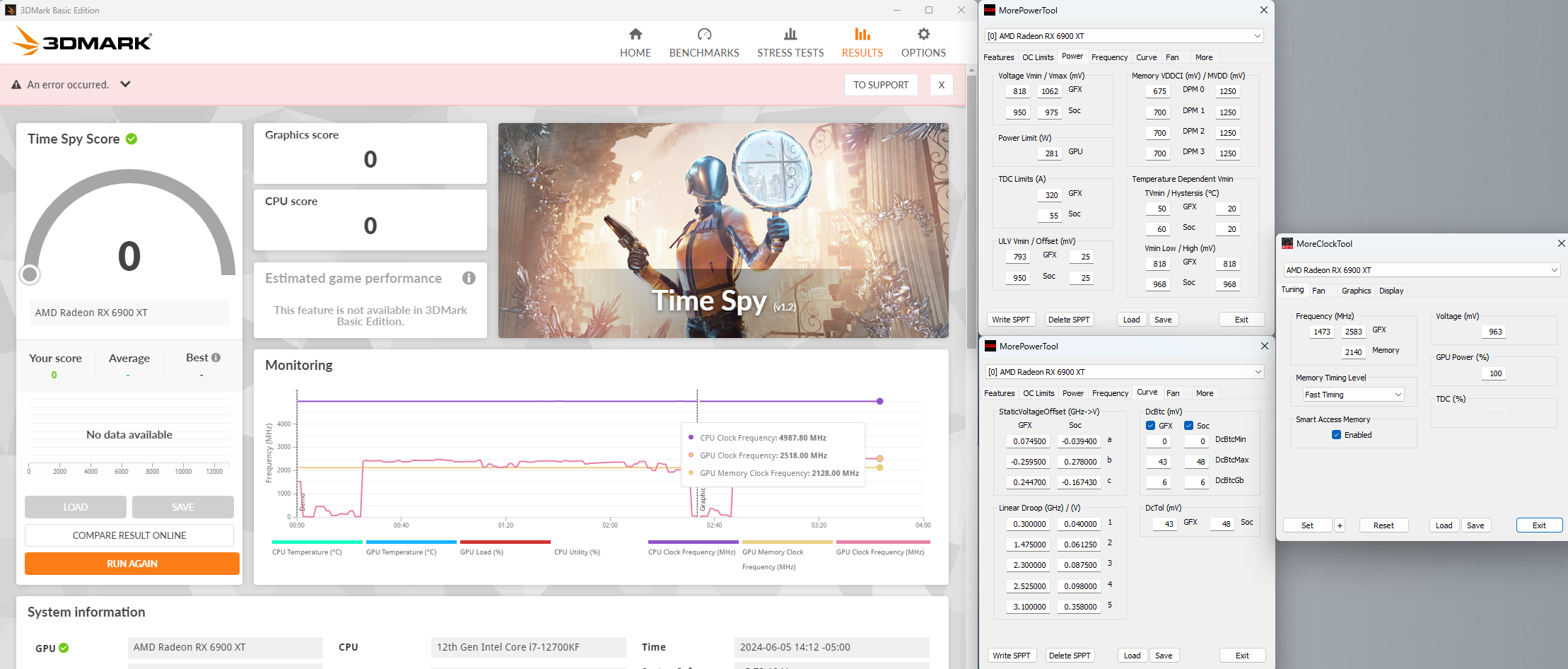

It crashed while switching to GT2 :(
30 points more; now it's the same as my 1050mv score.

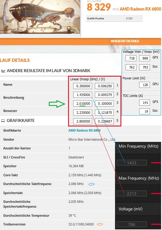

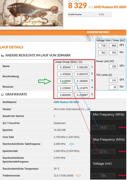

(in this kind a crazy Test with my 6800 see attachment, in PR@RT goes more Clock@lessVolt then in Games@Raster,
in RasterGames 15MHz less with more Adrenalin-Volt)
I think, in some games the change in tolerance 48-->43 was to much with your setting/chip.
for safety back to default 48

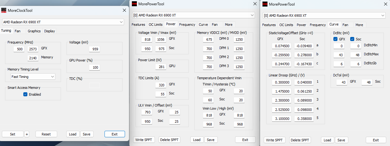

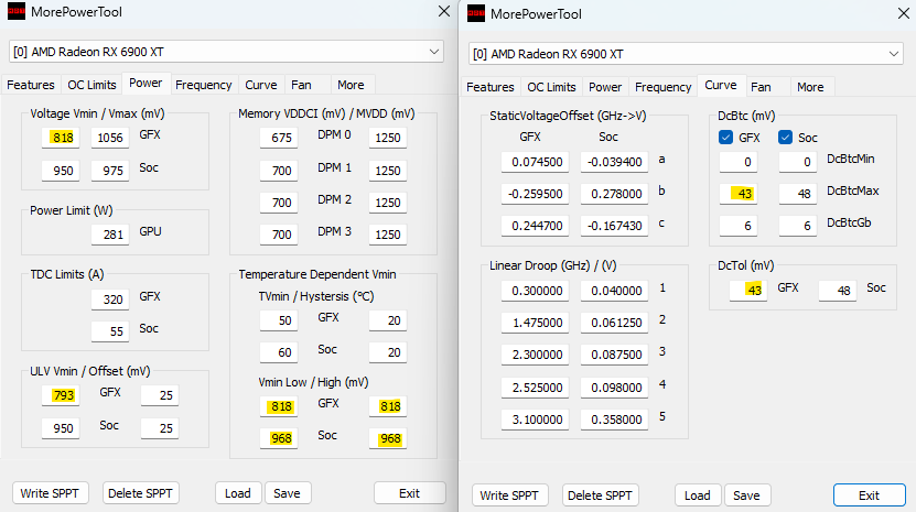

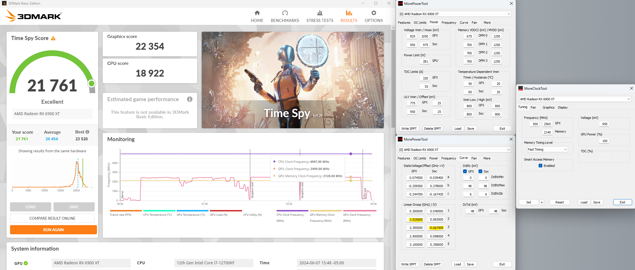

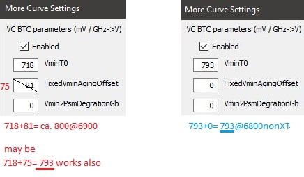

If I change it back to 48, do I have to change the vmin values back to the default of 825 and 775 for ulv min, or are they unrelated?
With the new profile, should I keep the LD2 default? I don't think it's worth changing since my card barely goes to that low of a clock in any game I play.
Weird :mad:
57 more points over the standard 1050mv profile. I think the LD4 just causes instability since it doesn't hit over 2.5Ghz anyway. My highest score at default tdp (281 Watts) though !

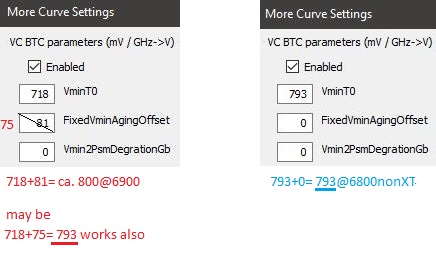

no, the idea with with minGFX 818 was independent (x)
only the requiered MCT-volt could a little bit affected

(x) may be minGFX 818mV is too less with MPT1050+MCT950, needs MCT 951... 954 ... 956mV

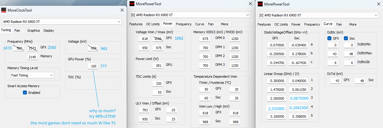

with the 1056mV and 1062mV-Setting you can try:
If LD3 0,087500mV is not enough in Games, then 0,090625mV, ... should be the same as default 0,089000
or 1/4 x 6.25mV more (I dont really believe, that 1/4 steps work, but 87,5mV+6,25/2 looks good)

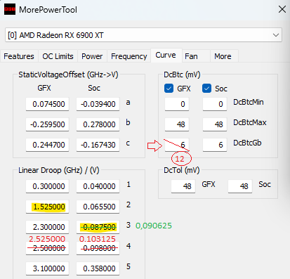

DcBtcGb 6mV-->12mV is a little bit slower, but safer
cra3khead schrieb:
This profile is slightly more stable than the previous 1056mv with the curve optimization, but it still crashes; this time in, like, 2-3 hours of gameplay rather than 1 hour. Don't know what could be causing that.
Could this help stabilize my 1050mv profile?
Probably not :(
