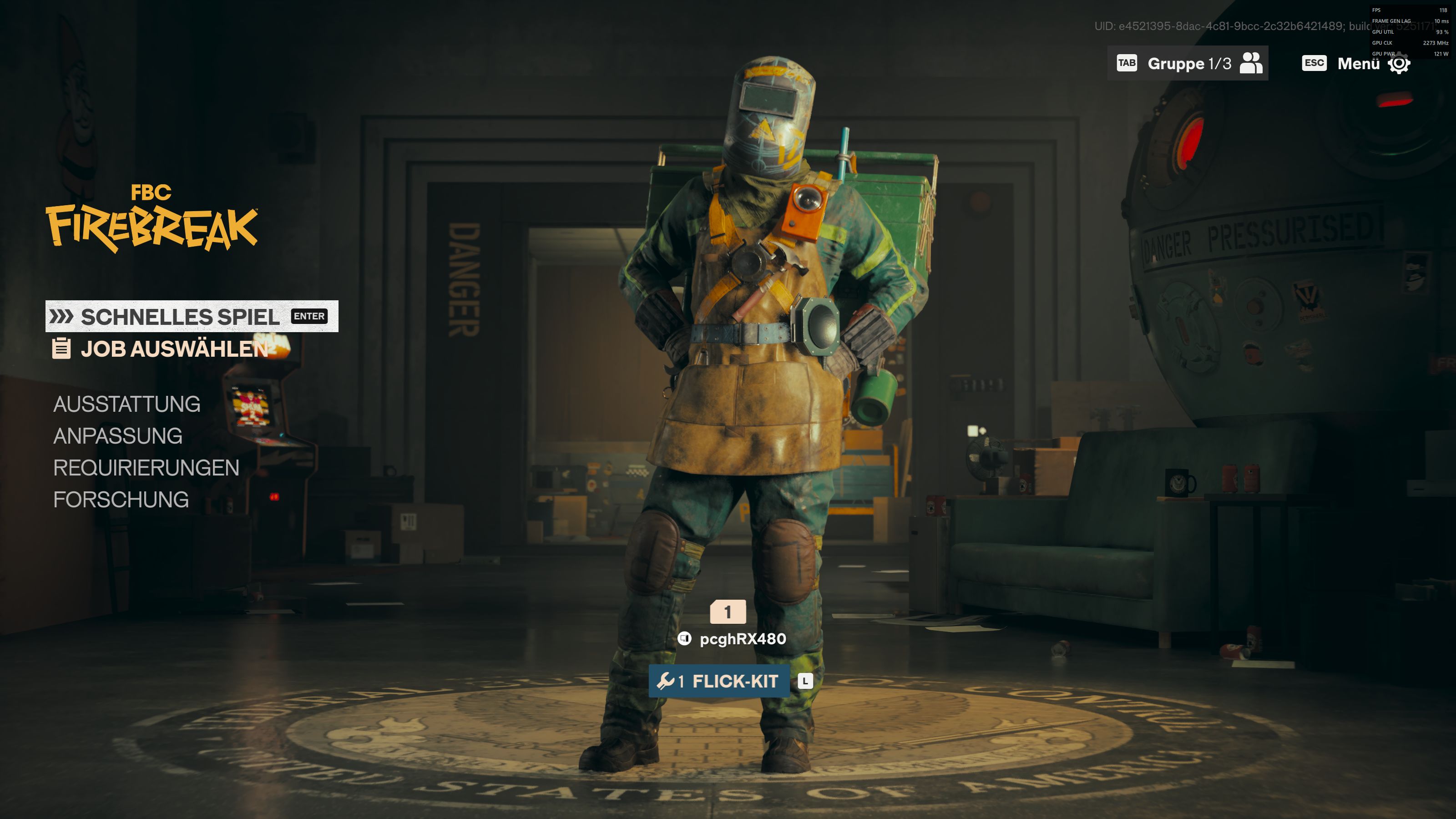

(x) for example
FBC Firebreak seems to boost higher then TS or SW!
--> I use a extra MCT setting with 10MHz less, like some other UE-Games.
maxClock 2323 results in eff. 2273MHz
1112mv wasn't stable. So far I have three settings locked down with the curve optimizations you've shown me.
2660@1125mpt + 1025mct = 2615MHz game clock (Power Limited in Metro Exodus EE) >315 watts
2640@1100mpt + 1000mct = 2590MHz game clock (Metro Exodus EE 303 watts)
2565@1050mpt + 950mct = 2520MHz game clock (Metro Exodus EE 280-290 watts)
