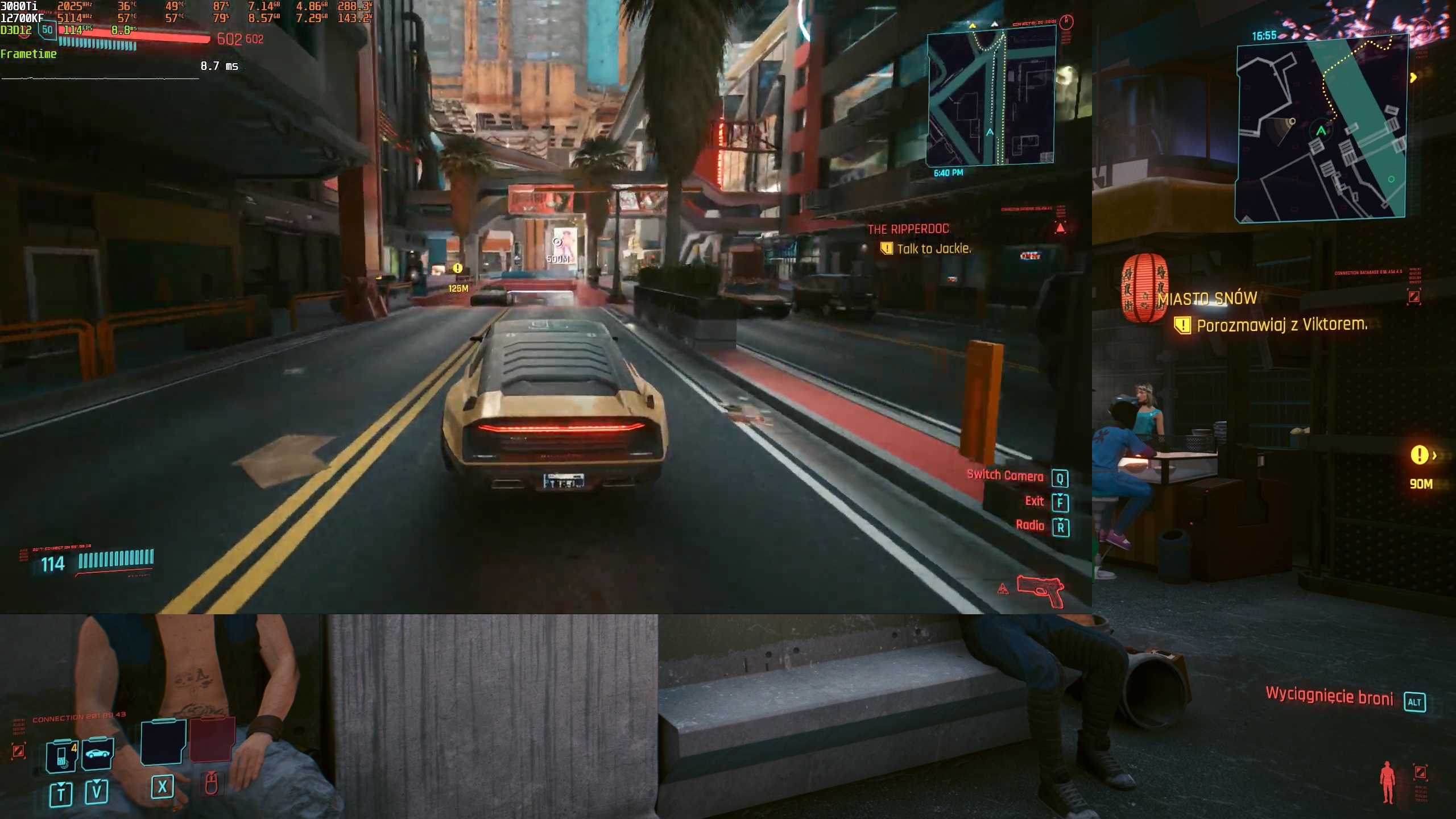

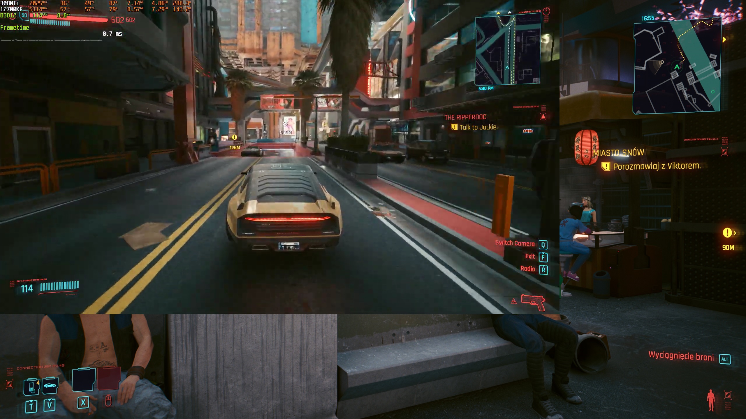

The guy in the video is also bottlenecked but he has the 13900k so thats why he has more FPS there. Cyberpunk is crazy demanding on the CPU side when maxed out with RT. I have a bottleneck during some areas too with the 13900k. Its normal.
But i go to 1080P + ULTRA PERFORMANCE DLSS,and my fps stay the same. 90-100fps in that scene.
gpu usage 55%. Screen:

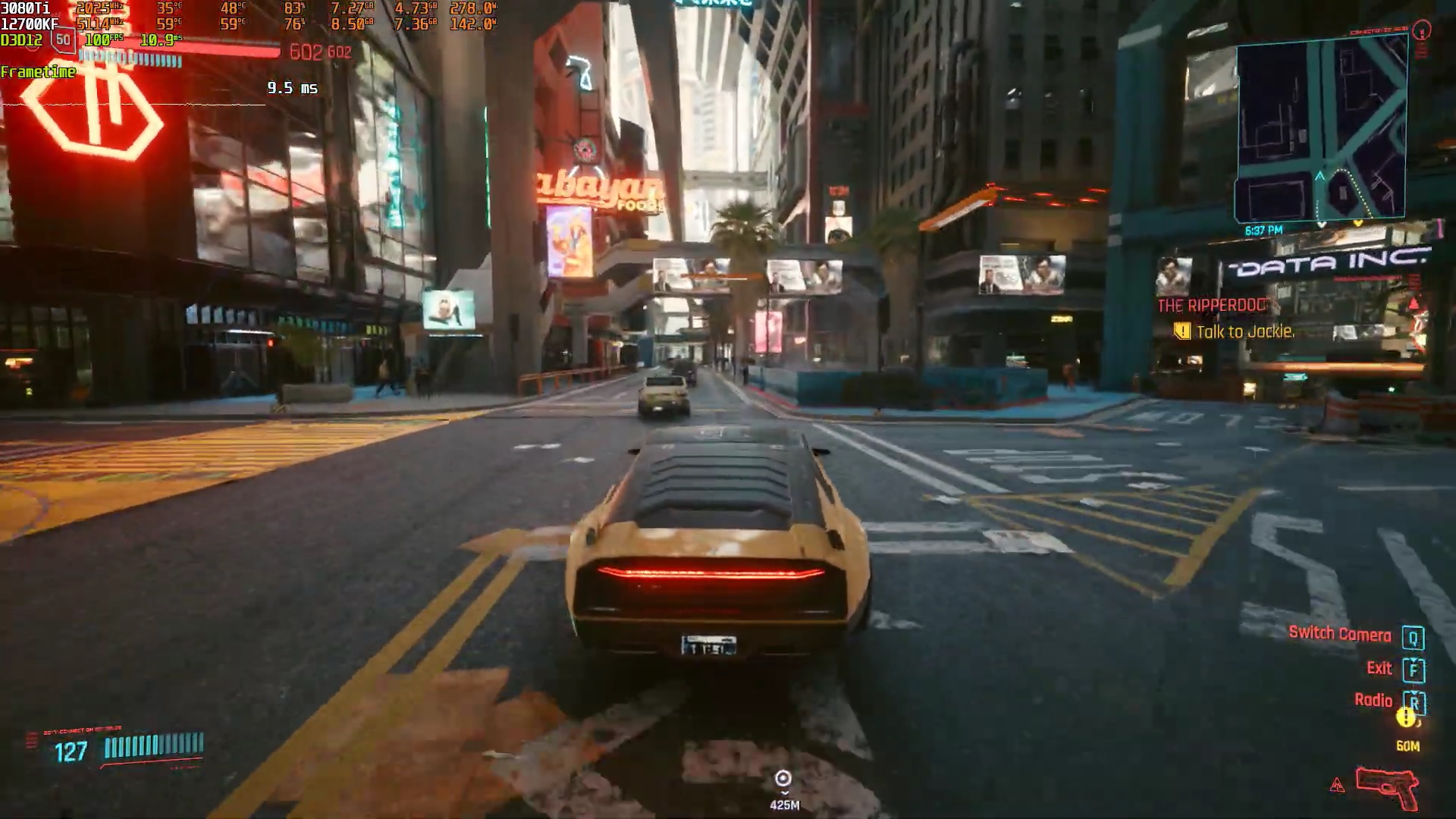

I compared with someone with 12700K ,3080 ti and he have here 110-120fps on the same settings. No bottleneck.
So why he have on the same place 110-120 fps and 80-90% usage? i have 90-100fps and gpu usage 50%
0:15 second
0:15 second
