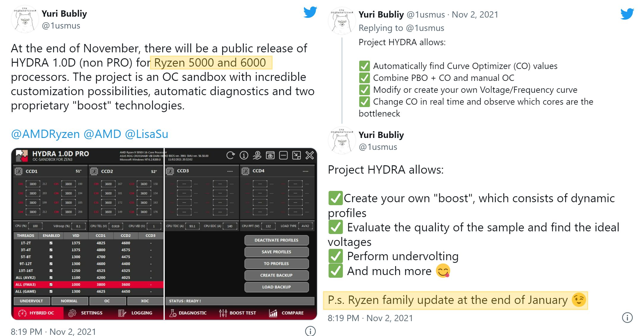

Project HYDRA coming soon
https://videocardz.com/newz/amd-ryz...is-coming-to-project-hydra-oc-tool-this-month
