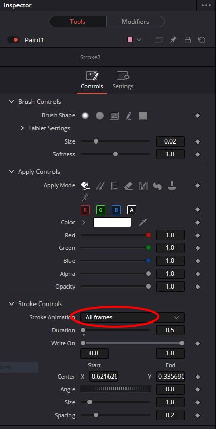

Was hast du hier ausgewählt?
Eventl. "Limited duration" ?

bei mir fehlt diese Option
(liegts an Resolve 15, free edition? )
mal das hier probieren:
Hi there,
You'll want to make sure to use the Stroke tool instead of the Multistroke tool which isn't the default when you start using the paint tool. Multistroke is for single frame painting while Stroke is for painting across multiple frames. In your paint controls, under Stroke Controls you'll see a setting for "Stroke animation" and you can set it to "Limited duration" and then set the "Duration" slider to the number you need.
You can also go to the Timeline tab to adjust the timing there once it's been set to Limited.
Hope that helps a bit.

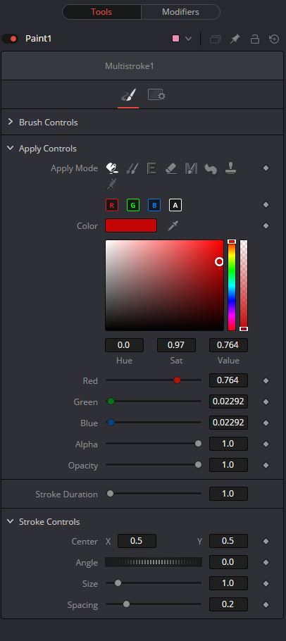

gefunden
@rw21 - dein Screenshot hat mich drauf gebracht..
standardmässig ist dieses Multistroke-Tool ausgewählt, was immer nur auf einen Frame schreibt
mit normalen "Stroke"-Tool gehts !
rot: multistroke
grün: stroke
