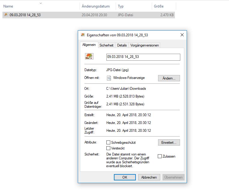

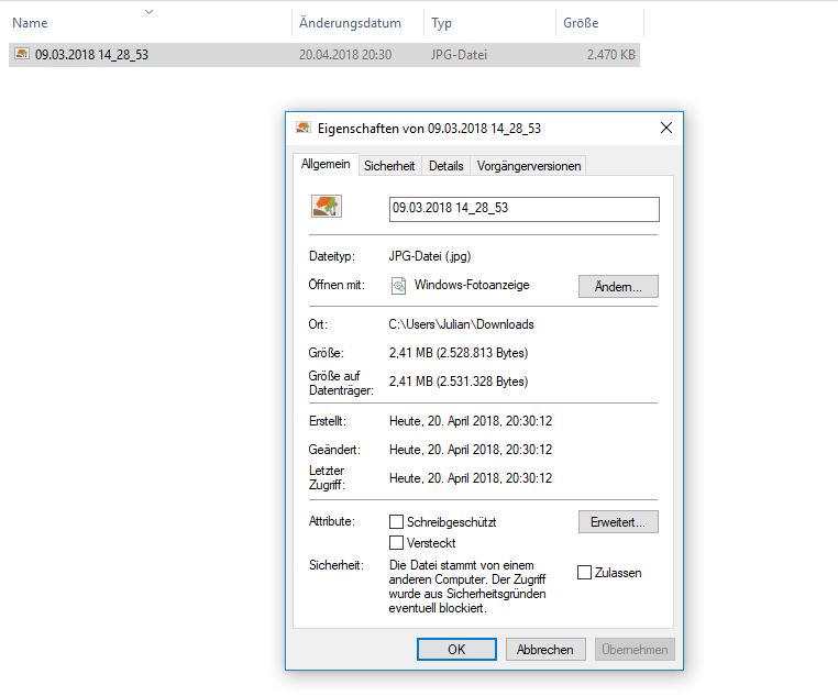

Auf Bild 1 heißt es, das Bild stammt von einem anderen Computer. Alle meine Bilder waren schon auf anderen PC (auch meine eigenen Geräten).

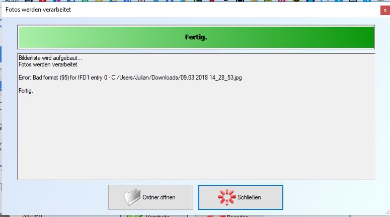

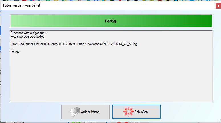

Exif Date Changer bringt nur eine Fehlermeldung, mit digiKam hats auch nicht geklappt und auch nicht via Terminal in Linux.

"Die datei stammt von einem anderen computer. der zugriff wurde aus sicherheitsgründen eventuell blockiert."
Die Stichworte sind Windows Attachment Execution Services (AES - Anlage-Manager), Zone.Identifier / Alternate Data Stream (ADS)
Alternate data streams (ADS)
Alternate data streams (ADS) schrieb:
Main article: Fork (file system)
Alternate data streams allow more than one data stream to be associated with a filename (a fork), using the format "filename:streamname" (e.g., "text.txt:extrastream").
NTFS Streams were introduced in Windows NT 3.1, to enable Services for Macintosh (SFM) to store resource forks. Although current versions of Windows Server no longer include SFM, third-party Apple Filing Protocol (AFP) products (such as GroupLogic's ExtremeZ-IP) still use this feature of the file system. Very small ADS (named "Zone.Identifier") are added by Internet Explorer and recently by other browsers to mark files downloaded from external sites as possibly unsafe to run; the local shell would then require user confirmation before opening them.[22] When the user indicates that they no longer want this confirmation dialog, this ADS is deleted.
Alternate streams are not listed in Windows Explorer, and their size is not included in the file's size. When the file is copied or moved to another file system without ADS support the user is warned that alternate data streams cannot be preserved. No such warning is typically provided if the file is attached to an e-mail, or uploaded to a website. Thus, using alternate streams for critical data may cause problems. Microsoft provides a tool called Streams[23] to view streams on a selected volume. Starting with Windows PowerShell 3.0, it is possible to manage ADS natively with six cmdlets: Add-Content, Clear-Content, Get-Content, Get-Item, Remove-Item, Set-Content.[24]
Malware has used alternate data streams to hide code.[25] As a result, malware scanners and other special tools now check for alternate data streams.
Heise.de: Sicherheitsmeldungen unterdrücken
Wird notepad 09.03.2018 14_28_53_preview.jpeg:Zone.Identifier in der Eingabeaufforderung ausgeführt, wird Notepad mit dem nachstehenden Text geöffnet:
[ZoneTransfer]
ZoneId=3

Also ich habe mit ExifTool (Terminal Kubuntu) versucht ein Datum rein zu schreiben. Geht nicht.
julian@asus:~/Downloads/z$ exiftool -AllDates='2018:03:09 14:28:53' *.jpg
Warning: [minor] Possibly incorrect maker notes offsets (fix by -416?) - 09.03.2018 14:28:53.jpg
Error: Bad format (95) for IFD1 entry 0 - 09.03.2018 14:28:53.jpg
0 image files updated
1 files weren't updated due to errors

Ein .jpg ist immer komprimiert. Du nutzt Linux? Entweder hast Du hast keine Berechtigungen, auf die Datei schreibend zuzugreifen. Oder ihr Format ist eben korrupt.
Um welches Datum geht es?
Kann das Aufnahmedatum und Erfassungsdatum ändern, nachdem ich den Zugriff zugelassen (Sicherheit: Zulassen) habe.
P.S.
Der Zone.Identifier wird beim Zulassen entfernt.

AW: Exif Daten lassen sich nicht ändern (jpg) [Bad Format (95)]
Anhang 676402
P.S.
Ich sortiere alle meine Bilder nach dem Zeitpunkt an dem sie gemacht wurden. Also wann ich auf den Auslöser gedrückt habe. Das wird wohl das Aufnahmedatum sein?!
Wie hast du den Zugriff zugelassen??
Ich habe ein paar Tausend Bilder und bei denen mache ich idr immer das gleiche (Bearbeiten - gleiche Programme etc). Aber das ist das einzige mit Problemen...
Zugriff zulassen:
  • Rechtsklick auf die Datei
  • Eigenschaften auswählen
  • In die Registerkarte "Allgemein" wechseln.
  • Unter "Sicherheit" das Markierungsfeld (Checkbox) "Zulassen" auswählen und die Schaltfläche (Button) Übernehmen anklicken oder den Dialog über Schaltfläche (Button) verlassen.
