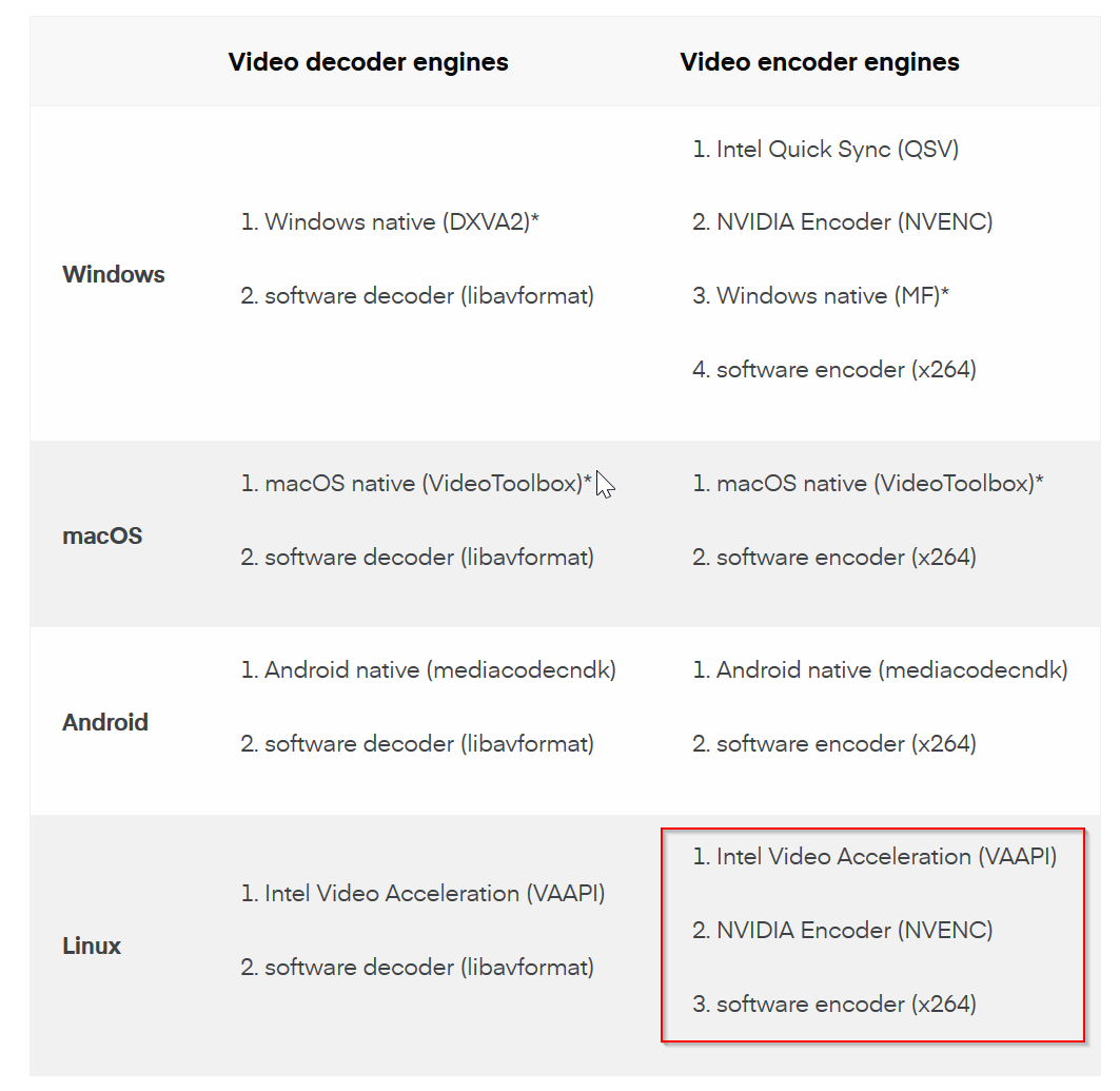

Wenn ich das hier alles gerade richtig verstanden habe, unterstützt Plex unter Linux überhaupt kein QuickSync. Hier wäre meine einzige Möglichkeit die 1050. Oder liege ich da falsch?benneque schrieb:Da müsste man jetzt mal bei Plex rumschauen, welche GPU mit welchen Codecs klarkommt
https://support.plex.tv/articles/115002178853-using-hardware-accelerated-streaming/
Steht sogar auf demselben Blatt
( https://support.plex.tv/articles/115002178853-using-hardware-accelerated-streaming/ )
Hardware-accelerated decoding
Video files with H.264 or HEVC video can take advantage of hardware-accelerated decoding. When hardware-accelerated decoding is not compatible with a video file, Plex Media Server will automatically use normal software decoding.
Plex Media Server uses hardware-accelerated H.264 encoding when available. When hardware-accelerated encoding is not available, Plex Media Server will automatically use normal software encoding.
Heißt wohl im Endeffekt: Intel GPU (oder AMD) mit Kaby Lake oder neuer für die größte Kompatibilität.
- On Linux, hardware-accelerated decoding is not supported on NVIDIA GPUs. Intel Quick Sync is required for hardware-accelerated decoding.
- Hardware-accelerated HEVC 8-bit decoding on Windows and Linux requires a 6th-generation Intel Core (Skylake, 2015) or newer.
- Hardware-accelerated HEVC 10-bit decoding on Windows and Linux requires a 7th-generation Intel Core (Kabylake, 2016) or newer.
- Hardware-accelerated HEVC decoding is not yet available on macOS.
- Some devices have additional limitations on hardware-accelerated video decoding. For example, limiting to a certain resolution (1080p or 4K), limiting frame rate, limiting video profile, or limiting chroma subsampling.
- Windows and Linux devices using Intel hardware-accelerated encoding do not have any artificial limit to the number of simultaneous videos.
- Windows and Linux devices using NVIDIA GeForce graphic cards are limited to hardware-accelerated encoding of 2 videos at a time. This is a driver limitation from NVIDIA.
- macOS is only capable of hardware-accelerated encoding of 1 video at a time. This is a platform limitation from Apple.
- macOS hardware-accelerated encoding is only available at 480p or higher. Lower resolutions will use normal software encoding.
- Some devices have additional limitations on hardware-accelerated video encoding. For example, limiting to a certain range of resolutions or limiting frame rate.

Also ist es insgesamt eigentlich vollkommen egal, ob er nun einen Ryzen 2600, Ryzen 2400G oder i3 8100 nimmt. Alle Varianten haben genug Power für die NAS Funktionalität und um mindestens einen Stream zu transkodieren.
Wenn man jetzt rein nach dem Preis geht, liegt man bei ca.:
i3 8100: 125 + 55 (Board) = 180€
2400G: 140 + 70 = 210€
2600: 150 + 70 = 220€
Der 2400G ist eigentlich nur interessant, weil man dann ein AMD System ohne extra Grafikkarte haben kann (spart vermutlich 5W Strom). Ansonsten in Sachen Preis / Leistung eher uninterresant.
Für den 2600 spricht die hohe CPU Leistung. Kostet aber eben auch am meisten. Und man muss eine Grafikkarte dazu packen.
Für den i3 8100 spricht der Preis und das GPU Transcoding. CPU Leistung auf dem Niveau des 2400G.
Laut dem Test hier ( https://www.computerbase.de/artikel...eite-3#abschnitt_effizienz_deutlich_gestiegen ) zieht der 2400G unter reiner CPU Last aber deutlich mehr aus der Steckdose als der i3 8100. Hätte ich jetzt gar nicht vermutet.
