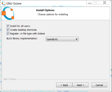

Windows-64 (recommended) Installer für 5.1.0: https://www.gnu.org/software/octave/#install
Installer Config (OpenBLAS ist wichtig, der Rest nicht):
788626

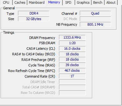

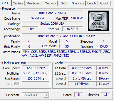

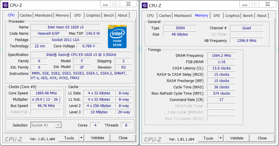

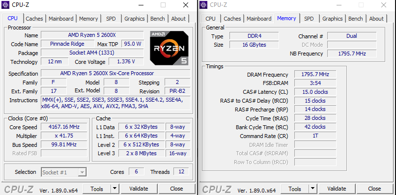

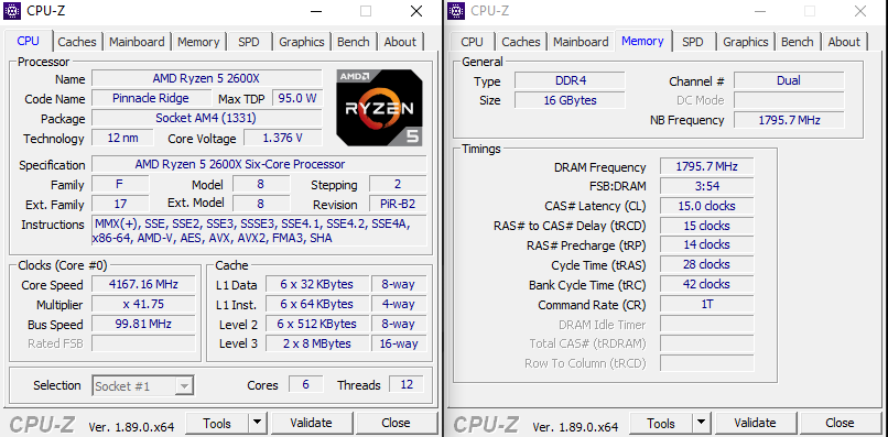

arch linux/kernel 5.1.6/octave 5.1.0/ryzen2600@stock
Execute test 1/20 - rand
1 2 3
Time 0.20
Normalized time 0.18
Execute test 2/20 - randn
1 2 3
Time 0.30
Normalized time 0.52
Execute test 3/20 - primes
1 2 3
Time 0.03
Normalized time 0.04
Execute test 4/20 - fft2
1 2 3
Time 0.11
Normalized time 0.05
Execute test 5/20 - square
1 2 3
Time 0.54
Normalized time 0.40
Execute test 6/20 - inv
1 2 3
Time 0.50
Normalized time 0.58
Execute test 7/20 - eig
1 2 3
Time 1.99
Normalized time 0.21
Execute test 8/20 - qr
1 2 3
Time 0.42
Normalized time 0.54
Execute test 9/20 - schur
1 2 3
Time 0.66
Normalized time 0.25
Execute test 10/20 - roots
1 2 3
Time 0.93
Normalized time 0.45
Execute test 11/20 - interp2
1 2 3
Time 0.77
Execute test 12/20 - binary
1 2 3
Time 0.07
Normalized time 0.15
Execute test 13/20 - forLoop
1 2 3
Time 8.66
Normalized time 144.33
Execute test 14/20 - makeSparse
1 2 3
Time 0.00
Normalized time 0.00
Execute test 15/20 - multiplySparse
1 2 3
Time 0.00
Execute test 16/20 - sLinearEq
1 2 3
Time 0.09
Execute test 17/20 - saveLoadMtx
1 2 3
Time 1.10
Normalized time 1.18
Execute test 18/20 - dlmwriteRead
1 2 3
Time 0.31
Normalized time 0.06
Execute test 19/20 - median
1 2 3
Time 0.22
Normalized time 0.07
Execute test 20/20 - std
1 2 3
Time 0.06
Normalized time 0.08
--- SUMMARY ---
Mean: geometric 0.156 , arithmetic 0.848
Min 0.000 , Max 8.660
Normalized Mean: geometric 0.125, arithmetic 7.464
Normalized Min 0.000 , Max 144.328
End of test. File results_5.1.0.txt was created.
ans =
scalar structure containing the fields:
norm_geometric_mean = 0.12490
norm_arithmetic_mean = 7.4639
norm_min = 0.00012164
norm_max = 144.33
edit: da kommt am ende ja eine result datei raus. vielleicht ist das übersichtlicher?
Code:
Name_5.1.0    Time    Norm_time
rand    0.200016    0.178586
randn    0.298913    0.515367
primes    0.027273    0.036855
fft2    0.108161    0.047439
square    0.538298    0.398739
inv    0.500455    0.575236
eig    1.992336    0.210829
qr    0.423238    0.535744
schur    0.657253    0.246162
roots    0.932860    0.448490
interp2    0.769972    0.183327
binary    0.074154    0.145400
forLoop    8.659668    144.327801
makeSparse    0.000060    0.000122
multiplySparse    0.000233    0.000237
sLinearEq    0.086527    0.044602
saveLoadMtx    1.096153    1.178659
dlmwriteRead    0.309574    0.061546
median    0.224569    0.067641
std    0.064012    0.076205
Geom_mean    0.155810    0.124895
Reaktionen: ZeroStrat

Sys ist ein Ryzen5 2600x@stock im mITX auf einem AsRock Fatal1ty X370 Gaming-ITX/ac mit 3600MHz DDR4 RAM auf Win10 1903
Der RAM zugriff scheint hier in der Tat keine Rolle zu spielen. Ergebnis ist praktisch identisch mit @0x8100 oben.
Morgen, bei Gelegenheit schieb ich noch die Workstation im Lab durch.

Naja, der Xeon E5 ist vom Hersteller nicht gerade auf maximale Single-Thread-Performance optimiert.
Der 9900K zeigt eine vergleichsweise langsame "forloop" Performance. For-Loops sind ja prädestiniert für die Branch-Prediction, ergo maximaler Leistungseinbruch mit Security-Patches.
Generell taktet ja fast jede CPU mittlerweise mit >4GHz Single Core Turbo und damit sind die Unterschiede nicht so groß.
ZeroStrat schrieb:
Irgendwie ist bei meinen Systemen der Wurm drin.
Die Werte sind speziell angepaßt für Ryzen 5 2400G . Für andere CPUs bitte nicht anwenden !
Code:
Windows Registry Editor Version 5.00
[HKEY_LOCAL_MACHINE\SYSTEM\CurrentControlSet\Control\Session Manager\Memory Management]
"SecondLevelDataCache"=dword:00000800
"ThirdLevelDataCache"=dword:00001000
Bitte z.B. als Text in eine z.B. "Neueintrag.reg" Datei speichern, danach doppelklicken und System neu starten.
Sollte es doch nix bringen, einfach die D-Word-Werte alle auf null setzen -> dword:00000000
und erneut eintragen.
Ansonsten hilft nur 1. und 4. Zeile aus meiner Signatur.
Soooo, und nun der 9900k ohne den störenden Virenscanner:
norm_geometric_mean = 0.071185
norm_arithmetic_mean = 6.6218
norm_min = 0.00014694
norm_max = 126.27
