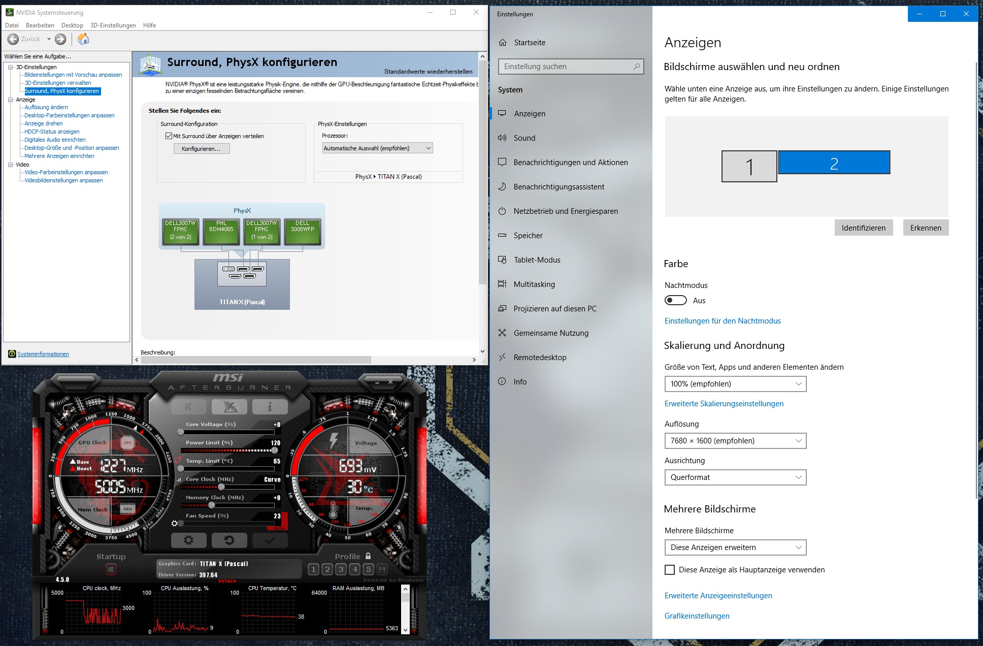

Sollte eigentlich gehen, max Auflösung bei ner 1070 im Surround ist 6480x3840 11520x2160 im Landscape Mode, ich hatte auch schon ein Quad-Surround am laufen, mit 2*16*10 und 2*16*9 Displays.
GeForce GTX 1080 Single-GPU With 2D Surround (Landscape)
Orientation: Landscape
Accessory Display: Yes, no additional GPU (if using 3 or less displays)
Maximum Resolution: 11520x2160
Maximum Resolution (Bezel Correction): 10240x1600
Maximum number of displays: 2-4 in Surround,1 Accessory Display when using 3 or less displays in Surround
Special Instructions:
Any connectors can be used to enable Surround.
Once Surround is enabled, users can use any connector for the Accessory Display.
Max of 4 displays can be used simultaneously (3 if monitors are 4K)
G-SYNC and regular monitors can be mixed in Surround; effects of G-SYNC will only be seen on G-SYNC- enabled monitors
