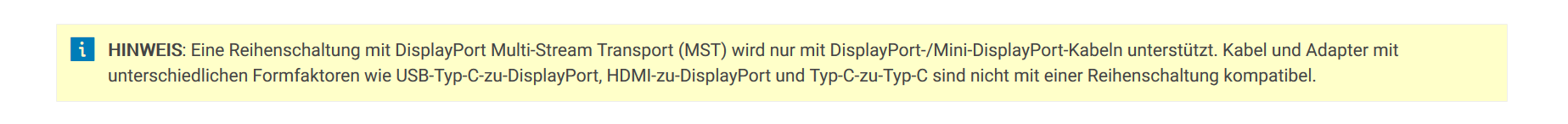

zumindest bei Dell ...
https://www.dell.com/support/articl...isplayport-multi-stream-transport-mst?lang=de
