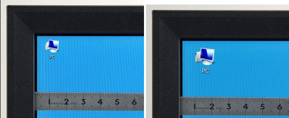

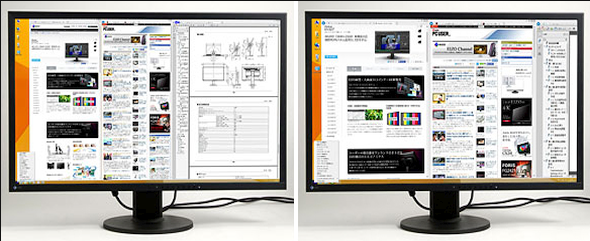

Links 3840 x 2160, 140 PPI bei 100% und rechts mit 150%
This is an example of screen display on the FlexScan EV3237 desktop. At 100% magnification, the 3840 x 2160 pixel UHD 4K resolution can be fully utilized, but the pixel density is around 140 ppi, and the pixel pitch is about 0.18 mm, so it appears quite tiny from the normal viewing distance (left). When magnification is set to 150%, the work space becomes smaller, but the visibility of the text and icons is improved (right).
[Quelle: Confused about HiDPI and Retina display? ― Understanding pixel density in the age of 4K | Eizo]
