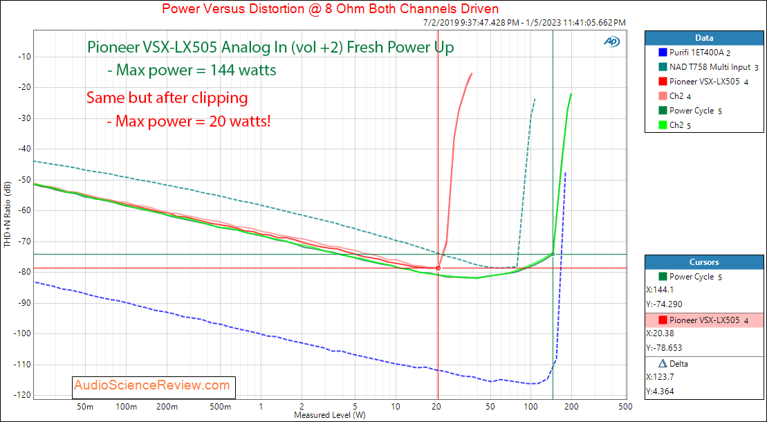

Der Pioneer hat keine abgespeckte Dirac Version, die sparen an den Endstufen, das finde ich schlechter als wenn es nur eine abgespeckte Dirac Version wäre.
https://www.audiosciencereview.com/forum/index.php?threads/pioneer-vsx-lx505-avr-review.40731/
Zitat:
"The unit is rated at 120 watts and I was just getting 20 watts! No amount of reading the manual and searching showed any kind of "eco mode" that would limit power. After trying many things I remembered the same issue in other Pioneer AVRs such as VSX-LX303."
Zitat:
"This is a total fail in my book. An amplifier rated for 120 watts should be able to produce that dynamically without pulling back by a factor of 5. To have a timer of sort to reduce power is just wrong, especially since no notice is given to the customer either in the unit, or sales material."
Grüße Tomi
P.S.: Das angehangene Bild ist auch aus dem Link: https://www.audiosciencereview.com/forum/index.php?threads/pioneer-vsx-lx505-avr-review.40731/
Grüße Tomi
