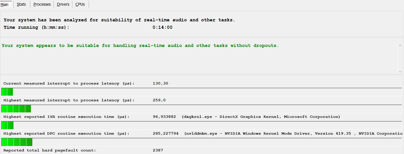

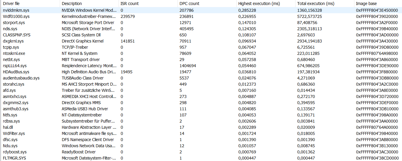

Hier sind die Stats die von Latencymon ausgepuckt wurden. Habe den PC ganz normal weitergenutzt und konnte mehrmals ein knacken feststellen.
[B][B][B][B][B][B][B]_[/B][/B][/B][/B][/B][/B][/B]
CONCLUSION
Your system appears to be suitable for handling real-time audio and other tasks without dropouts.
LatencyMon has been analyzing your system for 0:14:00 (h🇲🇲ss) on all processors.

MEASURED INTERRUPT TO USER PROCESS LATENCIES
The interrupt to process latency reflects the measured interval that a usermode process needed to respond to a hardware request from the moment the interrupt service routine started execution. This includes the scheduling and execution of a DPC routine, the signaling of an event and the waking up of a usermode thread from an idle wait state in response to that event.
Highest measured interrupt to process latency (µs): 259,0
Average measured interrupt to process latency (µs): 2,054974
Highest measured interrupt to DPC latency (µs): 254,80
Average measured interrupt to DPC latency (µs): 0,664391

REPORTED DPCs
DPC routines are part of the interrupt servicing dispatch mechanism and disable the possibility for a process to utilize the CPU while it is interrupted until the DPC has finished execution.
Highest DPC routine execution time (µs): 285,227794
Driver with highest DPC routine execution time: nvlddmkm.sys - NVIDIA Windows Kernel Mode Driver, Version 419.35 , NVIDIA Corporation
Highest reported total DPC routine time (%): 0,083143
Driver with highest DPC total execution time: Wdf01000.sys - Kernelmodustreiber-Frameworklaufzeit, Microsoft Corporation
Total time spent in DPCs (%) 0,162702
DPC count (execution time <250 µs): 2445295
DPC count (execution time 250-500 µs): 0
DPC count (execution time 500-999 µs): 6
DPC count (execution time 1000-1999 µs): 0
DPC count (execution time 2000-3999 µs): 0
DPC count (execution time >=4000 µs): 0

Gut, dann gehen wir in ne ganz andere Richtung: Hast du das Kabel schonmal getauscht gegen was hochwertigeres?
