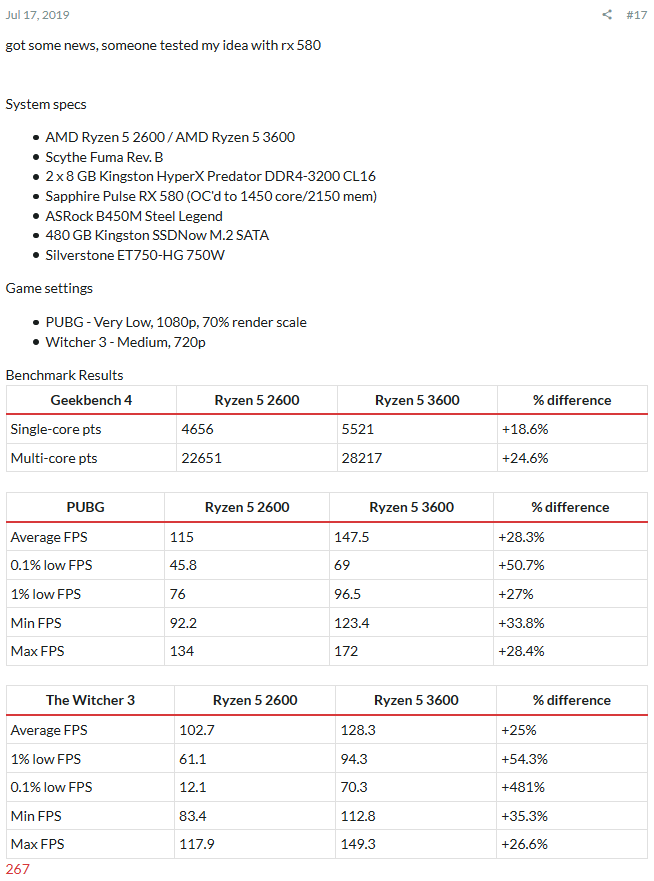

edit --- uff wenn das stimmt (siehe Bild) würde sich das doch lohnen. ne 2070super ist auch in mienem system
oh ok der nächste user hat etwas wind aus dem Segel genommen.. abwarten und das Thema weiter verfolgen
Keep in mind that testing at low settings at 1080p with 70% render scale (or medium settings at 720p) creates an artificial situation with the RX 580 where you're likely highly CPU-bottlenecked, exaggerating the differences between CPUs. If you were to run at 1080p (100% render scale) at high-ish settings, as I would expect most people would do with an RX 580, I imagine differences would be much smaller.
Your best bet is probably to look at reviews of the 2600 and see if it achieves the framerates you desire in the games you want to play. If it does, it should be fine. If the 3600 is theoretically capable of 15% higher FPS, but you're not going to see it because you're limited by your GPU and/or your monitor refresh rate, is it really important?
