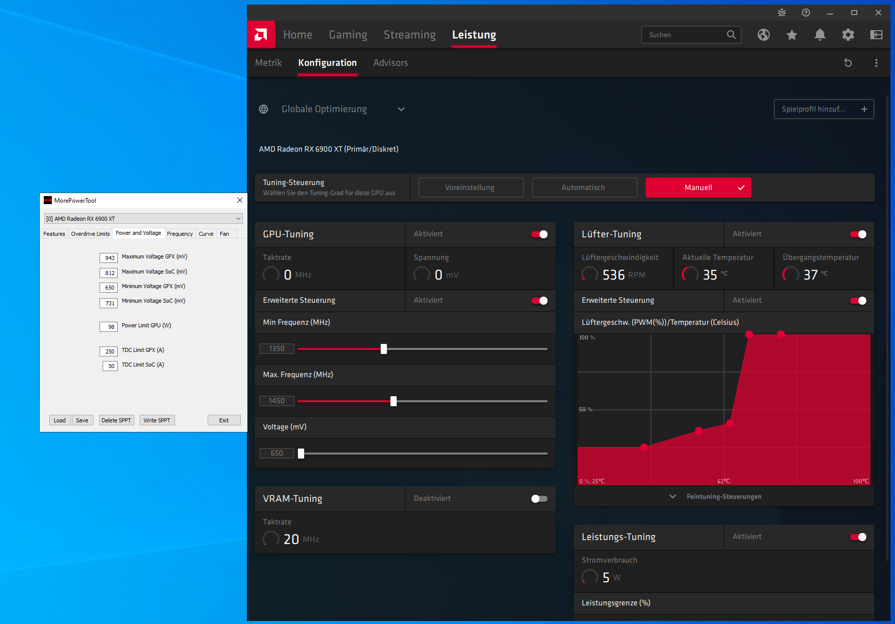

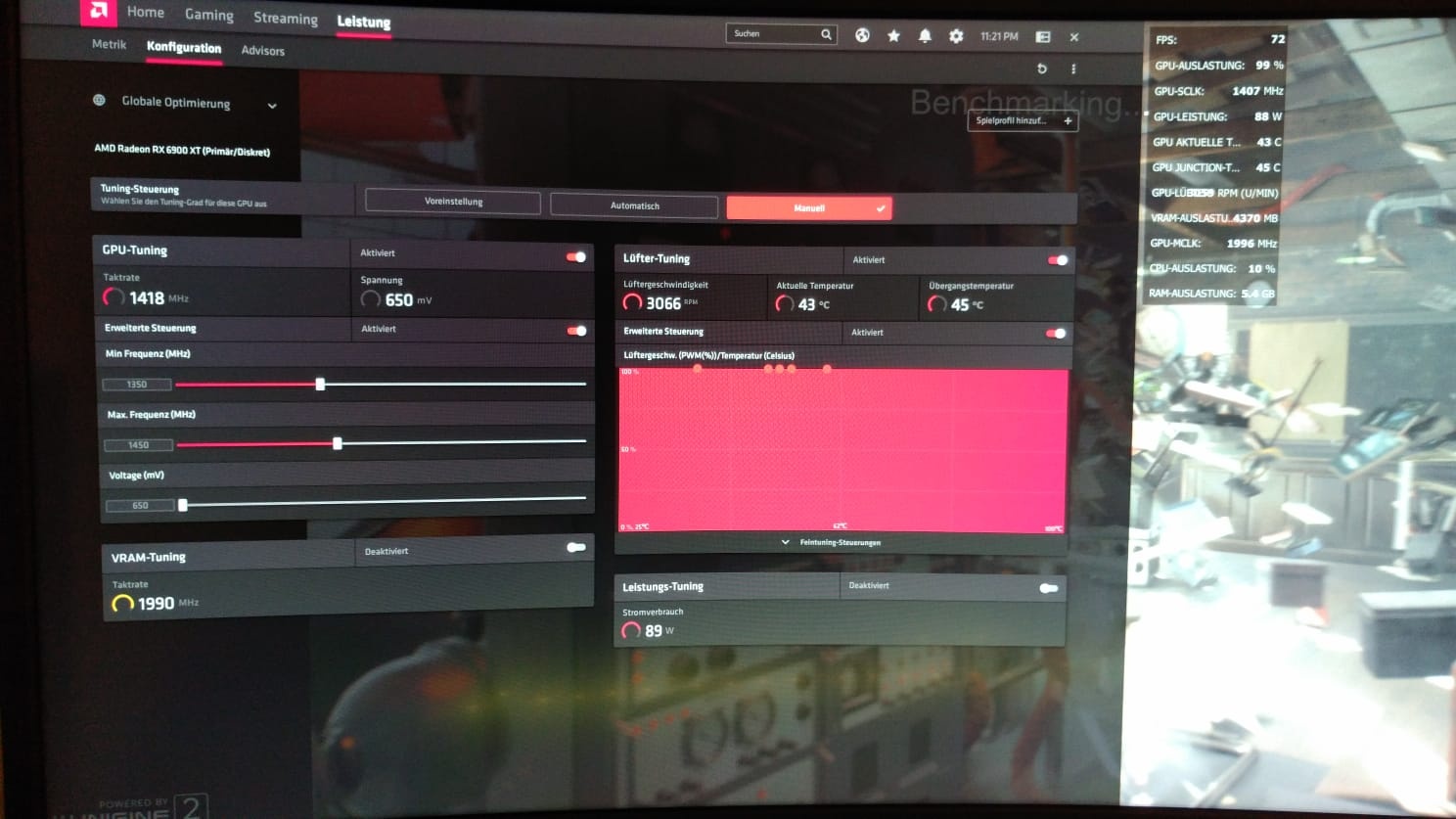

Also würdest du sagen das meine Grafikkarte keinen Defekt hat?Duvar schrieb:Schrott. Leute traut euch an das More Power Tool ran. Diese krass niedrigen Spannungen im Wattman bekommst du nur durch das Tool.
Ich habe aus einem Testbericht folgende Aussage gefunden:
"Memory seemed easy enough to max out, and cranking the power slider to maximum as well doesn't generally pose any problems. That leaves the GPU clock, voltage, and fan speeds, the latter of which we tuned to favor cooler temperatures over quieter operation. We set the RAM to 2150 MHz, dropped the GPU voltage to 1125 mV (down from 1175 mV), and set about testing.
We started by looping the Unigine Heaven 4.0 benchmark in a window at 1440p extreme, then bumped up the GPU clock to 2600 MHz to check for stability. We found that the power limit becomes a factor long before the maximum boost clock comes into play. With a 115 percent power limit in place, that gives the GPU up to 345W of power, and that's pretty close to where it landed. Clock speeds then fluctuate according to the demands of whatever game or workload is running, with average clocks in the 2400-2550 MHz range.
While Heaven proved stable in our initial tests, we did encounter some issues in a few other games, which eventually led to the slightly revised overclocks you can see above. We dropped the RAM 10 MHz to 2140, bumped the voltage back to 1150 mV, and that seemed to fix the problems. Additional time spent tuning might eke out a few more MHz, but for most users, simply enabling Rage Mode would do most of the dirty work — or set the RAM speed to 2100 and max out the power slider for a slightly higher result."
Link: https://www.tomshardware.com/news/amd-radeon-rx-6900-xt-review
Der Tester hat es auch nur mit dem Wattman gemacht, aber seine läuft wenigstens bei 1150mV stabil. Meine bekommt da schon Grafikfehler und bei 1120mV Crasht die instant, zumindest bei Metro Last Light.
Ich kann den Chip auch ohne Probleme über den Wattman mit 0,8x oder 0,9x Volt laufen lassen. Hilft nur nichts, wenn er es nicht mitmacht. Wenn ich mit dem MPT die Limits ändere, verschiebt das nur die Spannungskurven in die ein oder andere Richtung. Im Endergebnis kann ich mit beidem mehr oder weniger das gleiche erreichen (real anliegender Takt + Spannung verglichen). Im MPT kommt man aber natürlich noch an einige andere sonst nicht offenliegende Optionen, vor allem bei der Lüftersteuerung, weshalb ich da schon auch ein Profil laufen habe.Duvar schrieb:Schrott. Leute traut euch an das More Power Tool ran. Diese krass niedrigen Spannungen im Wattman bekommst du nur durch das Tool.
Ob der alte Treiber was ändert, werde ich mal testen.
Duvar
- Juli 2015
- 1.040

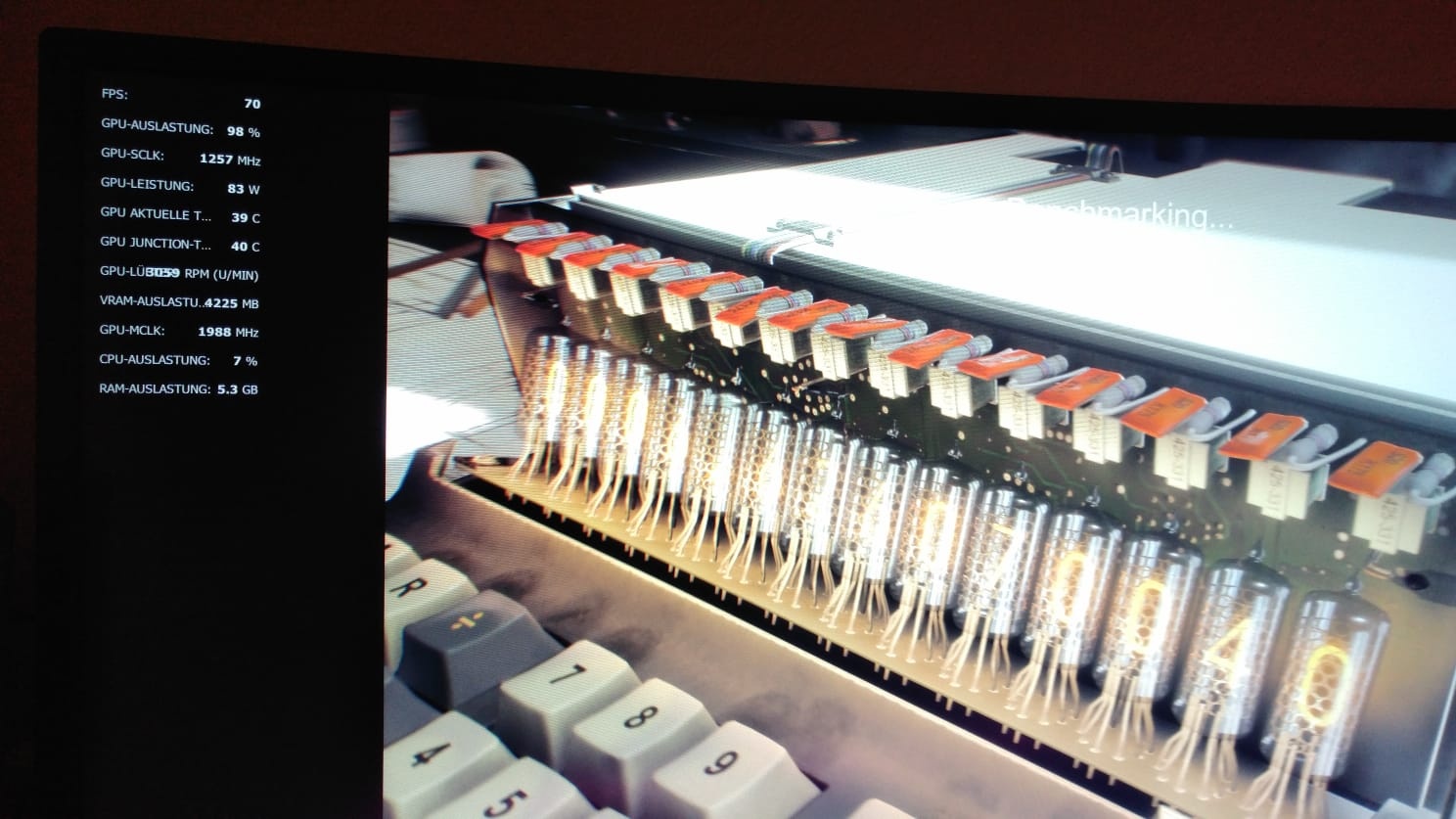

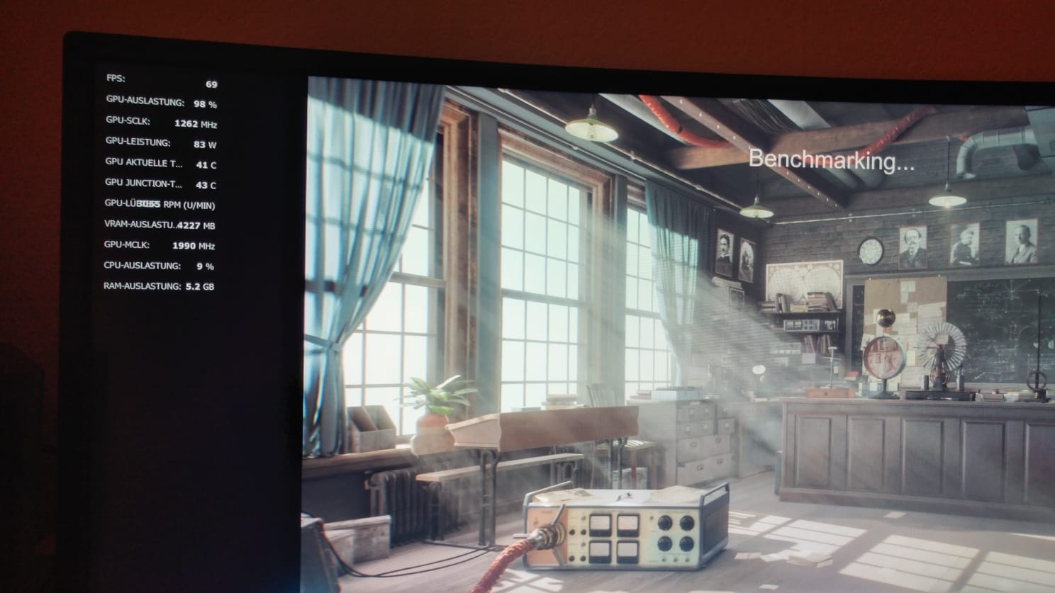

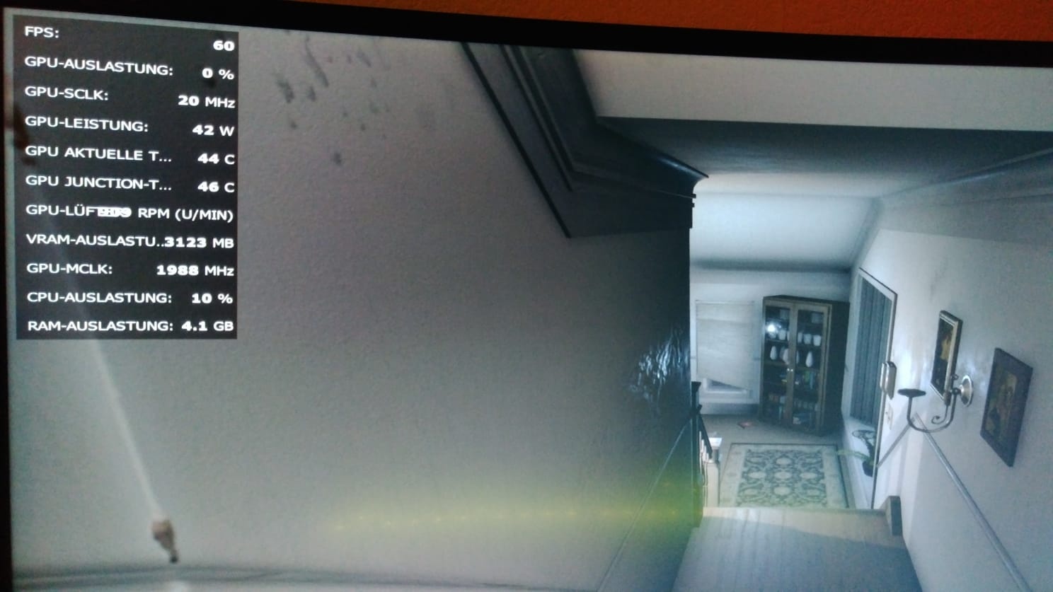

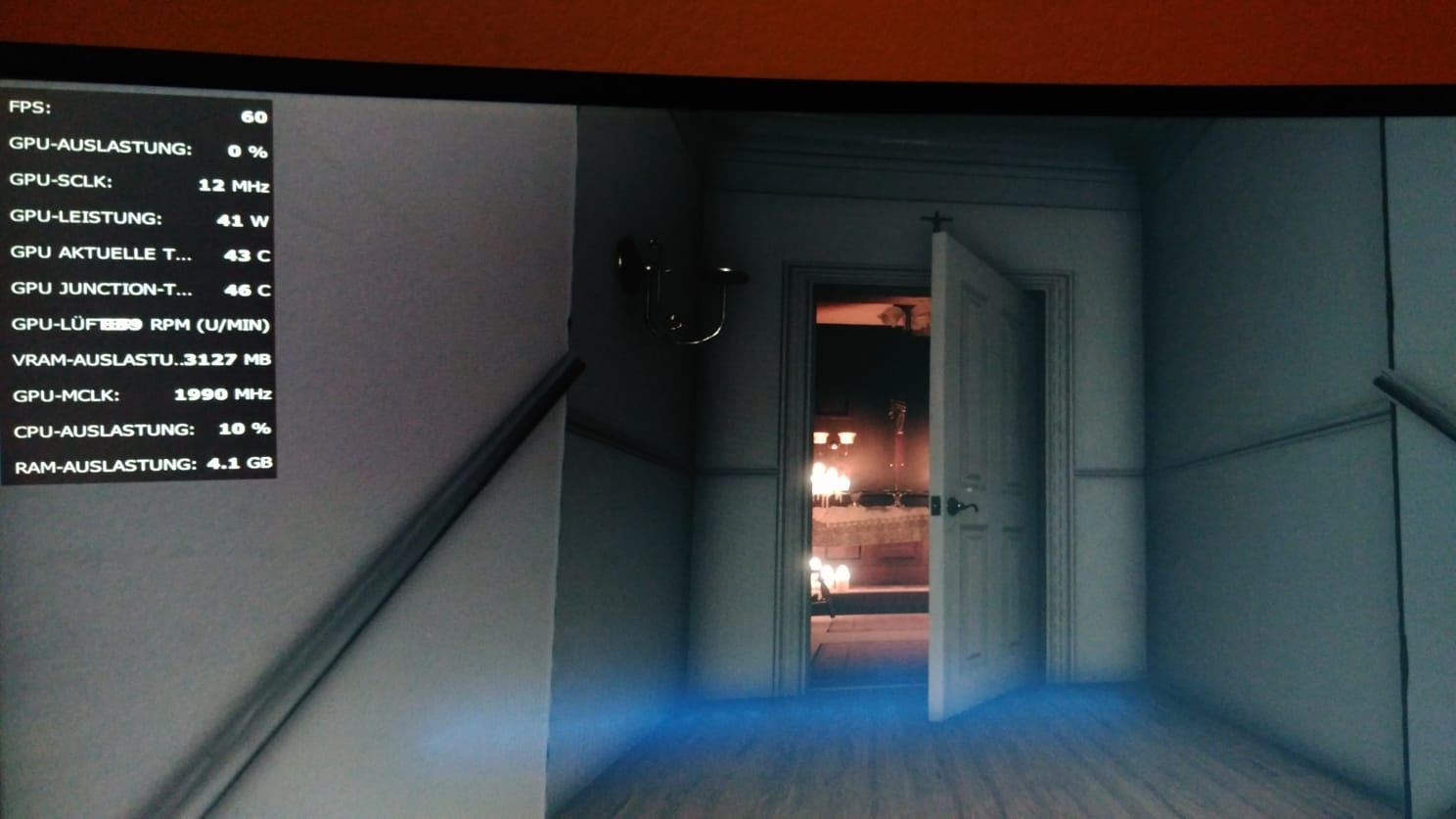

Kannst du dann bitte mal zeigen wie du mit dem Wattman in einem Game mit max Settings (hier Visage 1080p) 60 FPS mit ~40W TGP realisieren kannst?Enurian schrieb:Ich kann den Chip auch ohne Probleme über den Wattman mit 0,8x oder 0,9x Volt laufen lassen. Hilft nur nichts, wenn er es nicht mitmacht. Wenn ich mit dem MPT die Limits ändere, verschiebt das nur die Spannungskurven in die ein oder andere Richtung. Im Endergebnis kann ich mit beidem mehr oder weniger das gleiche erreichen (real anliegender Takt + Spannung verglichen). Im MPT kommt man aber natürlich noch an einige andere sonst nicht offenliegende Optionen, vor allem bei der Lüftersteuerung, weshalb ich da schon auch ein Profil laufen habe.
Duvar
- Juli 2015
- 1.040

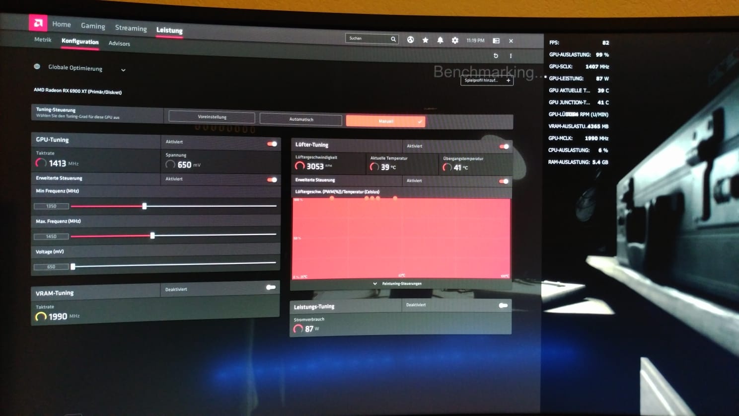

Hier paar weitere Pics in deutlich stärker fordernden Benches:Melchior schrieb:@Duvar
Sicher Anzeigefehler, nach Laden eines neuen Abschnitts. GPU Last 0%. Danach hochgesprungen.
Kenne ich auch
Musst bedenken, die Benches fordern mehr + ich hab da nicht die FPS auf 60 limitiert wie in dem Game. Rest kannst du dir selber ausrechnen. Der Treiber kam einfach nicht mehr klar auf dem krassen UV
