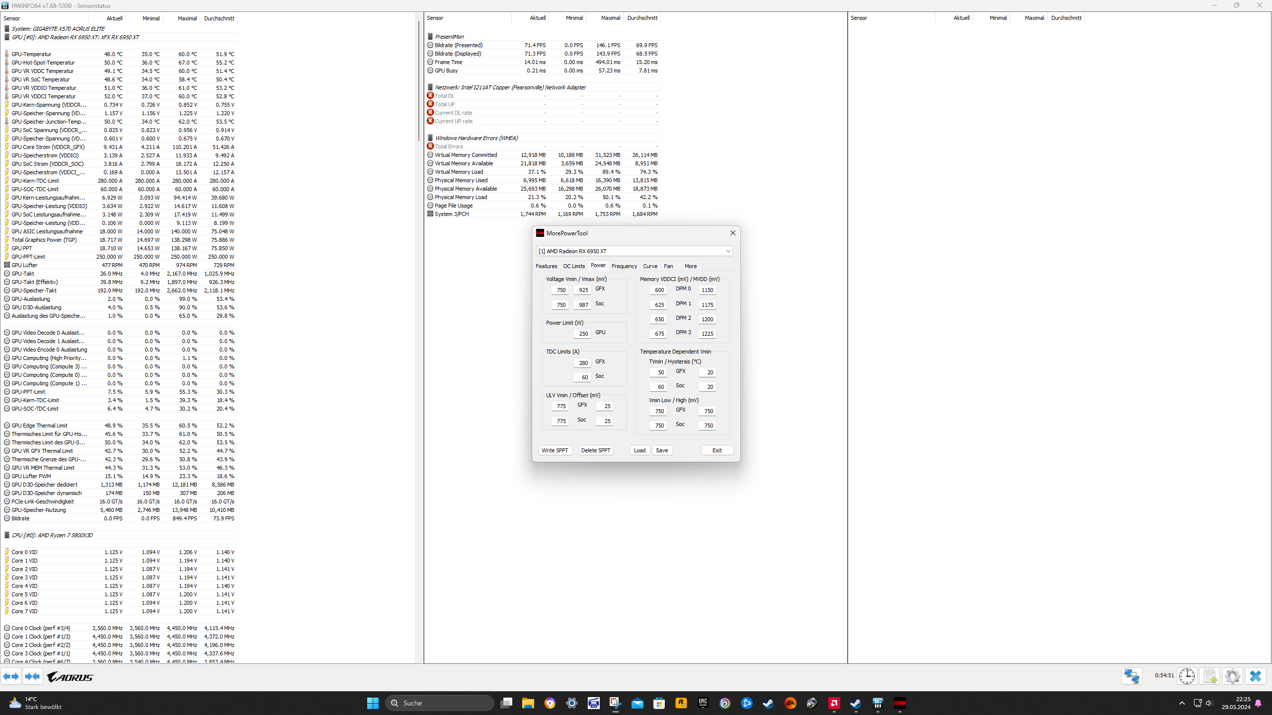

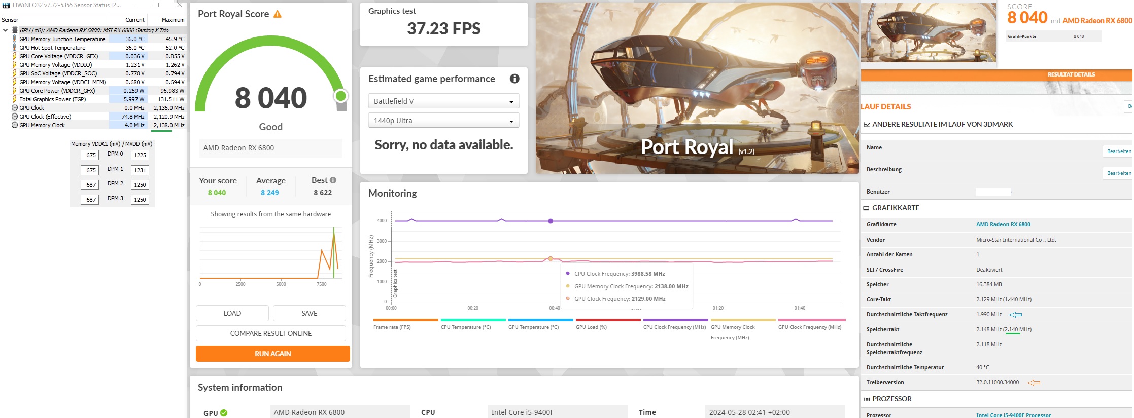

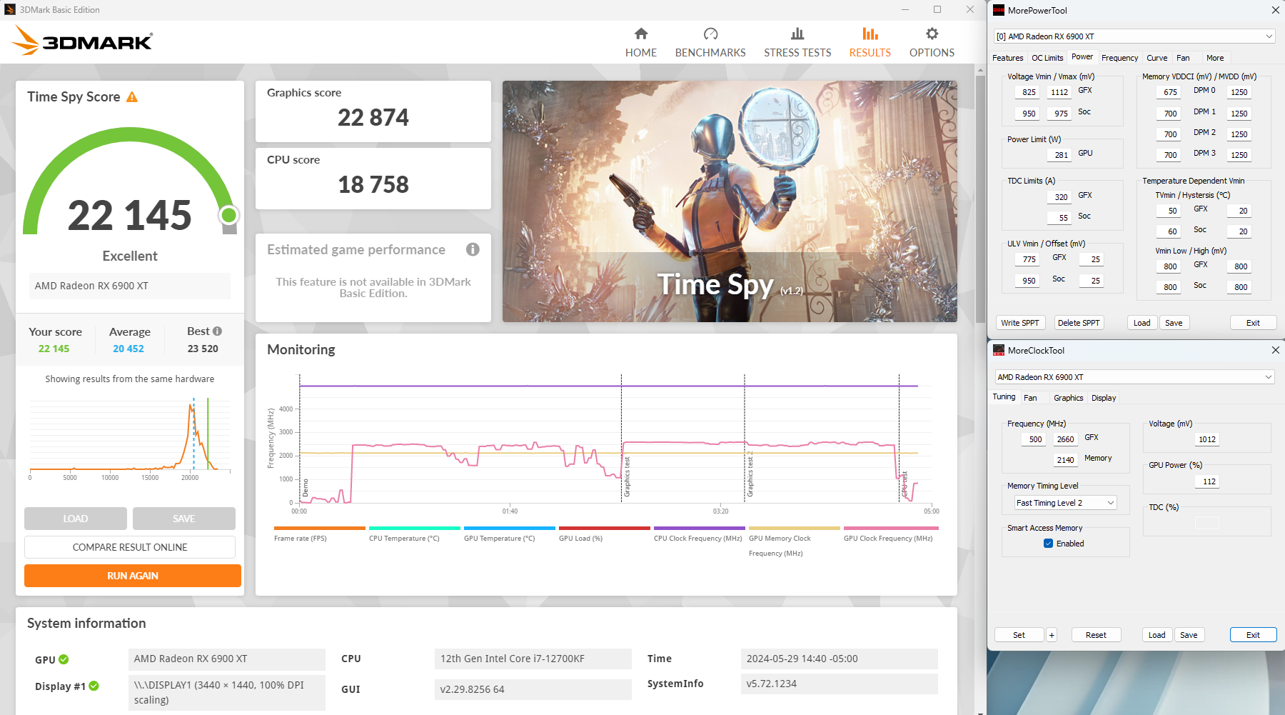

second test with less volts works also, nice surprise, THANKS

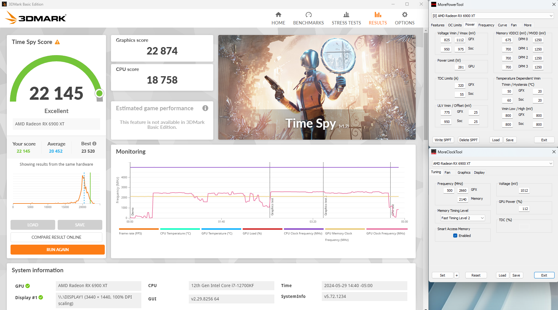

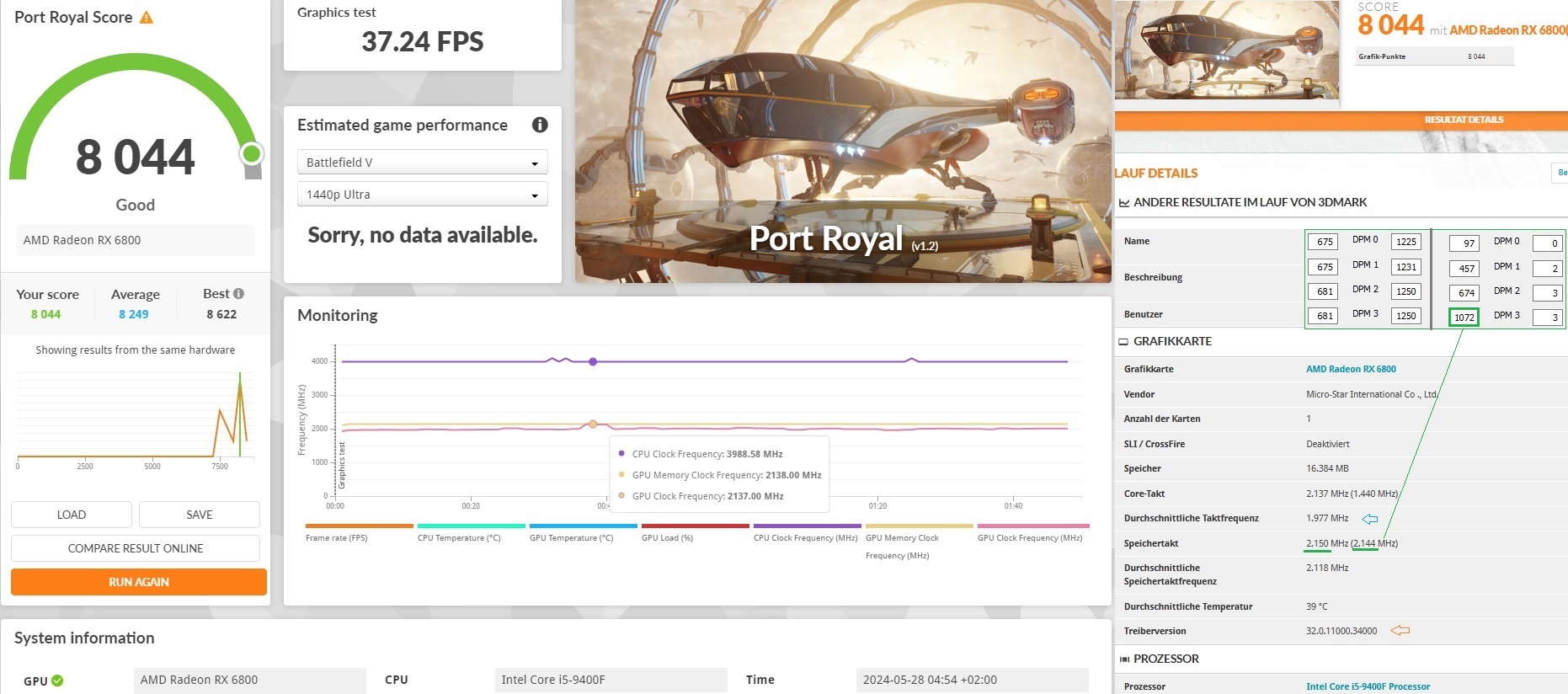

I'm surprised it allows your card to jump from 2056 FT1 all the way to 2140+ FT2 and provides me with a free 100 3DMark points. Weird ass MPT trickGerryB schrieb:second test with less volts works also, nice surprise, THANKS

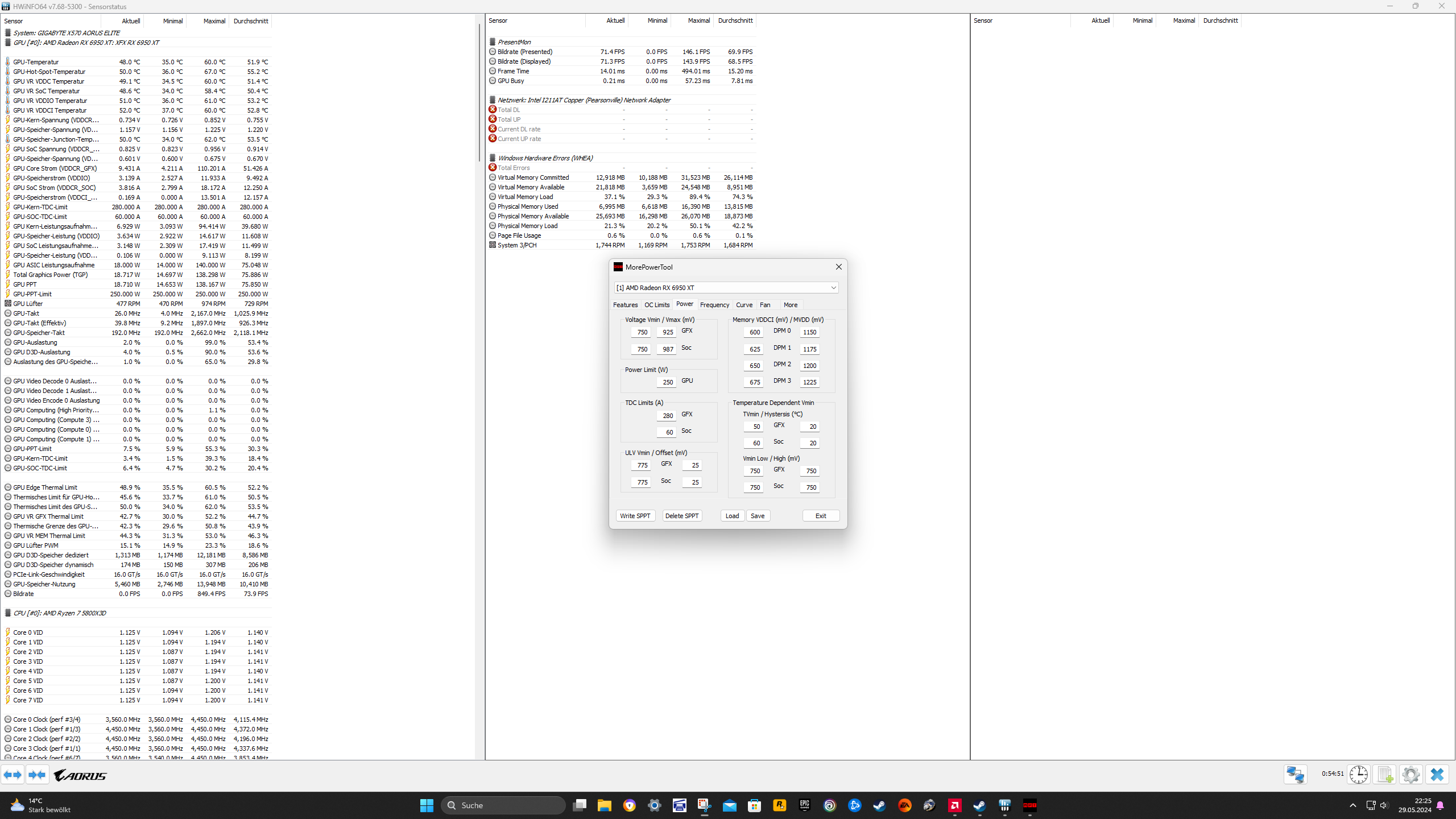

From what I recall upon first discovering the FT2 trick, the vram speed and voltage have a sweet spot (more finicky than usual), and if they aren't complementary, performance can drop by a significant amount.GerryB schrieb:OK, last little change VDDCI =681 works also.
For example, when doing 2150 FT2 at 675/1250mv, I had worse or the same performance as the default; if I wanted to use less than 1300mv, I would have to raise VDDCI above 875mv, or something along those lines. I forget the actual values.

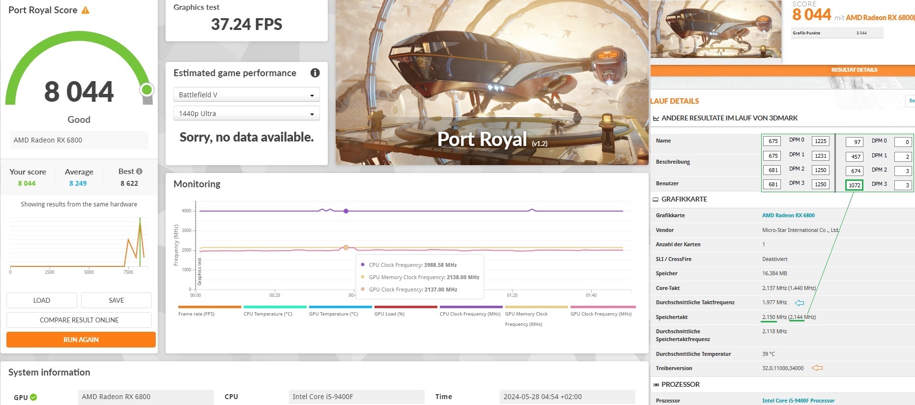

Even at 315 watts, I can't hit 23k points

wait and buy a cheap full versioncra3khead schrieb:Even at 315 watts, I can't hit 23k points![]()
https://www.allkeyshop.com/blog/buy-3dmark-cd-key-compare-prices/#
without demo it runs cooler
and

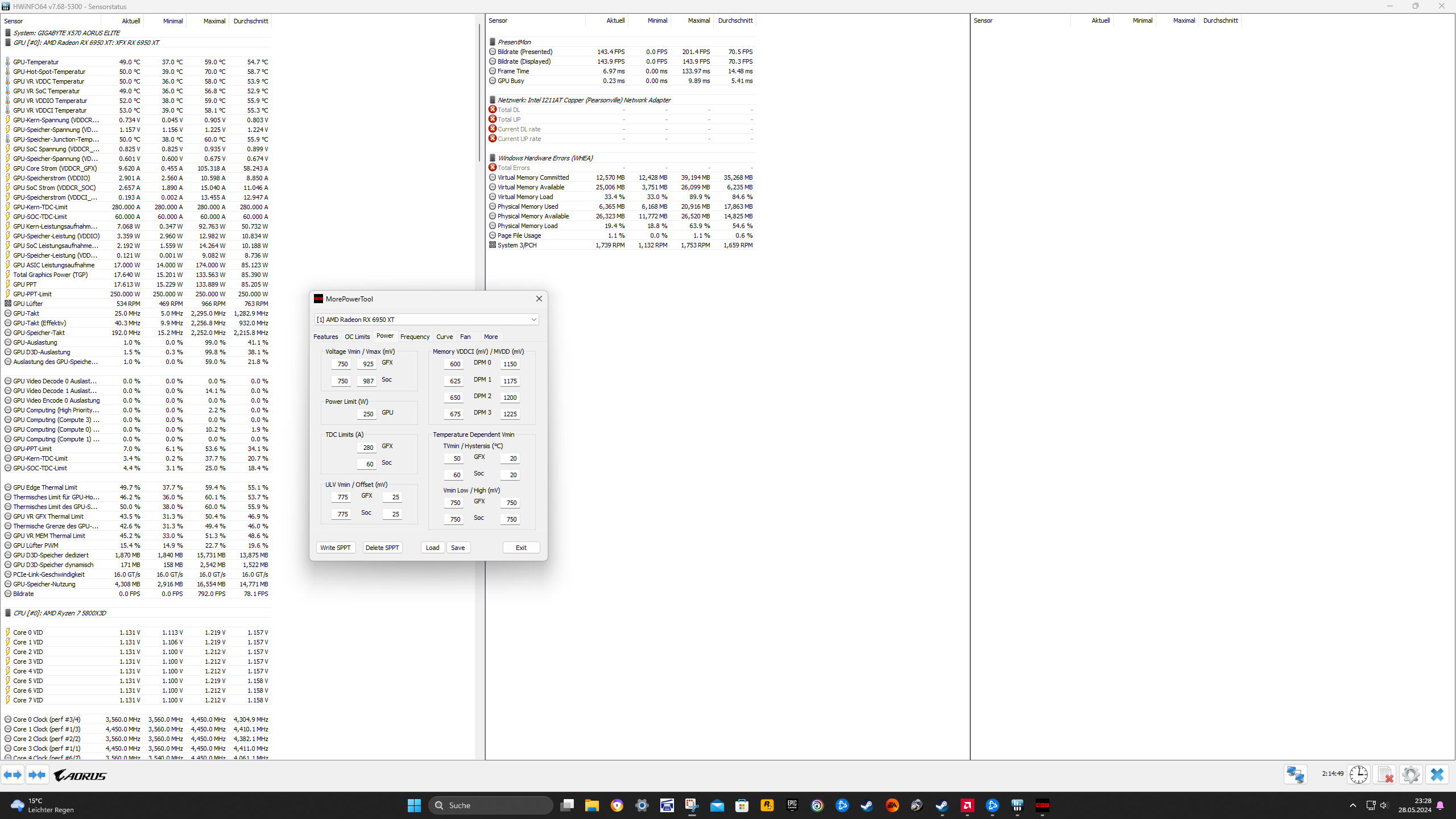

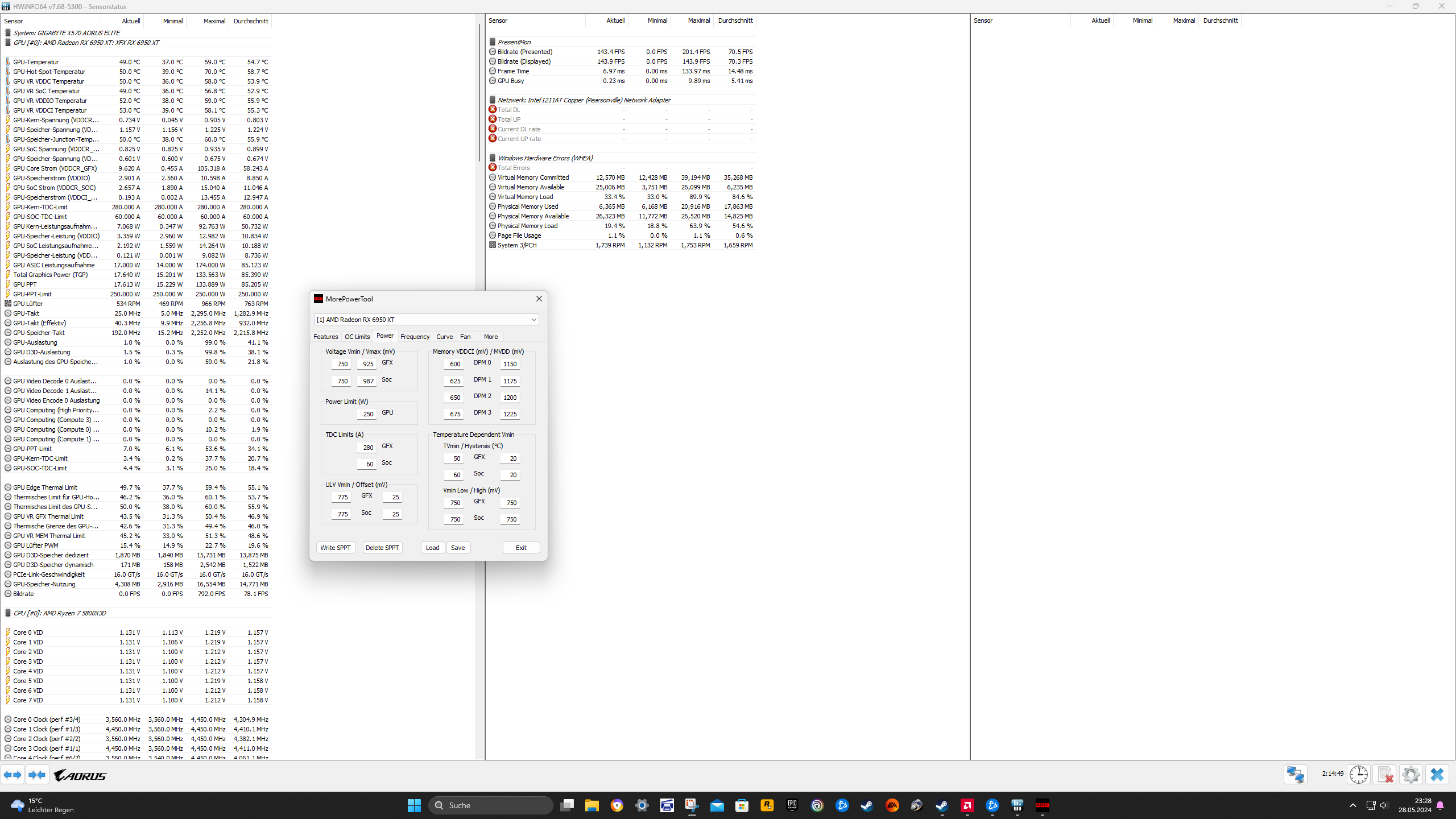

try DPM3=1072 with MCT-Vram 2150 ... 2148MHz
works, if the Vram is cool enough, ... VDDCI = 693mV should be enough
today I tested 687mV, mostly 2150MHz is fine, only some Benchmarks spikes a little bit, then 2148MHz
I'm not even sure if 2140 FT2 is stable on my card yet; I don't know if I'm getting an occasional artifact in ME or if it's just a texture glitch.GerryB schrieb:try DPM3=1072 with MCT-Vram 2150 ... 2148MHz
today I tested 687mV, mostly 2150MHz is fine, only some Benchmarks spikes a liitle bit, then 2148MHz

Are you able to use FT2 24/7 for gaming? Unfortunately, it's not stable on my system; it may require quite a bit more voltage for stability, but I don't think that's worth it.GerryB schrieb:today I tested 687mV, mostly 2150MHz is fine, only some Benchmarks spikes a little bit, then 2148MHz
GerryB
Rear Admiral
- Sep. 2016
- 5.715
not yet so much tested, but seems to workcra3khead schrieb:Are you able to use FT2 24/7 for gaming?
may be 2150-->2148 if not stable
