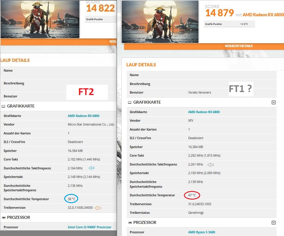

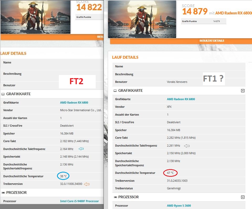

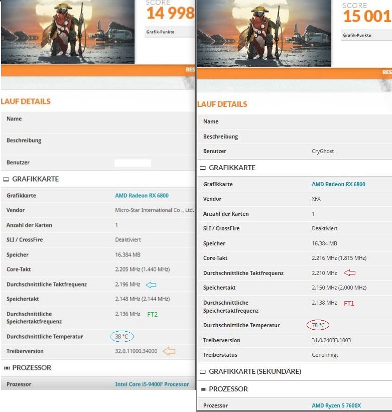

btw.

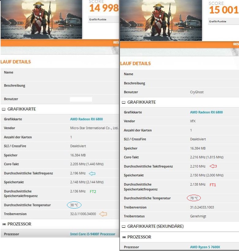

I looked at the HoF, to find a other User with my 24/7-Score, to compare FT2 vs FT1: 2148MHz vs 2150MHz
see attachment, ... he needs100MHz more avg. gpu clock, to achieve small 57points more= not efficient

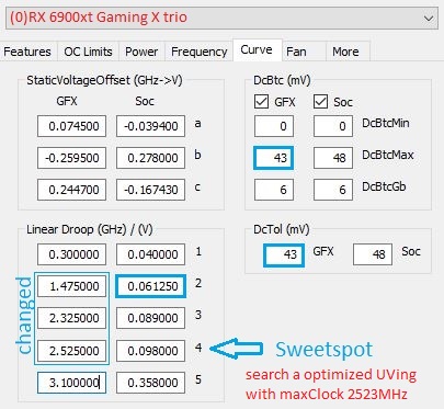

@cra3khead

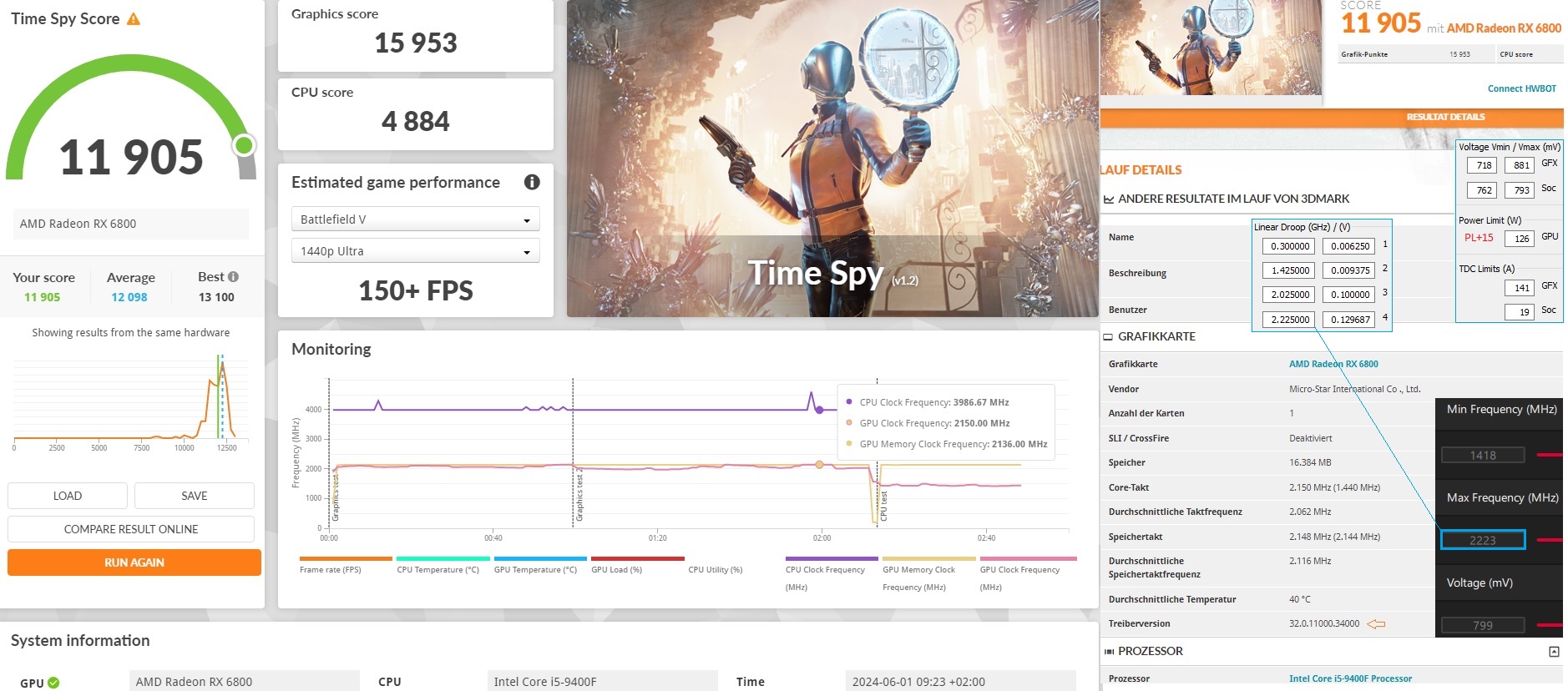

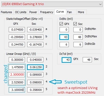

probably a other way is also possible, ... set a little change with 25MHz in LD2+3+4 ... 2500-->2525MHz
and then try to optimize the Sweetspot around 2523MHz, ... works in this way, 2200-->2223MHz@my 6800nonXT
but
the other change in the tolerance as second step, may be not soo stable
With your high temps I would take only such a lower maxClock!

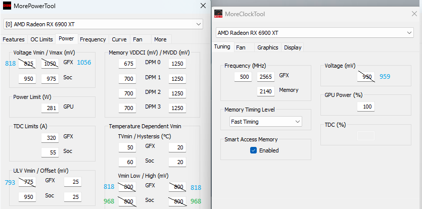

Would you be able to help me do this for 2565Mhz? I know 1050mv at 2565Mhz is damn near 100% stable on my card at the moment.
It´s not important to stay at 1050mV in MPT because 1056mV is also lower then 1050mV effectiv.
try 1056 with 2563MHz, ... may be 1056 is enough to reach more maxClock@MCT = 2568...2573MHz
(with 265W? only at some scenes of the TS the eff. maxClock >2500MHz, ...
with maxClock 2573 may be useful to change LD4 2500-->2525MHz as described #6.645)
() that would be a nice/cool goal, also 24/7 useful
I think for example, that the 6950 use the higher per part curves only if the effectiv Volt >1050.
at eff. <1050mV there are lower curves (more effizient?)

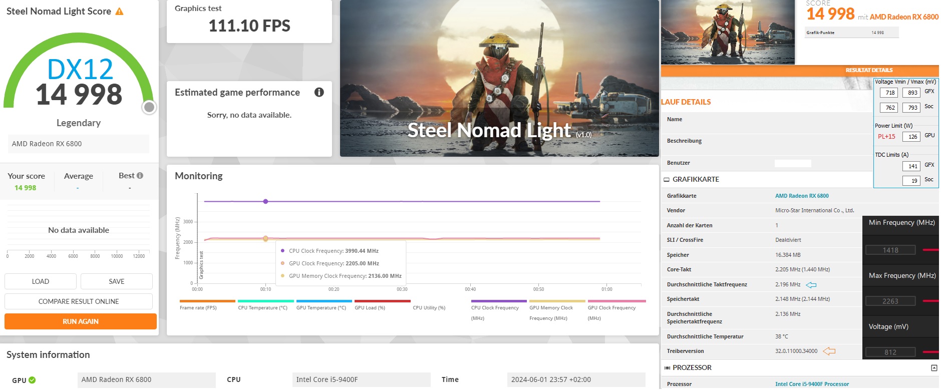

In the same manner I changed my MPT 881mV to 893mV to have fun in Nomad Light@DX12.
thats perfect with low Watts to have a great Boost, ... see attachment1
Nomad also likes a little bit FT2, compared with a other User@FT1, ... see attachment2
in real games I use only maxClock 2248

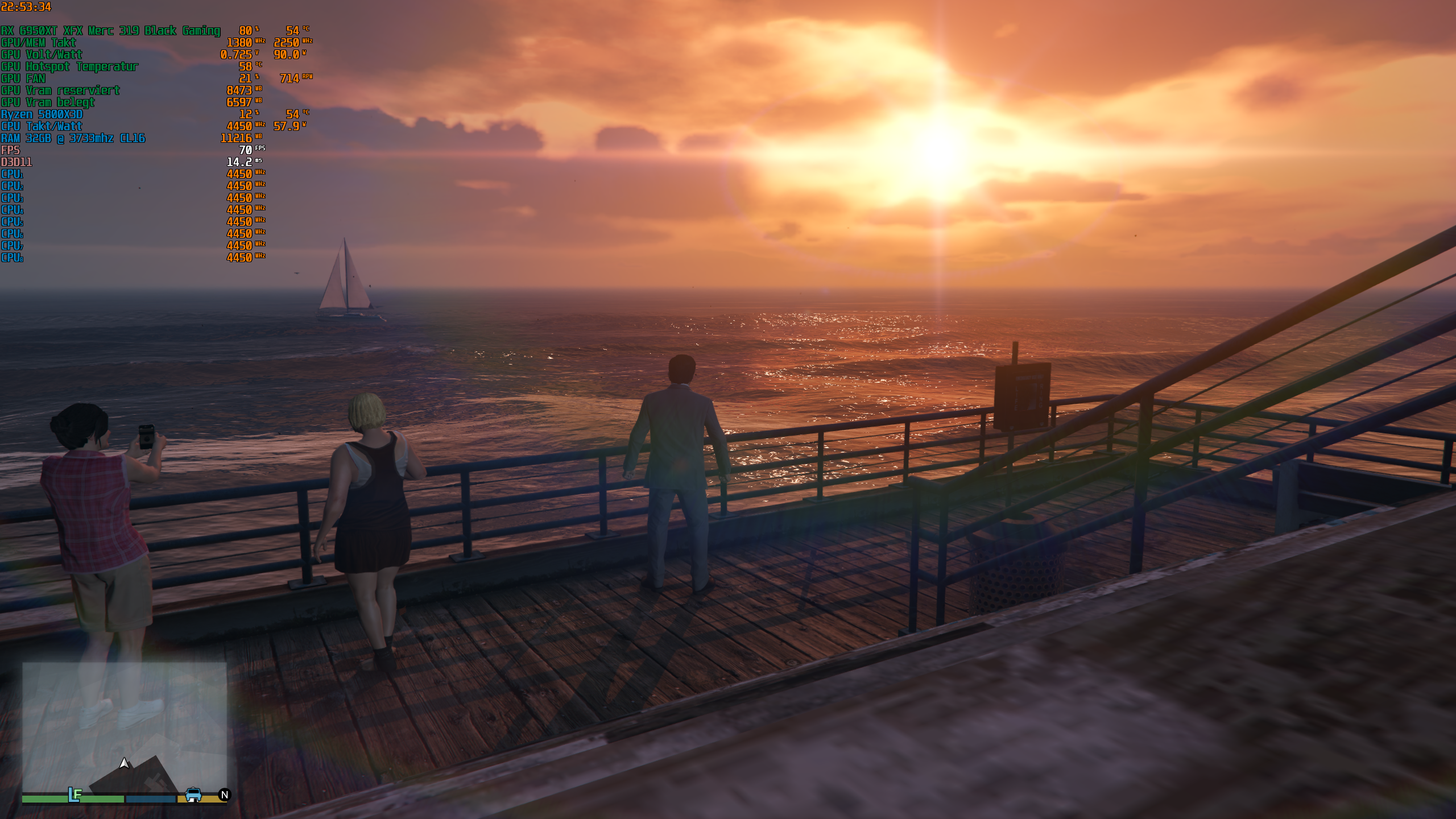

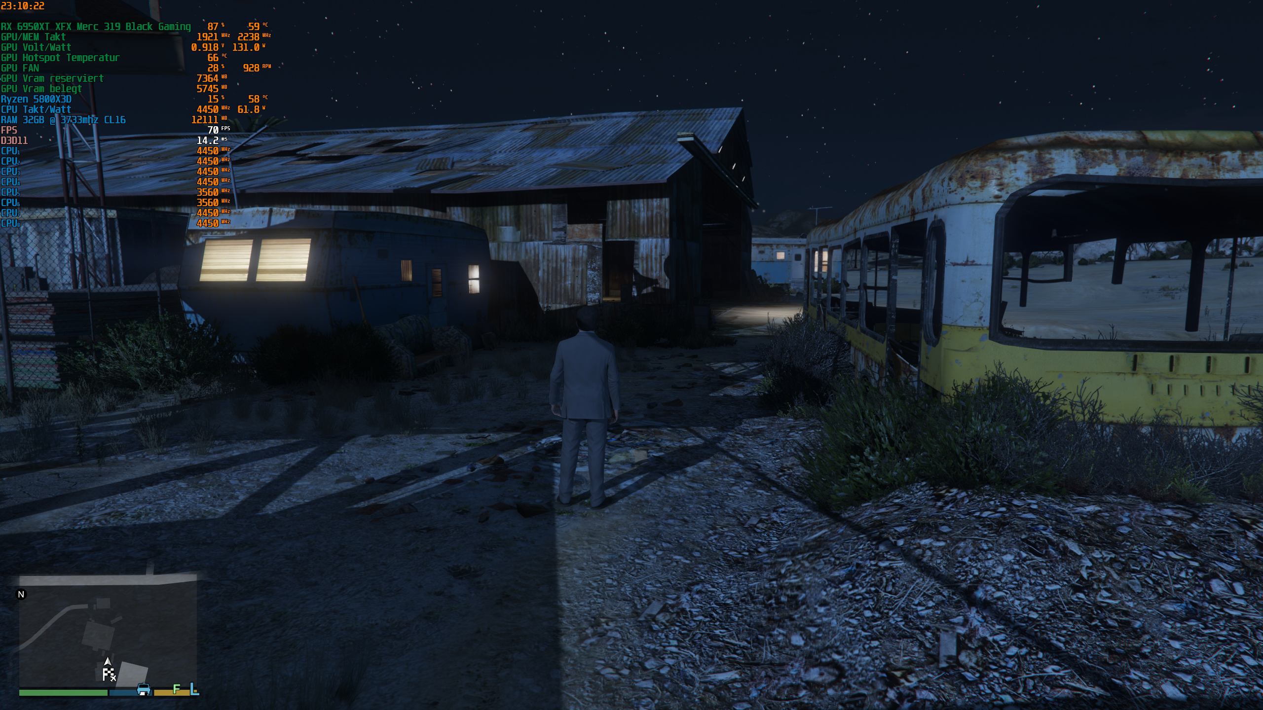

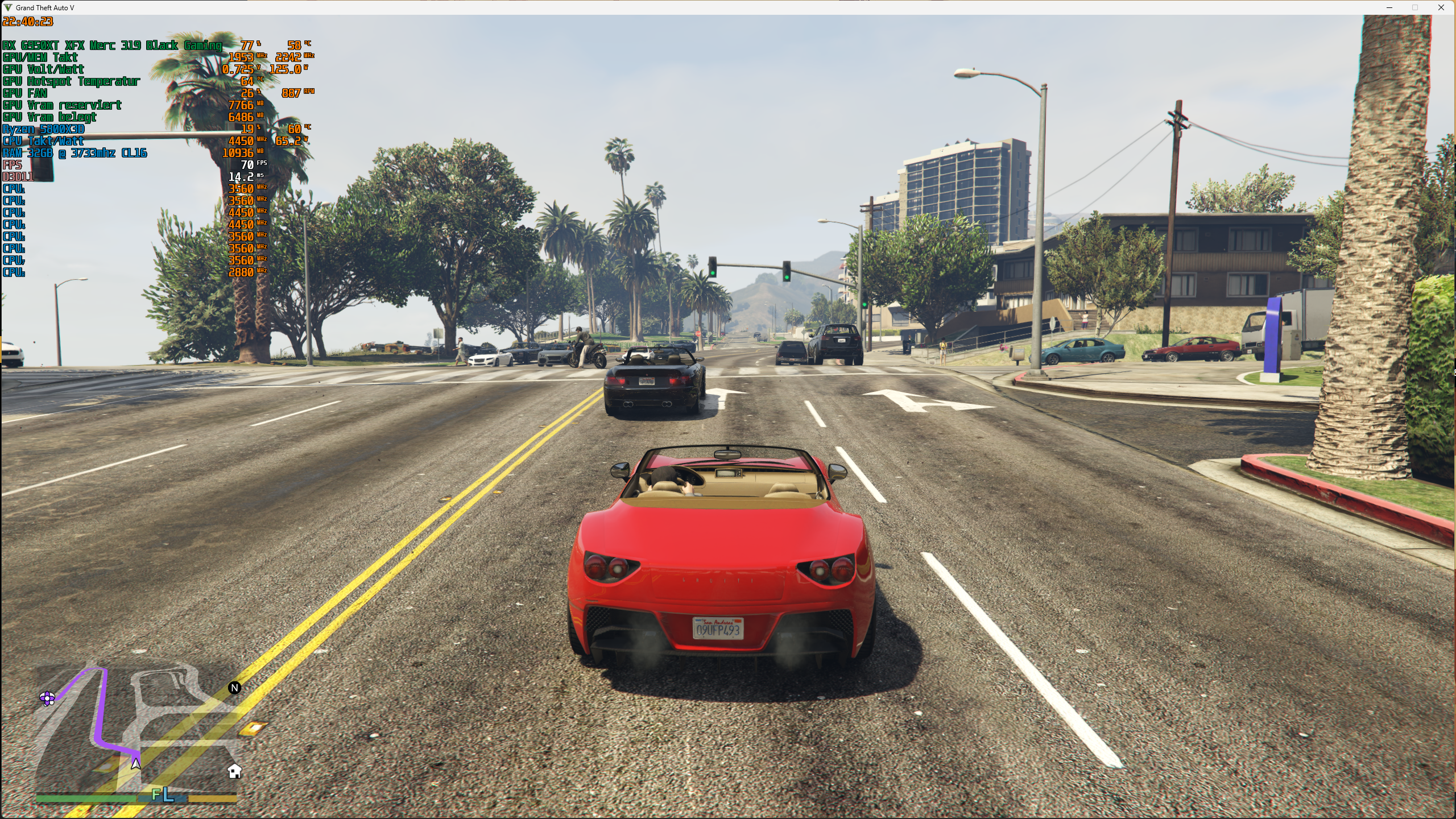

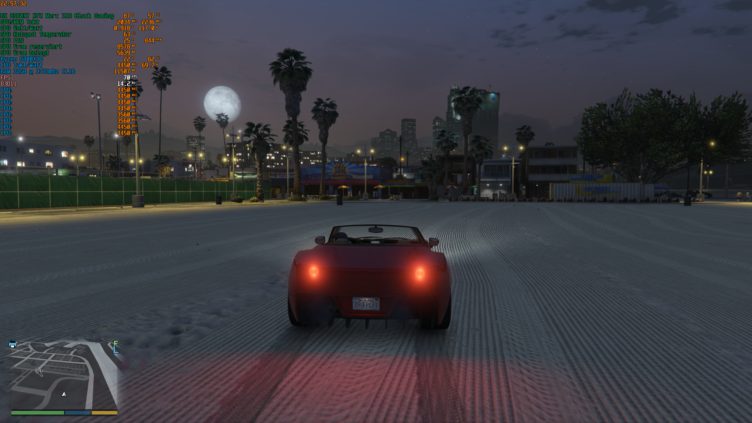

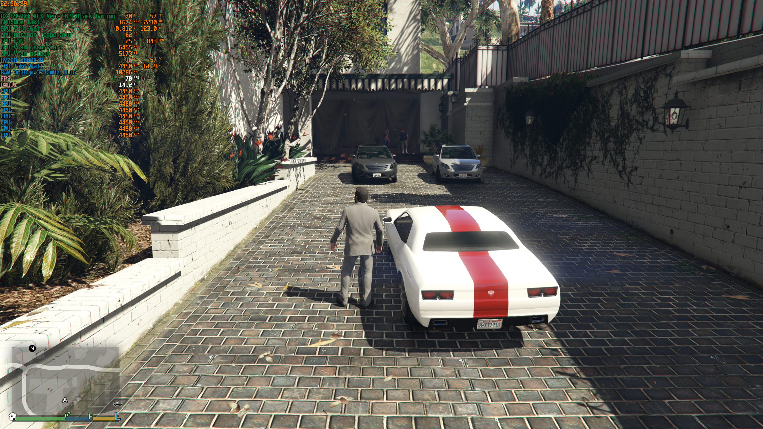

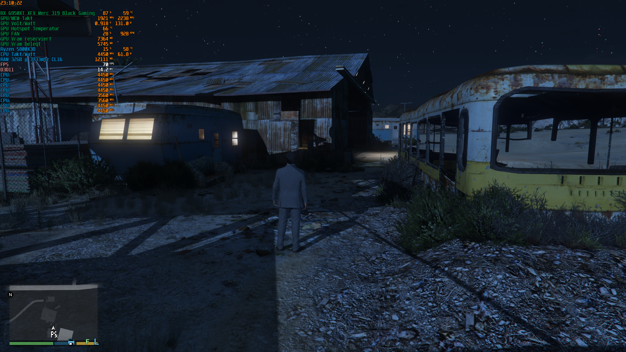

hier mal 45 min GTA5 :daumen:

my chip allows@LD4= 2,200GHz-->2,225GHz
may be your chip can do also this 25MHz (2,500-->2525)
(the reference settings should be with a little safety buffer)
Unfortunately, my card doesn't respond well to the optimized curve settings at all; it just keeps crashing no matter what voltage-fmax settings I use :(
cra3khead schrieb:
Unfortunately, my card doesn't respond well to ...
may be, LD3 must stay safe at default 2,300GHz

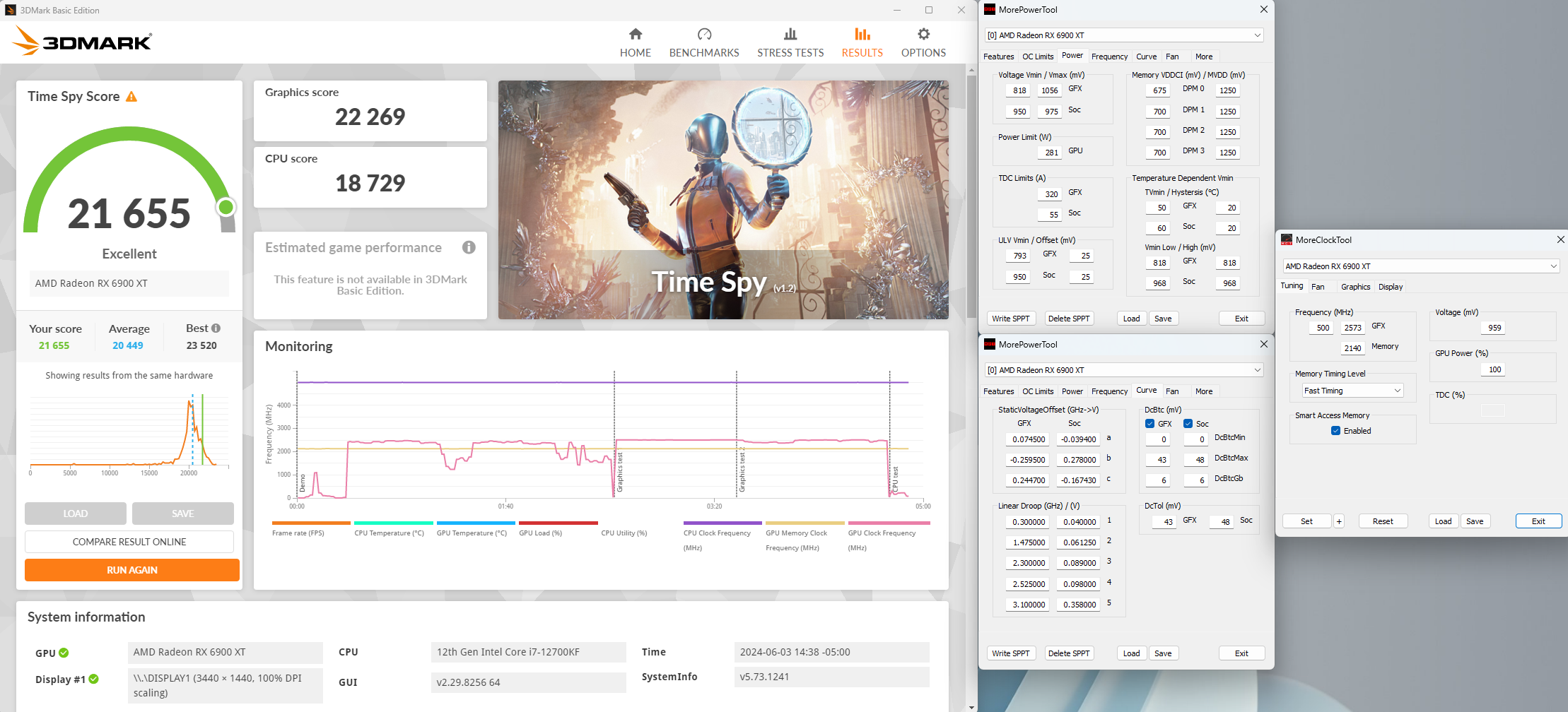

Although my score is 30 points lower than it was previously; but I don't know if it has to do with the weather since it's over 100 degrees today.
Reaktionen: GerryB

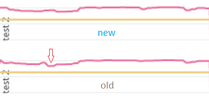

looks good, the clock dip is not soo sharp
just for fun
try a little bit less max clock:
2563 and 2558 with MCT 956...957mV
sometimes the avg. clock is then smoother
and may be <eff.2500MHz a little bit better in the efficiency

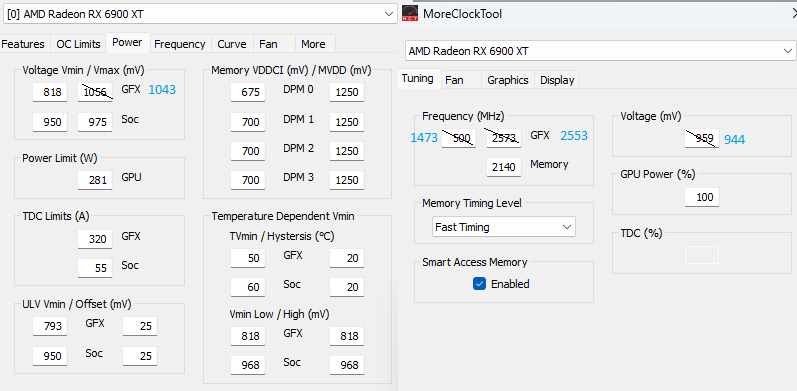

If maxClock 2553 runs with MPT 1043mV MCT 944mV, that´s would be nicer.
I think, to get 22,3k Score you need more efficiency, means higher avg.clock.

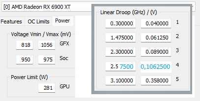

GerryB schrieb:
don´t change LD5
So does the LD4 trick only work for a 2525MHz sweet spot, so for example, if I set 2625MHz (2560MHz effective), it would be pointless because it's running above the LD4? In that case, what voltage would I need for 2585MHz, or should I just keep it at 2573? Sometimes in the game, I can see it hitting 2540MHz for a split second with the setting you provided. I personally am going to keep it that way if there's no other optimization to boost clocks further.
edit:
Try 0,1062500V with 2,550 or 2,575GHz. If not stable, then 0,101250V or 0,101875V.
I don´t know if so much change above default 2,500GHz works.
Reaktionen: cra3khead
