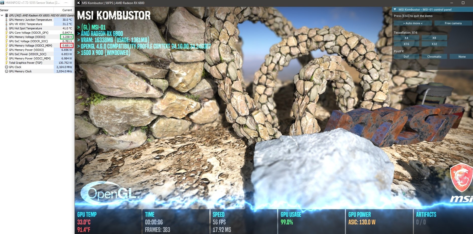

Kann es sein, das Deine hohe VDDCI von 800mV die MVDD hochdrückt?
müsste dann mit VDDCI 700...681mV niedriger werden

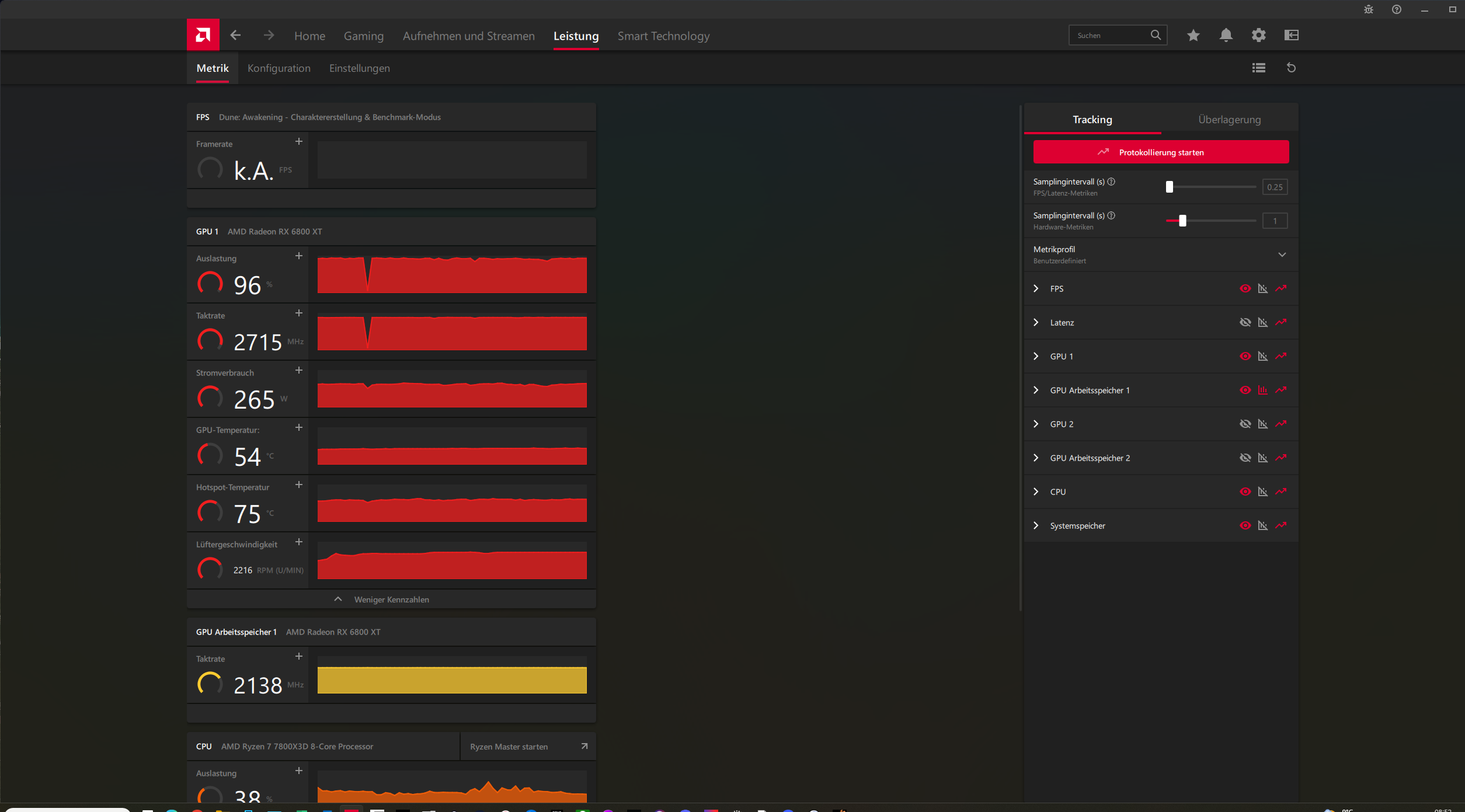

Ich hab jetzt mal den Dune Awakening Benchmark in WQHD laufen lassen. Im Screenshot der Verläufe ist der kleine "Einbruch" der erste Screesnhot, den ich gemacht habe. Ansonsten sieht man, dass es komplett stabil ohne Framedrops läuft.

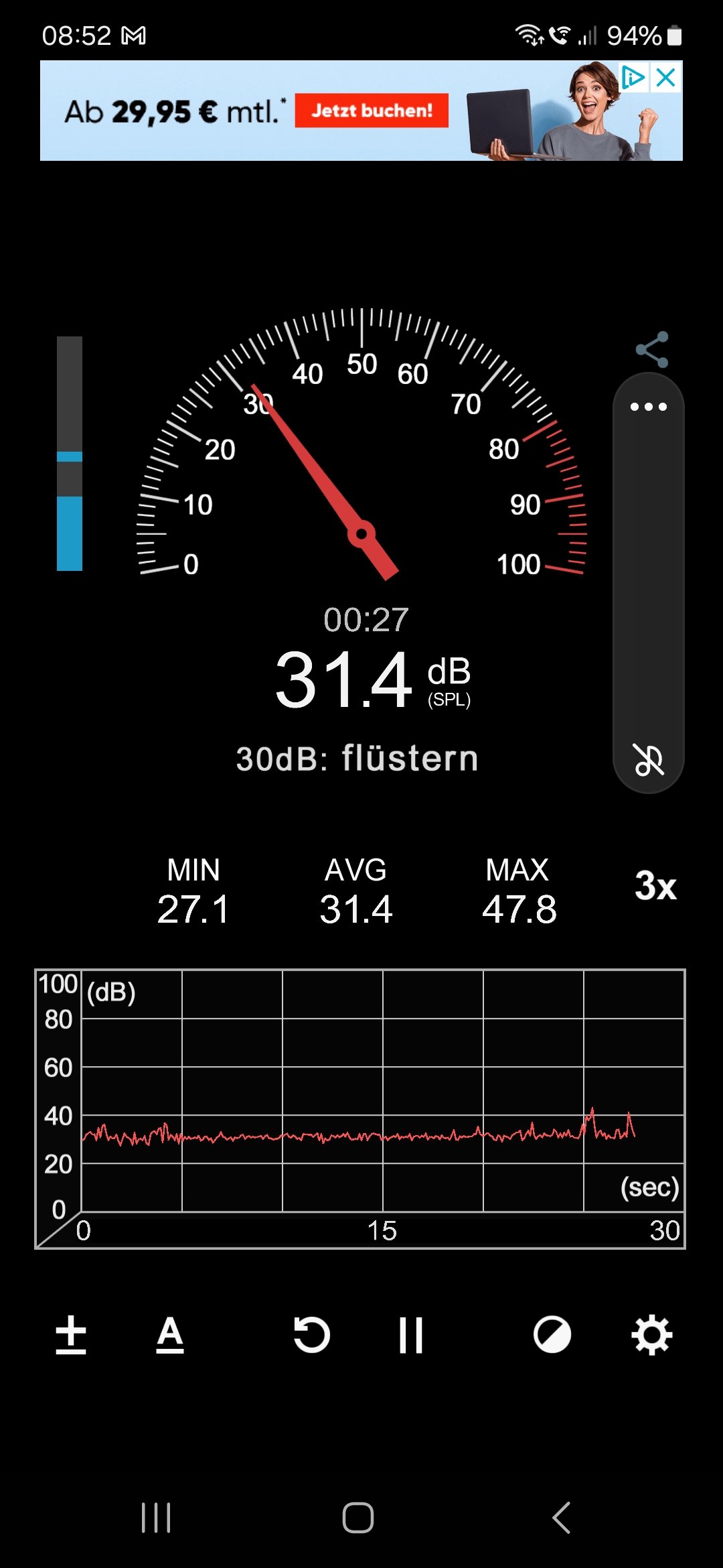

Dann habe ich mal Soundmeter (danke für den Tipp!) laufen lassen und habe das Mikrofon schräg von vorne etwa 25 - 30 cm von der Towerfront hin gehalten. Man beachte hier eher den Verlauf als den aktuellen Wert. Im Verlauf waren es etwa 34db im Mittel.

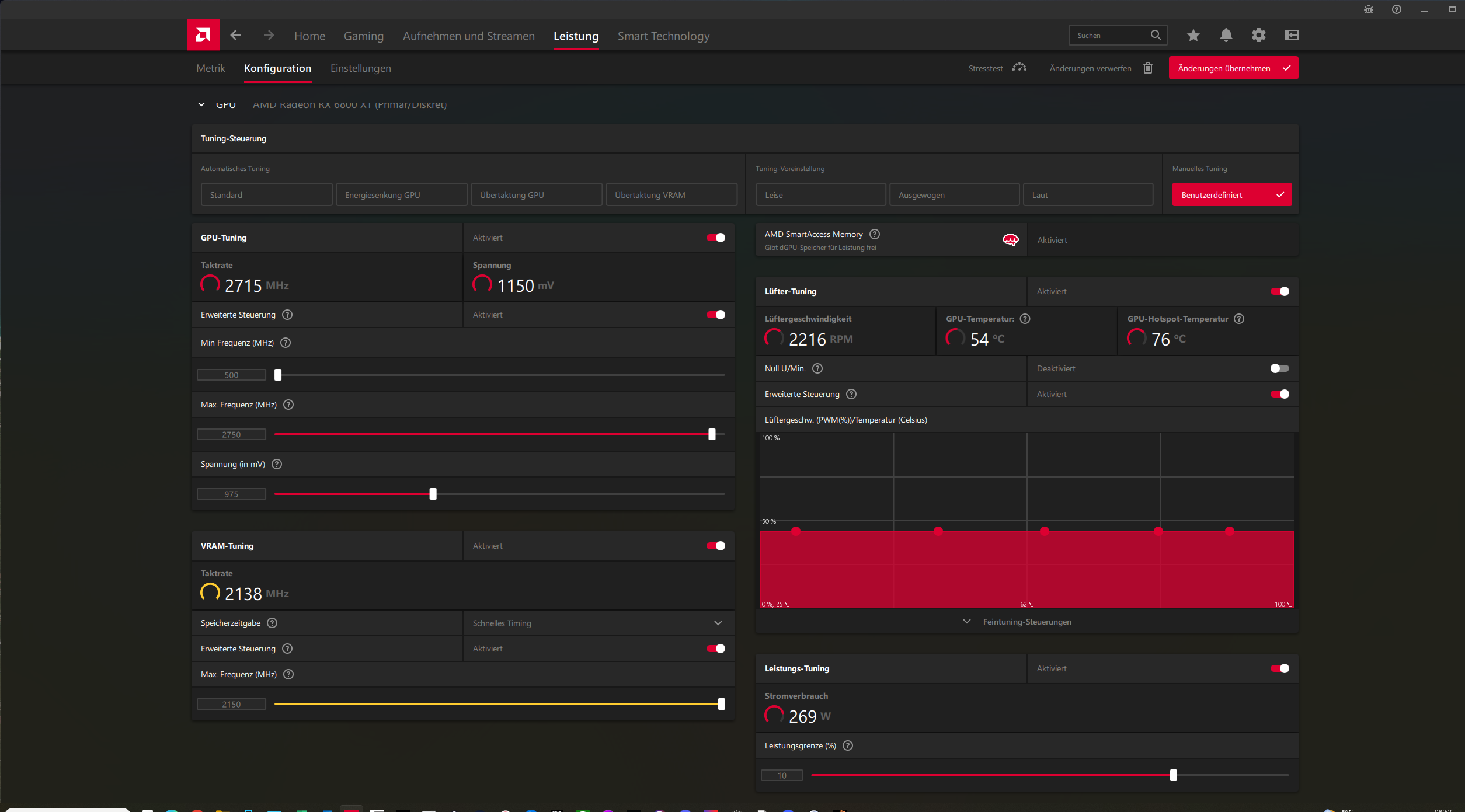

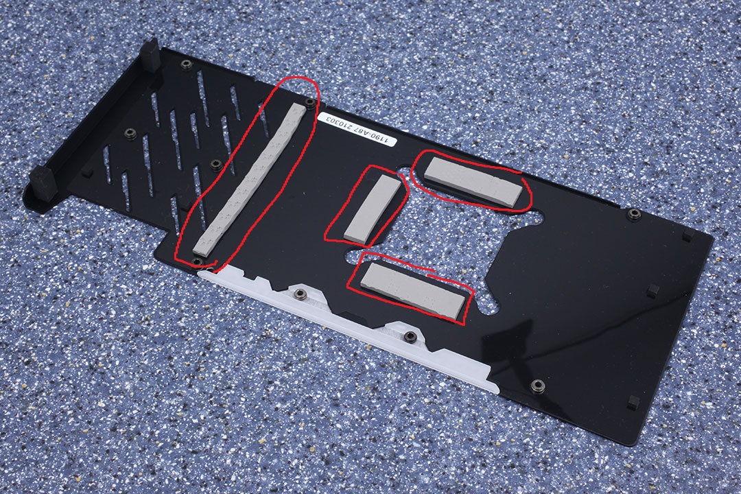

@GerryB I just ordered PTM7950, 0.35mm screw washers, and some cheap thermal putty (as a backup in case a thermal pad rips, though I’d prefer not to use it). Is there anything I should know about the Gaming Trio before I take it apart and reapply the thermal paste?
I don´t know if somewhat is special.

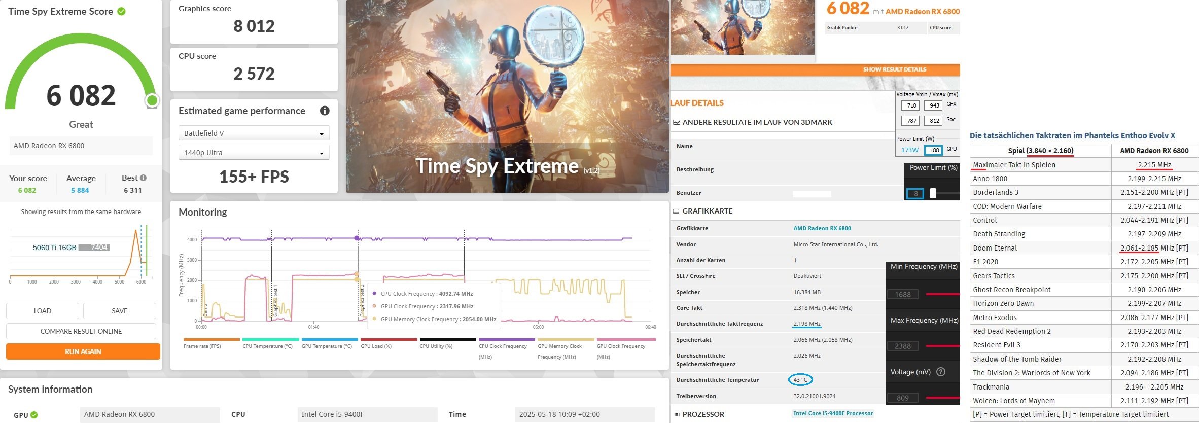

did´nt repaste my nonXT 6800 Trio, <=33% fan works good enough
(runs 24/7@UV with 30W less@TSE, see attachement, ... real gaming = mostly with lower watt requ.)
Are Pads between Vram+Backplate?
would paste some putty there
I have to at this point, the delta between the core and the hotspot is 40+ degrees. I think it's going to shorten the lifespan of the card. I have to make it last until RDNA 5/UDNA, since the 9070 XT isn't much better than the 6900 XT, in my opinion.
Should I apply extra thermal putty to other areas of the backplate? I'm just being cautious since this is my first time repasting a GPU, and I want to make sure I understand everything beforehand to avoid breaking anything.
