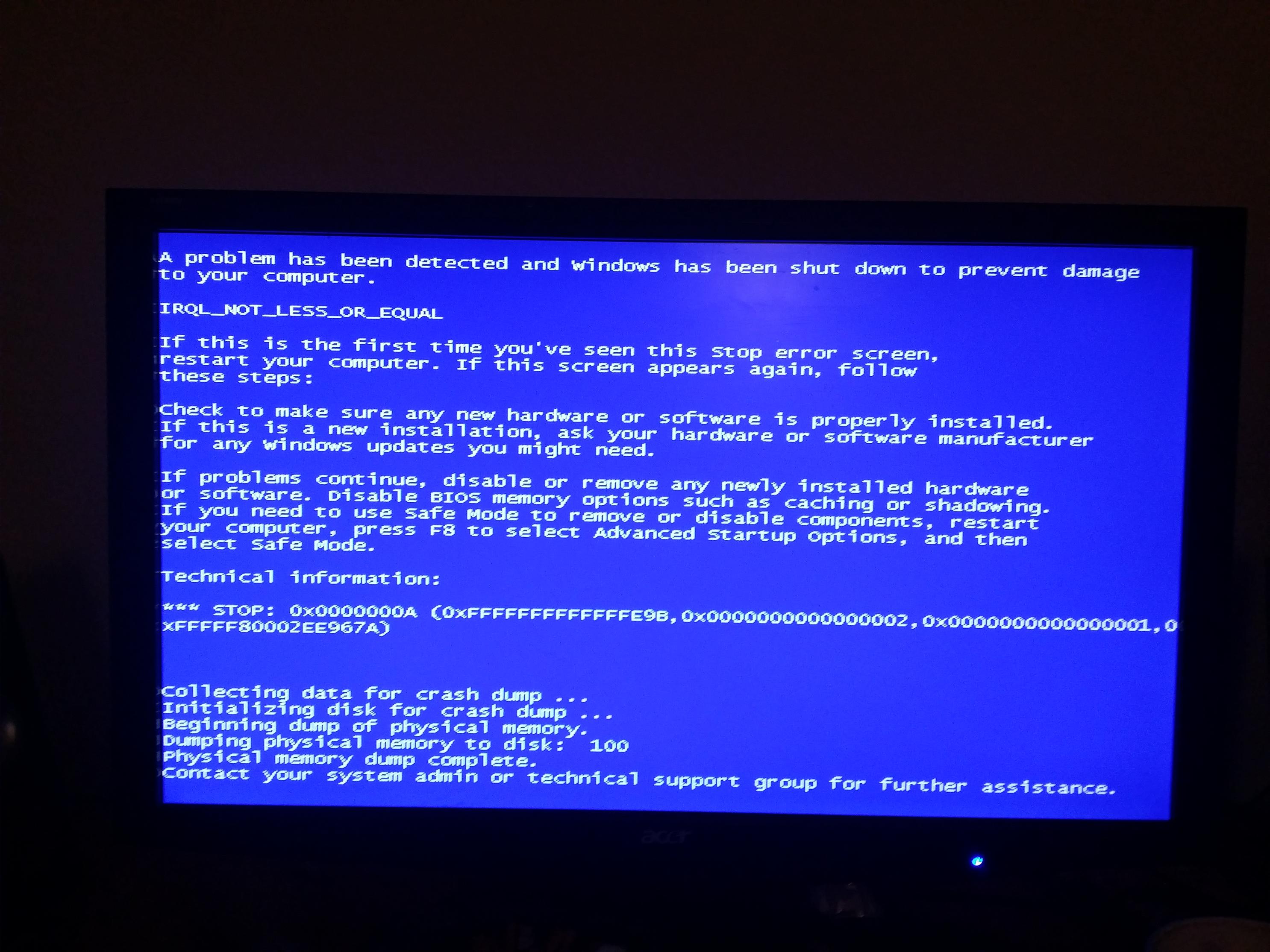

Welchen Bluescreen bekommst du?

fehler hab ich mehrere
Installation Failure: Windows failed to install the following update with error 0x800705b4: Security Update for Windows 7 for x64-based Systems (KB2978668).
Installation Failure: Windows failed to install the following update with error 0x800705b4: Update for Windows 7 for x64-based Systems (KB2852386).
The computer has rebooted from a bugcheck. The bugcheck was: 0x00000101 (0x0000000000000019, 0x0000000000000000, 0xfffff880009b3180, 0x0000000000000004). A dump was saved in: C:\Windows\MEMORY.DMP. Report Id: .
