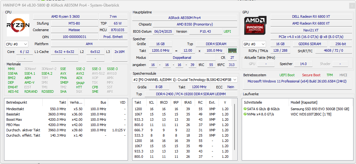

  • Prozessor (CPU): AMD Ryzen 5 3600
  • Arbeitsspeicher (RAM): 2x DDR4 PC2400 Crucial 8GB Ballistix Sport LT CL16
  • Mainboard: ASRock AB350M Pro4, BIOS Version 7.40
  • Netzteil: bequiet! Pure Power 10, Model L10-500W
  • Gehäuse: bequiet!
  • Grafikkarte: Radeon RX 6800 XT
  • HDD / SSD: WD Blue SN550 1TB (NVMe), Samsung EVO SSD 500 GB (SATA III)

Code:
Schwerwiegender Hardwarefehler.
Gemeldet von Komponente: Prozessorkern
Fehlerquelle: Machine Check Exception
Fehlertyp: Cache Hierarchy Error
Prozessor-APIC-ID: 13
Die Detailansicht dieses Eintrags beinhaltet weitere Informationen.
 System
  - Provider
   [ Name]  Microsoft-Windows-WHEA-Logger
   [ Guid]  {c26c4f3c-3f66-4e99-8f8a-39405cfed220}
   EventID 18
   Version 0
   Level 2
   Task 0
   Opcode 0
   Keywords 0x8000000000000000
  - TimeCreated
   [ SystemTime]  2025-09-20T17:02:22.2408396Z
   EventRecordID 2174
  - Correlation
   [ ActivityID]  {4f47c6ea-5185-495a-92d6-162276e5a068}
  - Execution
   [ ProcessID]  4404
   [ ThreadID]  5444
   Channel System
   Computer Desktop
  - Security
   [ UserID]  S-1-5-19
- EventData
  ErrorSource 3
  ApicId 13
  MCABank 5
  MciStat 0xbea0000000000108
  MciAddr 0x1f80487282e0a
  MciMisc 0xd0130fff00000000
  ErrorType 9
  TransactionType 2
  Participation 256
  RequestType 0
  MemorIO 256
  MemHierarchyLvl 0
  Timeout 256
  OperationType 256
  Channel 256
  Length 2063
  RawData 435045521002FFFFFFFF040001000000020000000F08000011021100140919140000000000000000000000000000000000000000000000000000000000000000BDC407CF89B7184EB3C41F732CB57131FE6FF5E89C91C54CBA8865ABE14913BBD7647C51502ADC01020000000000000000000000000000000000000000000000A0010000C00000000003000001000000ADCC7698B447DB4BB65E16F193C4F3DB0000000000000000000000000000000001000000000000000000000000000000000000000000000060020000E00000000003000000000000B0A03EDC44A19747B95B53FA242B6E1D0000000000000000000000000000000001000000000000000000000000000000000000000000000040030000A80400000003000000000000011D1E8AF94257459C33565E5CC3F7E800000000000000000000000000000000010000000000000000000000000000000000000000000000E8070000270000000003000000000000A13248C3C302524CA9F19F1D5D7723FC000000000000000000000000000000000300000000000000000000000000000000000000000000007F010000000000000002010000000000100F87000000000000000000000000000000000000000000000000000000000000000000000000000000000000000000000000000000000000000000000000000000000000000000000000000000000000000000000000000000000000000000000000000000000000000000000000000000000000000000000000000000000000000000000000000D00000000000000000000000000000000000000000000000000000000000000000000000000000007010000000000000D00000000000000100F870000080C0D0B32F87EFFFB8B170000000000000000000000000000000000000000000000000000000000000000F50157A5EFE3DE43AC72249B573FAD2C03000000000000009F000206000000000A2E288704F801000000000000000000000000000000000000000000000000000000000000000000000000000000000000000000000000000000000000000000000000000000000000000000000000000000000000000000000000000000000001000800800100000000000000000000000000000000000000000000000000000400000002000000D6F83B52502ADC010B0000000000000000000000000000000000000005000000080100000000A0BE0A2E288704F8010000000000FF0F13D00A0000000D00000000000000B00005000000004D0000000079000000030000000000000000000000000000000000000000000000000000000000000000000000000000000000000000000000000000001B00000000000000000000000000000000000000000000000000000000000000000000000000000000000000000000000000000000000000000000000000000000000000000000000000000000000000000000000000000000000000000000000000000000000000000000000000000000000000000000000000000000000000000000000000000000000000000000000000000000000000000000000000000000000000000000000000000000000000000000000000000000000000000000000000000000000000000000000000000000000000000000000000000000000000000000000000000000000000000000000000000000000000000000000000000000000000000000000000000000000000000000000000000000000000000000000000000000000000000000000000000000000000000000000000000000000000000000000000000000000000000000000000000000000000000000000000000000000000000000000000000000000000000000000000000000000000000000000000000000000000000000000000000000000000000000000000000000000000000000000000000000000000000000000000000000000000000000000000000000000000000000000000000000000000000000000000000000000000000000000000000000000000000000000000000000000000000000000000000000000000000000000000000000000000000000000000000000000000000000000000000000000000000000000000000000000000000000000000000000000000000000000000000000000000000000000000000000000000000000000000000000000000000000000000000000000000000000000000000000000000000000000000000000000000000000000000000000000000000000000000000000000000000000000000000000000000000000000000000000000000000000000000000000000000000000000000000000000000000000000000000000000000000000000000000000000000000000000000000000000000000000000000000000000000000000000000000000000000000000000000000000000000000000000000000000000000000000000000000000000000000000000000000000000000000000000000000000000000000000000000000000000000000000000000000000000000000000000000000000000000000000000000000000000000000000000000000000000000000000000000000000000000000000000000000000000000000000000000000000000000000000000000000000000000000000000000000000000000000000000000000000000000000000000000000000000000000000000000000000000000000000000000000000000000000000000000000000000000000000000000000000000000000000000000000000000000000000000000000000010000000000000000000000FF00000000000000000000000000000000000000000000000000
