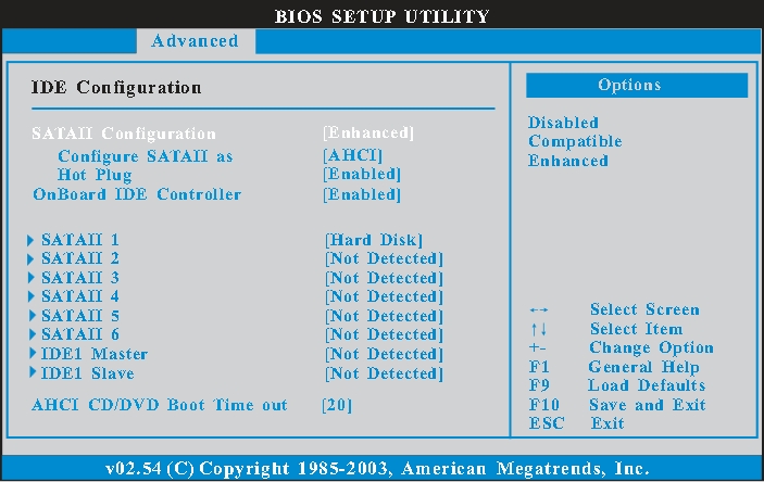

Hallo Danielowitch,
die Einstellungen im BIOS sollten so aussehen (gem. Handbuch S.51):
3.3.4
IDE Configuration
SATAII Configuration
Please select [Compatible] when you install legacy OS. If native OS (Windows2000 / XP) is installed, please select [Enhanced].
Then in the option “Configure SATAII as”, you are allowed to select [AHCI] or [IDE]. The default value is [AHCI].
If you select [AHCI], the option “Hot Plug” will appear. You are allowed to use the Hot Plug function under Windows environment if this option is enabled.
Configuration options: [Enabled] and [Disabled]
Testweise mal "Onboard IDE Controller => Disabled"
Oder generell mal die Default-Werte des BIOS laden,- vielleicht hat sich auch irgend etwas verstellt.
